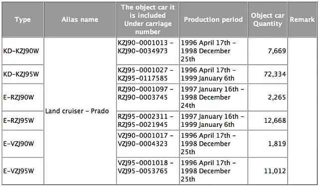

For those not familiar with the rear axle shaft recall issued earlier this year, I found this official communication from Toyota were exact vehicle IDs are specified:
http://toyota.jp/recall/2006/0516.html
(go to http://babelfish.altavista.com for a quick translation)
"...a crack may occur in the Prado's rear axle shaft if it is repeatedly driven on winding roads in the mountains at a high speed, it said, warning that a wheel may come off in the worst case."
I know for a fact that Australian Toyota Dealerships have been very responsive about this recall. Hope this thread helps those who were not aware.

Thanks for the information about the recall. The chassis number of my car is listed in the table you posted.
Next week I'll see if the Toyota dealer here has something to say about it.
Pablo

Pablo,
Toyota Chile claims that they have not been informed of this recall, however I've forwarded the links and all information to their customer service department and will insist until we get a satisfactory answer.

Toyota Chile got back to me. They say that the Prados they imported are RZJ90L and the recall applies to RZJ90W models. The weird thing is that the person I spoke to claims that W stands for Japanese Domestic Market (which makes me doubt him) We all know that the L stands for Left hand drive, and this recall applied to many countries.
For the record: I 'm still not convinced.
