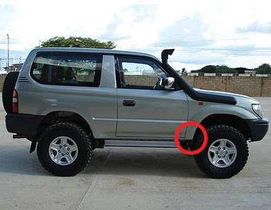

Quote:
Originally Posted by -MaTTi- View Post
How about wheel openings/room for tires? If 285/75R16 will fit to 3rd gen. 4Runner with some suspension/body lift mods, will they fit to 90 serie Land Cruiser with the same mods? Original tires are optionally the same 265/70R16.
I compared the two, and the 90 series has considerably less fender clearance on the front wheel compared to the 4runner.
Look at the photo attached. You can easily tell that this vehicle will have mayor rubbing when wheeling.

Quote:
Quite dark point this circulated... Do you have bigger/different pictures of the same car? Are those 285/75R16?

Old 01-20-07, 04:59 PM   #29
IH8MUD Junior
dhula's Avatar
Join Date: Oct 2006
Posts: 99
that gap may be able to be made bigger with a good alignment specialist.
Duno how much bigger, but it may work

the 4Runner has rubbing issues there as well. I rub like crazy with 295's and suspension lift and 1" body lift. It will pop the fender flair off if I am not careful.
