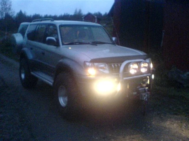

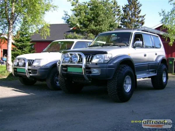

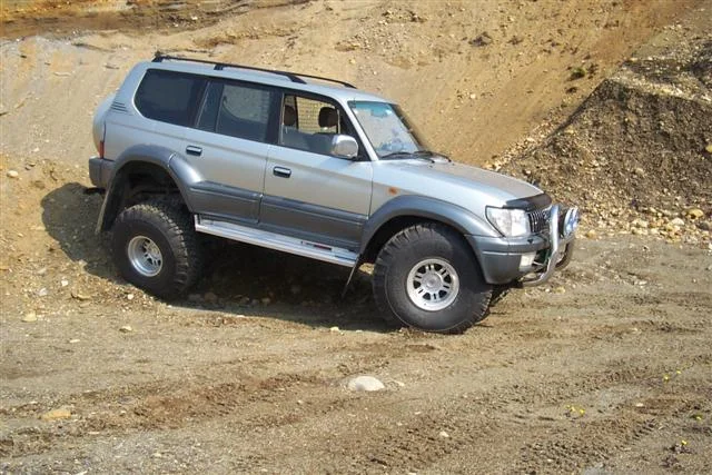

This is my Lancruiser 90 vx...On 38x15,5 snow tires
On 15x12,5 rims.
I got an Come up winsj, just an smal one for self recovery.(2700t)
Here is some picks...

Some specks...To make the tires fit, the back axle is moved back about 12,5 cm
And the same is done to the chassie brackets in front(my English sucks)
The body are lifted 8cm and the springs 4cm.
brake disks are "cutted"..turned?? down to make place for 15'' rims, and the brake calipter are modified...The reason why I want so small rims innstead for 16'' or 17'' is to make the tire to weld out properly...
*please point out my wrong spelling so I can learn this*....lol
Regards Morten Holm

A pick from a small lc meet...(for young an younger)

Long time, no web on me...Sry! By the way, here is a pic of my car and my fathers orginal prado...
