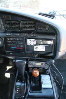

Console pictures. Obviously you can see why a new console design is on my list. Too much stuff!

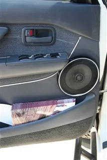

Driver's side kick panel with fuse box and foot actuated Aux. light switch. 1 click is driving lights, 2 clicks is rock lights. Dead pedal was removed for more leg room.
Even the little guy's seat has the 80 script on it.
Infinity Reference speakers: Although they may not be audiophile quality they suit this Cruiser very well and the grills look nice in the door panels. To me audiophile speakers in a Cruiser are a waste of money. Mine have been covered in snow and mud more than once and with tires, exhaust, etc... it isn't really an audiophile environment.

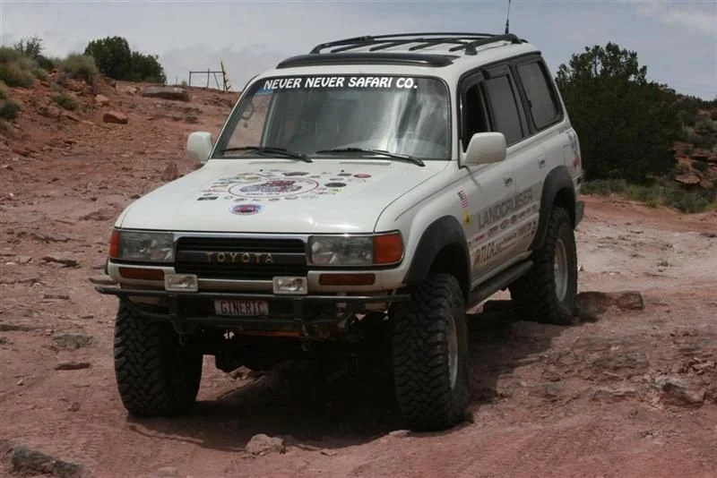

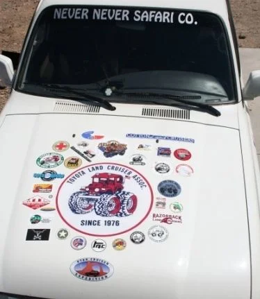

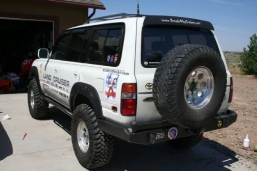

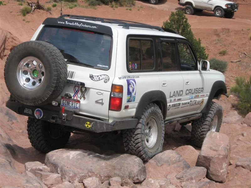

The Exterior:
TLCA 30th Anniversary hood, still missing a lot of chapters

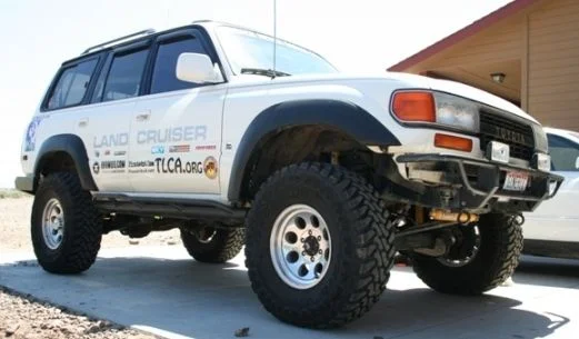

DS rear view, home built rear bumper
PS front view, Metal Tech Sliders, MT Classic 2 wheels, Toyo MTs

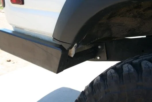

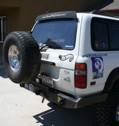

Rear bumper side mount: 1/4" plate, 3/8" bolts with clip nuts installed through factory plug into new holes drilled into the frame.

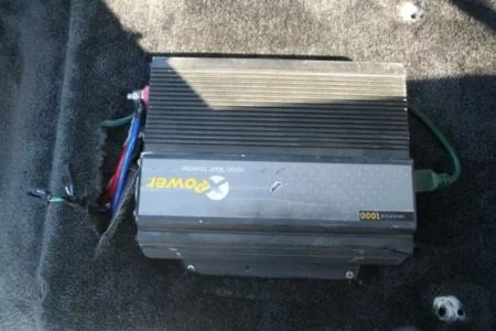

Power invertor: under DS front seat
Rear bumper and Swingout: 3x6" rectangular tubing, notched to go over the frame, center crossmember partially removed, the remaining has two 1/4" flat plates with holes drilled in them to act as another mounting point, 5/8" plate steel used for recovery points welded to the bumper and bolted to the frame.
