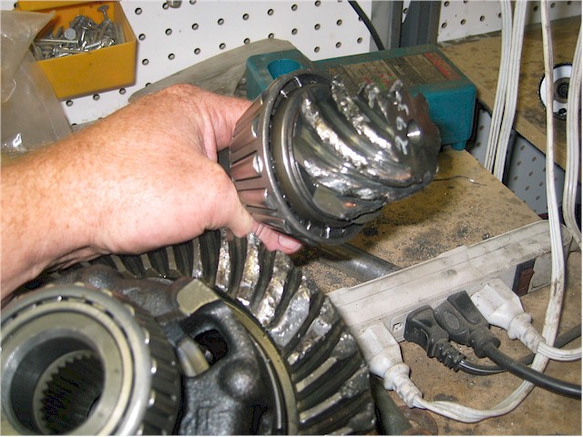

Does anyone have any facts behind the heating/freezing techniques that Bobby Longfield can do on a ring and pinion set? How much stronger does it make them? Has anyone broken teeth on one of his treated gears yet? Or should I look at getting a particular brand that is manufactured stronger than Yukon? Here's what happened to my front end on Billings Canyon. When I heard the grinding I told myself...there goes one of my chromoly birfs I was dead wrong when I pulled my axles and saw them in perfect condition. My new weak link is my 5.29 ring/pinion. Finally I am getting around to replacing them and would like to get everyone's opinions on what to replace them with. And YES I'm sticking with 5.29's I know they are weaker but I need em.

Just ordered my gears. They are drop shipping to Bobby's and he will do his magic on them. Talked to Randy's Ring and Pinion and they say treated gear sets are usually 30% stronger. This time around Bobby said to set them up a lot tighter than normal. He said around 2 would be ideal instead of 6-10. I'll let you know how they hold up to my abuse.

That one of the keys to making diff gears last under extreme beating. Make sure you have plenty of preload on the carrier bearings, carrier deflection is one of the prime causes of teeth shearing. Have you read Zuk's thoughts on it? http://www.gearinstalls.com/ He has set some up for locals that beat them extremely hard with as much as 110 ft/lbs of preload on the carrier bearings with good results! I don't want 110 ft/lbs for my DD, but will have plenty to keep the carrier from moving around.

Excellent resource. Looks like this guy knows his stuff very well. It could have been I had my preload not tight enough from what he talks about here:
http://www.gearinstalls.com/freshen.htm
Here is exactly what I will be doing next week. This is an article on the correct gear installation for the FJ80 front elocker with 5.29's that have been cryo'd Perfect!
http://www.gearinstalls.com/elocker229.htm
