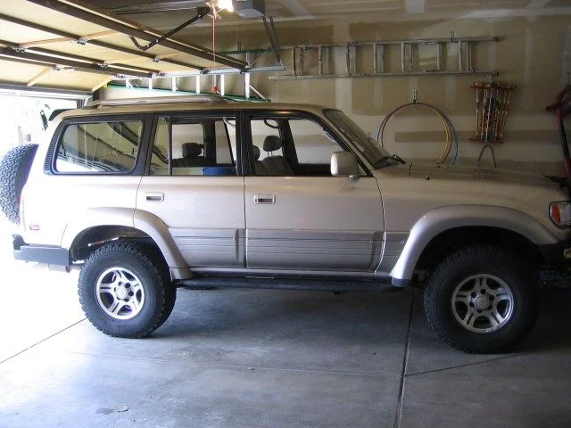

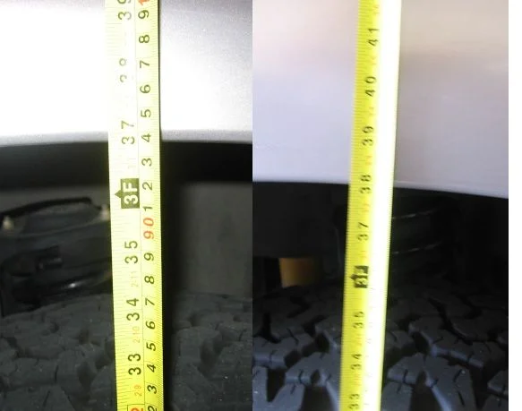

I originally installed a 2.5" medium OME lift after I bought my truck. I had selected the medium based on the fact I had no accessories to weigh it down. After I added the front ARB Bar and winch, I added a 1" Mr. Gasket to compensate.
I noticed running the same trails at Moab this year, that my front and rear dragged a lot more than it did last year. That's because I added the winch and Slee Rear bumper since then.
I also am in the process of adding a dual battery system which will add more weight on the front.
My goal was to get back to, or slightly above were I was with the unloaded truck. That way, I would not have to worry about modifying the castor correction. Also, that way, I only had to change the springs, read that as cheap and easy.
I swapped them last night and thought I would share the results for those of you who are contemplating a similar change.
The first picture is the front wheel well. Removed OME851 and 1" Mr. Gaskets and installed the OME850J's. Notice about an inch of lift which puts me right were I wanted to be.
The second picture is at the Hitch (Slee Bumper) and there would appear to be slightly more than an inch of height difference. This is removing the OME860's and replacing them with OME863's.

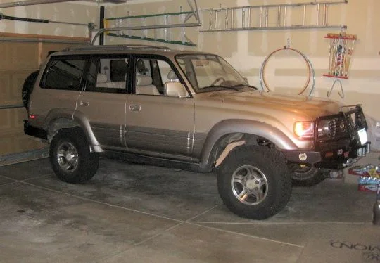

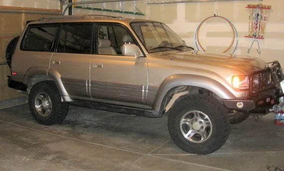

Canit Really tell much of a difference from 10 feet away.
Drove fine with no issues as well. Now I just have to wait 11 months for Moab 2007

How about a whole truck pic from the side. Is it level, vibes? How is it handling with the new springs?

Quote:
Handles great. Don't notice any difference from a handling perspective. Sits pretty close to level with the back end slightly higher. Thats just what I wanted so when it get's loaded up, it won't be ass down.

That is interesting Ken. Your rear bumper height is about 1 1/4 inches below mine (with 864's) exactly the change I measured when I went from 863 to 864. The OME springs are very consistant. We have the same height tires and my front flare measures the same as yours WITH a Mr Gasket packer on top of my 850J's. What measurement do you have in between the end of the front spring bumper and the spot it contacts on the axle housing? Was that measurement taken after you added the second battery?

Quote:
It was with the Dual batteries installed.
From the bottom of the rubber cone to the top of the bottom plate there is 5"

Hmmm - just for the heck of it I measured the front of my truck - 38.75 inches in the front with 850's and 30MM poly spacers. Tires are 285 Revo's - tall tire. My 2.5 inch lift + 30MM is taller than a 4 inch lift? What size tires are you running?

So, I never took baseline measurements, I am guessing my new lift is about 3 inches. Anyone have data that would help me figure that.
Trying to figure how close I am to needing L shocks. Opinions?

Quote:
Measure hub center to flare edge, stock is about 19.5".
just measured 22 5/8", looks like a 3" lift- Also 38" to the floor.. 850J, 33" Trxus, ARB, M12, Dual batts, snackster cooker. (863 rear)
