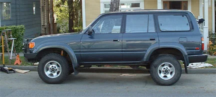

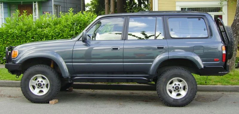

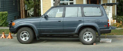

Originally Posted by nakman
just measured 22 5/8", looks like a 3" lift- Also 38" to the floor.. 850J, 33" Trxus, ARB, M12, Dual batts, snackster cooker. (863 rear)
ok got the new used 850J/863 coils on today. quite a surprise was awaiting me when I went to figure out how my new 863s were giving me 2 full inches of lift over the 860s that were on there.
rears are 39 3/8" ground to flare (24" centre hub to flare)
fronts are 37 5/8" ground to floor (23" centre hub to flare)
it turns out I now have Js front and rear . The mudmember who sold me 863s shipped me an 863 box but when i scraped the roadgunk off the "A" "B" stickers the coils were 863J. So I'm rolling on Js now I guess sure glad i ordered a longer rear brake line.
here are some shots showing progression from stock to 851/860 to 850j/863J. first two shots are on 265 Ats, last one is 285s. I am missing a shot of the truck with the medium lift on the current build (285 ATs, arb, warn 10k, hanna sliders, 4x4 lab bumper, rear seats in)

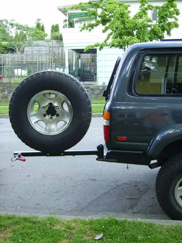

Also I can't resist this stat. The current clearance to the very bottom of my 4x4labs bumper at centre is 24"
