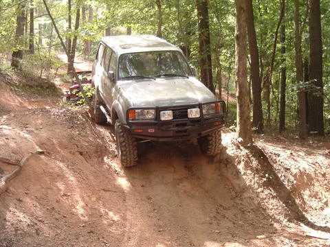

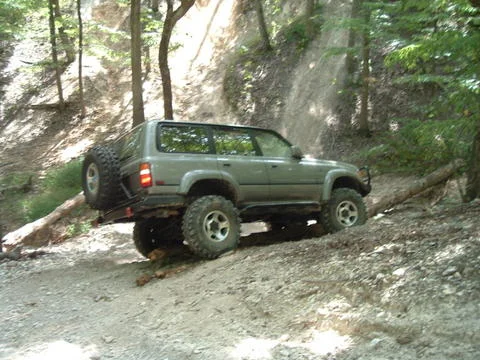

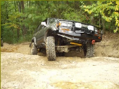

Here are a few action pics. Let me know if you want pics of anything specific. All of these pics were before I removed my flares. I plan to take some new shots tomorrow of the 80 park next to the 100 for size comparison.
