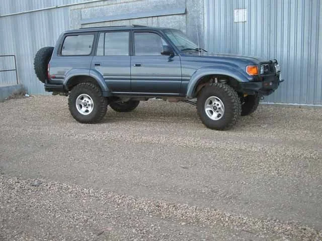

Old 04-09-06, 01:17 PM   #2 (permalink)
fatherofdaughterofromer
Romer's Avatar
Join Date: Sep 2003
Location: Englewood, Colorado
TLCA# 13968
Posts: 7,893
Garage
EditL I have since upgraded the below lift and here is a link describing:
http://forum.ih8mud.com/showthread.php?t=94950

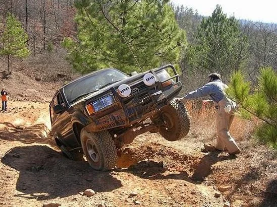

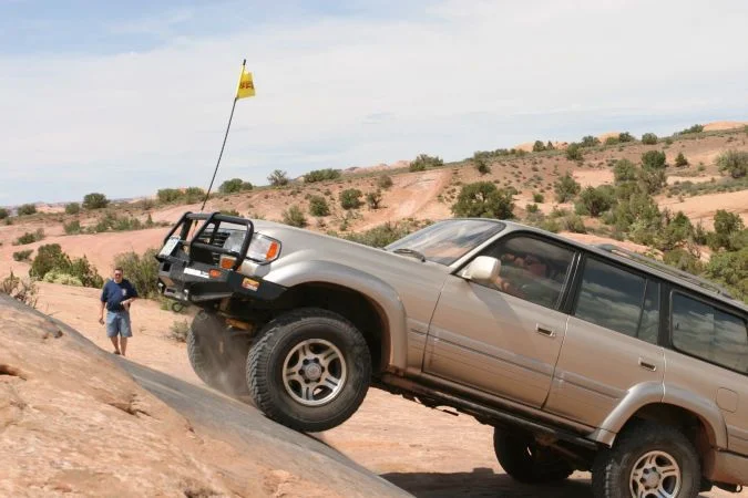

1. What lift Kit / components did you use? Include Spacers.
I selected the 2.5” OME Medium Lift kit.
Kit Included and was installed at Slee offroad:
2 x OME 851 Front Coil Springs
2 x OME 860 Rear Coil Springs
2 x N73 Nitrocharger Shocks
2 x N74E Nitrocharger Shocks
1 x SD24 Steering Damper
1 x CA77B Caster Kit
1 x Caster Bushing Press Piece
I am also using the 1” Mr Gasket Spacers from www.summitracing.com Part number MRG-1285 up front. See spacer install thread http://forum.ih8mud.com/80-series-tech/51526-spacer-install-ome-lift.html
2. Why did you select that particular lift?
Wanted to keep it family friendly and at the time did not have any armor. Christo advised me to go with the medium in place of the heavy.
Later found that there is no real spring load difference between the medium and heavy lift springs, so I did not change them after I installed the armor and winch, just added the above spacer:
http://forum.ih8mud.com/80-series-tech/44674-dont-swap-med-heavy-oem-springs.html
3. What tire size are you running?
BFG AT KO 285/70/R16’s - Real happy with them (See Tire section in FAQ)
4. Rim specs - 16x8 w/ "x" backspacing
Stock Rims, no backspacing
5. What caster correction, if any have you used?
What came in the kit as installed by Slee
6. Have you had any rubbing issues?
No
7. Did you have any Driveline issues? What was the cause and how did you fix it?
Yes- Turned out both drive shafts needed new Ujoints and to be re-balanced. Change in pinion angle made problem more prominent.
Recommended reading from FAQ:
http://forum.ih8mud.com/80-series-tech/80904-drive-shaft-pm-drive-train-troubleshooting-faq.html
8. What is your main on and off-road uses of vehicle?
This is my DD. I also wheel this at Moab and in Colorado. I tend to stay on trails rated a 7 or lower on a scale of 10.
9. Are you happy with the performance on and off-road your for your use.
Yes
10. What would you do if you were going to do it differently?
Nothing
11. Any plans on modifying the lift or other related components (Tire size)?
Considering going to 315 sized tires, but I would have to re-gear (IMO) first. So I would re-gear, go bigger tires and then consider at that time need for 4” lift.

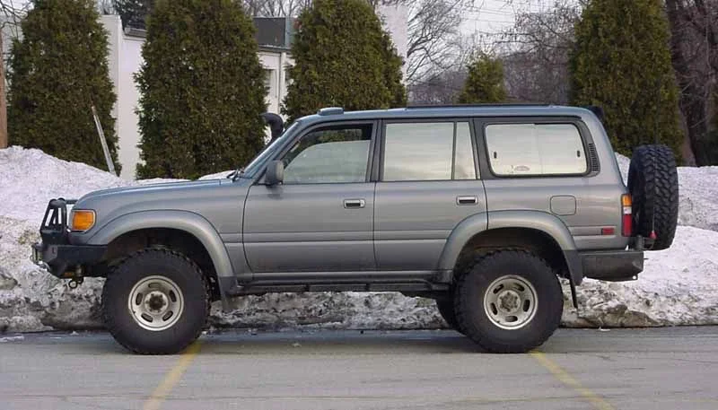

Old 04-09-06, 08:08 PM   #3 (permalink)
T Y L E R's Avatar
Join Date: Mar 2003
Posts: 2,504

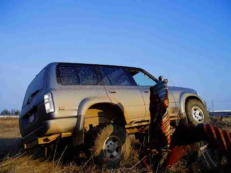

1. What lift Kit / components did you use? Include Spacers, if any.
*I started with the usual bits for a medium OME lift.
*However I placed Slee 4" coils in the front.
*I used Slee front control arms.
*Adjustable front/rear panhards.
I drove to Slee offroad in Co, and we put this setup together to achieve my ends - driveability, offroad ability, and a taller,wider level stance.
36x13.5R16 Super Swamper IROK radials
*Stock 16x8 wheels
*1.5" aluminum wheel spacers.
I installed Slee front control arms.
No rubbing issues with the cut front bumper ends and custom bump stop drops installed - 2" front, 3" rear.
No vibes at all.
Mainly on road/hwy. Daily driver.
Very pleased indeed.
This latest evolution described here solved many outstanding issues I had.
*I may buy 16x9 aftermarket wheels .. fatten out the stance a touch more.
*I would like to add the upcoming Slee front bumper and therefore a small front spacer to relevel the 80 subsequently.
A full writeup of this build can be seen in
this thread.
*Stay tuned for hardcore shots .. I'm usually too busy busting my junk to snap pics.

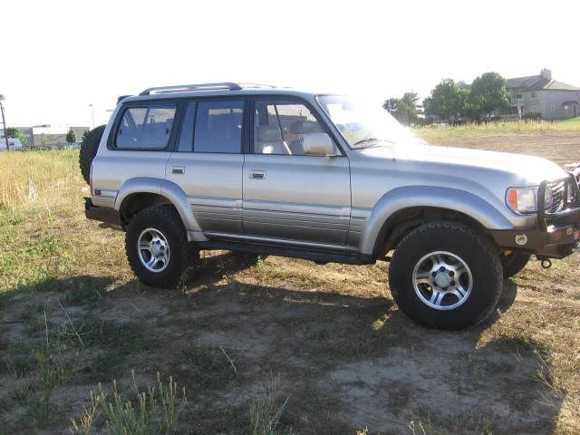

Old 04-10-06, 05:29 PM   #4 (permalink)
Site Addict
clownmidget's Avatar
Join Date: Jul 2003
Location: Ithaca, New York
Posts: 1,836

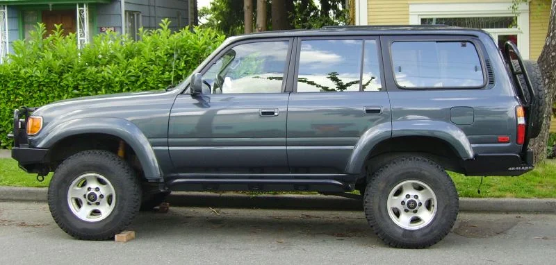

Slee 6" springs
1.5" aluminum spring spacers
1" UHMW body lift
OME N-73L/7100 Bilstein AK7114R04 255/70 valving
OME steering damper
Outback AWR front control arms
adjustable caster using Toyota IFS camber hardware
built around tires 35" to 37"
BFG AT KO 315/70/R17’s on pavement
Toyo Open Country M/T 37/13.5R17 on trail
4. Rim specs
Toyota Tundra/Sequoia Alloy 17" x 7.5" for pavement
Rock Crawler Steel 17" x 9" for trail
What the Outback front control arms provide plus the adjustable caster for the front-most mount
None that I consider negative
No, however, I installed a CV front driveshaft and new u-joints in the rear driveshaft and have Slee adjustable upper rear control arms to set rear pinion angle.
This is my DD. I also wheel this wherever I find myself.
Yes. I am running 4.88 ring and pinions and am happy with that choice.
Buy the kit from the beginning.
3-link or 4-link in the front with appropriate shocks. Run 37" BFG AT's on the street.

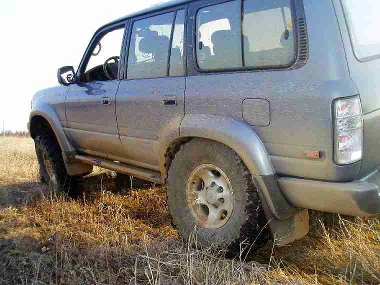

Old 04-10-06, 05:43 PM   #5 (permalink)
250+ Club
NW-sickboy's Avatar
Join Date: Feb 2003
Location: chicago
Posts: 689
Slee 6" springs
14 inch 5150 Bilstiens
OME steering damper
Rear bump stops
no front sway bar.
Custom modded rear sway bar.
14 inch bilstiens 5700 (?) or are they 5500? the have a remote resivoir and does not use busing but a spherical end.
Looking to run a roughly 37 inch tire.. In running trails that get you high centered or caught on the sliders with 35's and J's going this route seemed logical
37 inch SSR, Grooved and Hammered. Saving coin for something new. Wouldnt really recommend this tire now that there are so many other good choices out.
4. Rim specs
17 inch pro comp extreme alloy. 5 inch bs but i run 2 inch spacers. I am going to go to a 16 or 17 inch steel wheel 2 inch bs once i get new tires
I have custom built front control arms. Looking back I wish i had just done a 3 link. These work better than stock but would have done it differently.
None, I run no bump stops up front
I run a CV joint up front. rear is stock except i did new joints at same time of lift. I adjusted the rear arms back to stock angles
When i built this rig it was not my DD. I am now DDing this vehicle and my toy with some things like a front sway bar, Defenitly getting different tires as these are LOUD and UNBALANCED.
Sure. i have 4.88's, Thinking i will go supercharger in the next 16 months.
Ya so far. Its hard to find the happy medium where you still enjoy driving it on the road yet still have the results off road. I just drove it from utah to illinois and it was very drivable, a front sway bar would have done wonders though
I liked my j's and the progression but doing it once is always better. I have the "stiffer" rear six inch springs, go with the softees
37's seem like a great size. no bigger (anytime soon) wouldnt mind having an extra set of 35's to throw on if there is no wheeling coming up.

Transportation, moderate wheeling, fishing, camping, etc..
Yes - my third 80, I had two 60's and two 40's going back to 1979.
Nothing.
None, unless I decide to retire truck from DD use which I am contemplating. Then I will add more aggresive tires. Probably TRXS MT's, Aussie locker and sliders.
J springs F&R w/Mr Gasket 1" up front
Before this we had OME Med F&R & we would overload it when traveling to events-so we upgraded
315/75/16 BFG AT
Stock
Slee castor plates
None
After installing the J's had front drive line vibes, then after going to 4:88's they went away....I have no clue but the wifes thinks I worked a miracle
Wifes DD....we alternate wheeling her truck then mine at events
VERY SATISFIED!
Have purchased the J's from the start.
Wifes happy.....I'm happy!

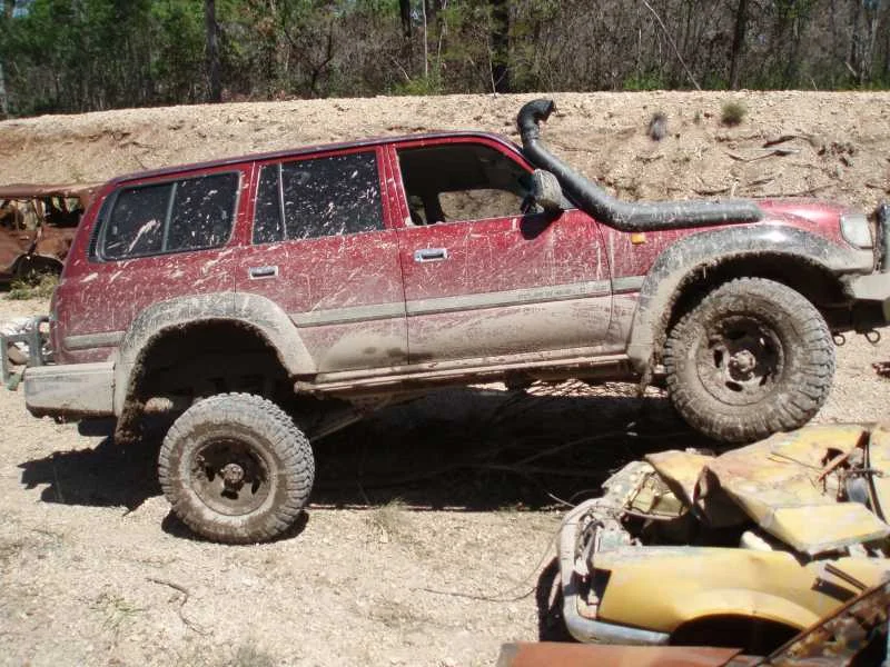

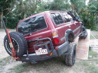

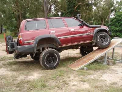

OME 418/421 springs (OZ spec competition springs)
OME N73L/N74L shocks
Superior Engineering 30mm spacers in the rear
Tough Dog adjustable panhard rods
Fitted ARB rear bar that caused the rear to sag from my old 2" lift to below stock height. Decided that if I was going to put heavier springs in I might as well go 4".
285/75R16 Goodyear Wrangler MT/R
4. Rim specs - 16x8 OEM steel wheels powdercoated black
Have EFS 3* CC bushes
Only on the 3" exhaust tailpipe under full compression of the RHR wheel
Not as yet.
Daily driver- to and from work each workday (75km round trip)
Weekend warrior- medium to hard 4wdriving most weekends
Long distance expedition vehicle- Annual 4 weeks leave, big trips
As my truck is on the heavy side I think the L shocks are struggling to control the weight. Before the weight increase the old OME shocks were fine but now I feel I need stiffer valving on my new shocks in certain conditions.
After being led astray by non-mudders and fitting 3* CC bushes I would fit 5.5* CC plates or drop arms first up if I was doing it again. Maybe fit Tough Dog or Dobinsins shocks instead of the OMEs for the reasons listed above.
Drop arms and stiffer shocks as above. I also have a set of Simex Centipede Extreme Trekkers 35/10.5R16s on 16x8s for play use. I haven't tried them with this lift yet to see if they rub but they didn't with the 2" lift so don't see any dramas. Haven't modified my bumpstops yet (I know, it's on my to do list).
Edit; BTW I don't run swaybars at either end and I've strengthened the rear control arms with 30x30x3 steel angle iron stitch welded to the underside of the lower arms.
Mick

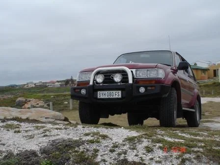

My cruiser is fitted with a 350 V8 and just recently added a MCC bull bar. Even before adding the bar the 80 appeared to be drooping a bit in the front. Is there anywhere i can get the factory specs on actual clearence, and where is this measured. Is it from the centre of the axle to the bottom of wheel well or between axle and bumpstop

Standard height is 20" from axle centre line to bottom of flare, IIRC.

Thanks,
Is that the same for the front and rear ?

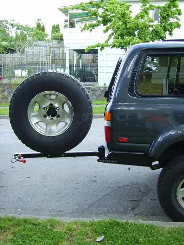

ome J springs and 73/74 shocks. no spacers, no sway bar extensions and stock brake lines except rear centre brake line to diff is a T100 line.
i was happy with mediums until I added a winch, sliders and a rear bumper. Js got me back to where i was and a bit more
285 bfg ats
stock 16x8 alloys
none as of yet - it's coming though
no
none so far, but I suspect I'll have to replace the front u-joints
DD commuter / camping / logging road expeditions
very happy
maybe 863s on the back. my rear clearance height is crazy, but the 863j shock ride is very good even empty.
thinking about those extra MT tires and rims, 33 or 35
Include any links describing your lift or issues.
here is video of the truck with the extra armour but before the Js. play the first part with the sound up to learn why I went to Js!
http://www.risingsun4x4club.org/phot...oto=33&cat=512
Include a photo showing the lift and an action shot
no actiosn shots yet, but here is the lift and an idea of what 24 inches of rear bumper clearance looks like

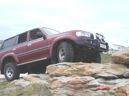

In front I have the OME (~2.5" lift kit) heavy springs w/ 1.5" Metal Tech Spacers and medium springs in the rear. OME shocks all the way around.
Trying to acheive about 4 inches of lift for improved off road performance - have winch and bull bar in front - needed balance because I don't have too much weight in rear (yet).
3. What tire size are you running? ~ 33" BFG MUDS
4. Rim specs - Stock Rims
What came in the kit from slee
No
None
Just retired as DD this month, has been DD since adding the lift in 2003. One weekend/month does about 25 miles of forest trail.
Yes
Add ~ 1" to rear ride height due to the addition of custom/built-in tool storage and CO2 tank storage. Maybe by switching to the heavy springs.
May go to 35's when 33's wear out a little more.
