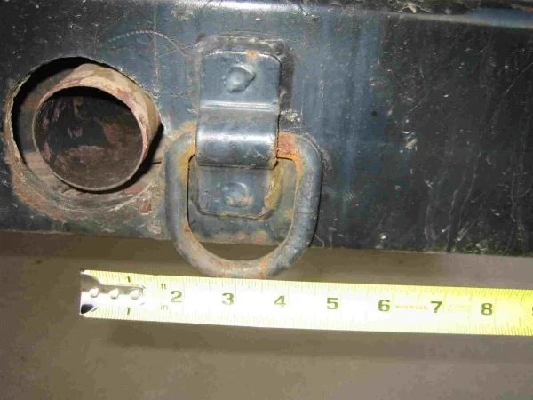

look right up the tail pipe and you'll find out........which means it's absorber, usally can tell by the holes. Works like a glass pack.

Originally Posted by Hawke
What does that mean?
This........ Just recently I had to tie up my tail pipe with zip ties. Happened to look up into the resonator. From what I recall of taking the resonator apart off my celica it did have some material in it. It had the same pattern of holes inside and would just guess that probably the 80 was the same.
