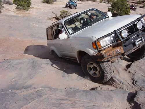

pics
Moab and Holcomb Creek

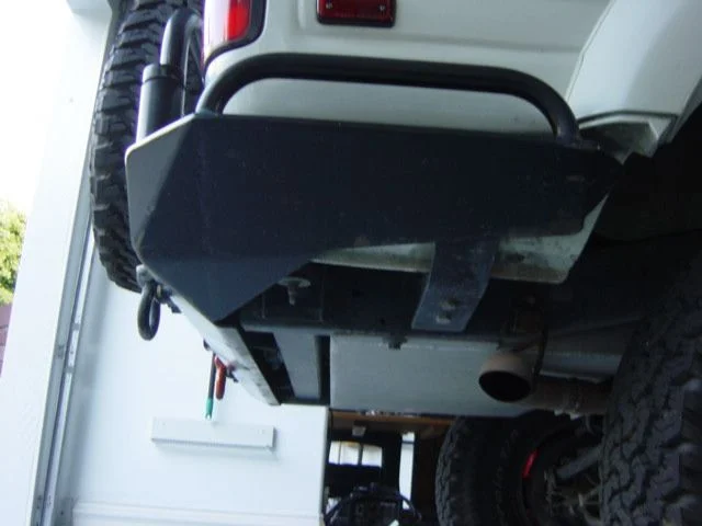

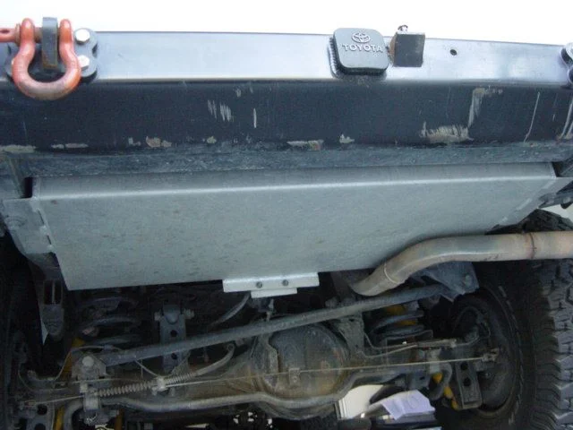

Fuel Tank Pics
Here is some info and a couple of shots of the aux fuel tank
the demensions are 21"x40.5"x7"
this comes to roughly a 26 gallon tank
Please note that the frame was cut (bobbed) and a new rear cross member installed when the 4+ bumper went on. Your clearance for a tank may vary slightly...by how much I don't know?
I was able to mount a filler neck on the top of the tank that points straight at the dual filler neck...straight hose connection between frame and body. To get the fuel out I used a standard fuel pump (slow) that pumps the fuel into the breather line of the stock tank with a T. This way If I forget to turn off the pump the fuel just gets dumped back into the aux tank via the dual filler neck.
As you can see from the photos the tank is flush with the bottom of the frame. The bit you can seeing hanging down is the bracket that holds up the front of the tank. I still need to add a skid plate which I plan to do in the next couple of weeks.
I lost a little capacity a few weeks back on the Hammers in Johnson Valley. Lucky for me the exhaust took the majority of the hits...saved the tank but I now have 1" exhaust
It was very difficult to run the exhaust with the tank as far forward as it is. At the time I had the tank built I wanted the maximum gallonage and the tank to be flush with the frame. I have changed a bit in my thinking lately...more clearance for all pieces including the exhaust. I am going to have the tank cut a bit to allow for the exhaust to squeak through between the frame and the tank. I figure I will only loose about 5 gallons capacity whcih leaves me with 21 gallons which should be plenty

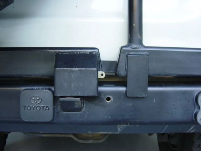

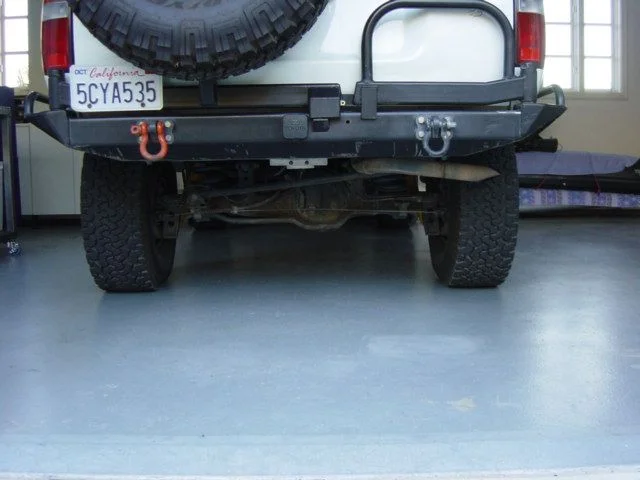

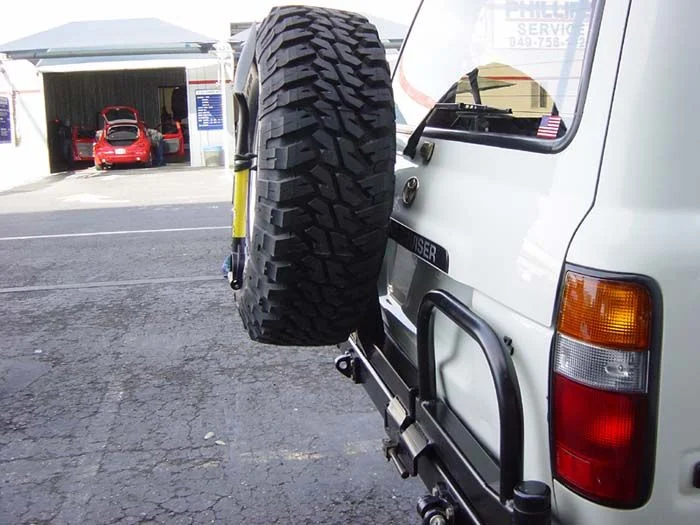

rear bumper
Funny Mike! Lets just say I would highly recomend Slee, Hanna or 4x4 labs...I think you all get the hint.
That said, this bumper is built like a Brick Out House! I have smashed, draged, scraped, slammed the hell out of it with out even a small dent or bend. I havn't taken it off the truck but I guess it would weigh around 250#.
It is painted and not powder coated and is starting to really look bad (powder coating as soon as I fix a couple things)
The latch that it came with (second pic) for the spare and side rack was a royal pain in the arse. It worked great...no rattle or shaking... just really hard to open with one hand much less two. And then I was always loosing the bolt or handle or woorse forgeting to latch it DOH!!!!! I have since fixed this problem by using a slam latch (first pic) and fabing some new brackets. I think this has to be the best thing I have done to the cruiser. I just slam and walk away!
The other thing I added was a grease cert on each bushing (not bearings) because I couldn't get the thing open a month after I got it. Now it is smooth as silk!
I am also going to put some air struts on each swing away to prevent body damage etc. when on a side hill.

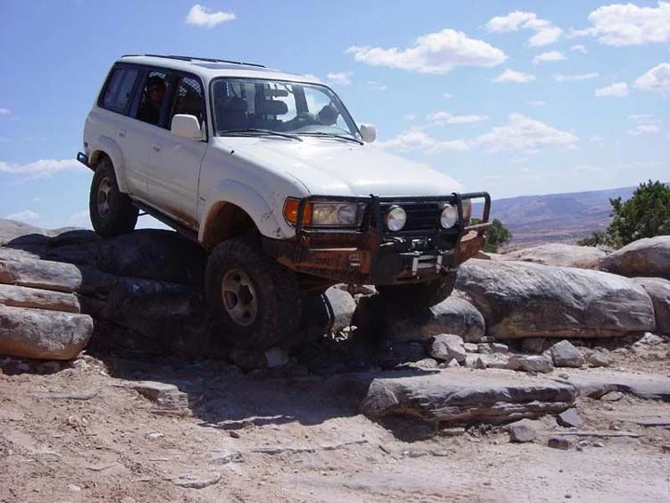

Here are a few from Moab 2004

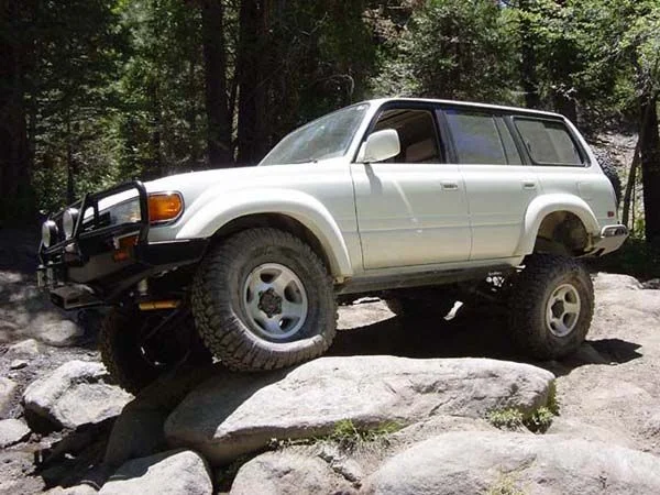

Colorado 2003
Colorado 2003

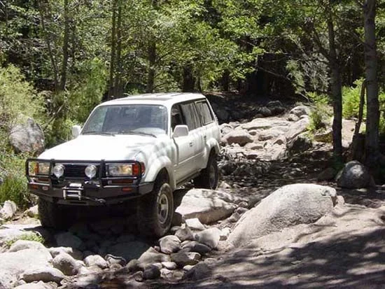

Anza Borrego and Holcomb Creek

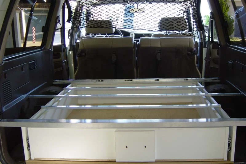

Rear Drawer System
This is one of many un-finnished projects for me. I have 1/2" plywood and carpet above the aluminum rails you see in the pics. I've had well over 500 pounds on top of this thing and it hasn't bent at all. The smaller middle pieces are 1/2"x1"x?thick Aluminum. The rear most piece (Strongest) is 1"X2" Alum welded to a piece of 1/2x1 Alum. The front is 1"x1" Alum also welded to 1/2x1 With the plywood on top the deck is flat all the way from side to side (over fenders) The sliders are rated for around 500 pounds and are full extension. I will snap a couple pictures of the current state of the drawer (been the same for two years)

Very Cool Mark. I really like the truck. The fuel tank and the rear drawer system. Also you have some really good pics its hard to get good angles that really show off what a cruiser can do etc. I would like to here and see more about the drawer system what is the plan? do you like it etc.?

Taz,
awesome rig, and great write up. I'm looking forward to reading about the other aspects of your rig as the week goes on.
I had a feeling the 4+ rear would bring about some talking considering they are retardedly slow when it comes to manufacturing them and the wait time is over 1 month.
I'm a big fan of how the bumper looks, and now performs although the swing outs were a let done with how they failed to function well.
Nice build, hope to see it in person sometime soon.

I wouldn't worry about that rear cross member too much. It doesn't support anything ie suspension or body mounts. It just holds the frame straight at the back. The new 4"x4" cross member looks alot stronger than the stock one. I've had it for three years and see NO signs of problems with the welds etc.

Hey Mark, killer thread! Lots of great info and wheeling pics, I love it.
Did you make any templates for your gas tank when you built it? Any other pics showing the filler neck and such? I want to do a aux tank bad and building one seems like a great idea.
BTW, thanks for all the PM's with great info regarding my upcoming lift, I really appreciate it.

Taz,
I am also interested in more detail on the tank. What type of material is it and did you chemical etch or coat the interior?
