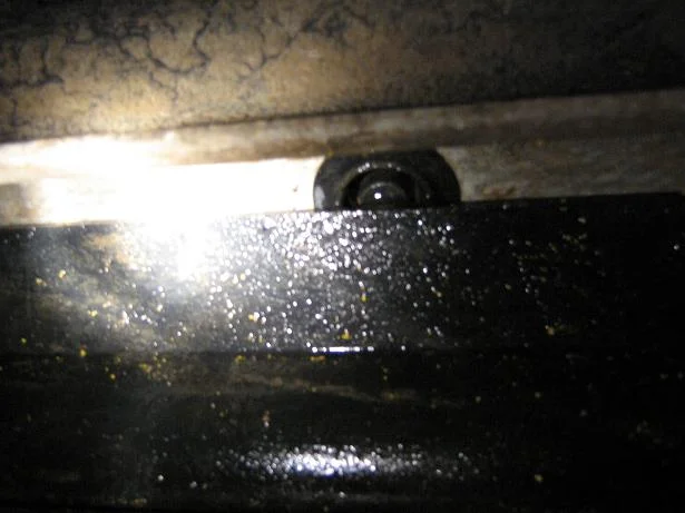

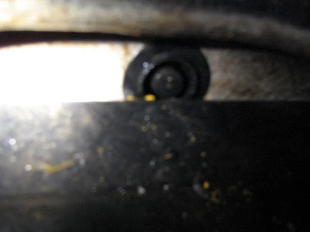

I found it, the pictures are the plastic little plugs right underneath the running boards. I will get a picture when I drain it. And see how much water is up there.

Unless I'm misinterpreting your post, it sounds like you found the plugs--but not the actuall the rocker panel drain. There are some little slits hiding on the other side of the rocker that let water drain out--until they become clogged. You use a zip tie or something like it to clear them.
If the slits are clear, then you won't accumulate water, and you won't have to pop the plugs.

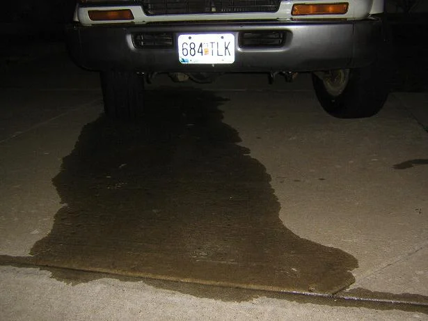

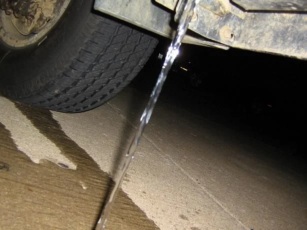

Ok, I got it. There was quite a bit of water up there, it almost feels lighter. Probally like 20 horsepower gain.....
