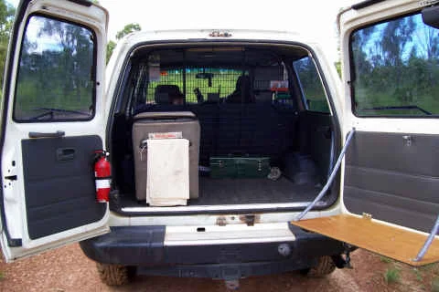

Heres a shot from the rear showing the barrier , 40 litre engel and my homemade fold down shelf.These barn doors are not availible in America as far as Im aware, there good though.

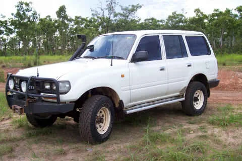

Heres a good one of overall veiw

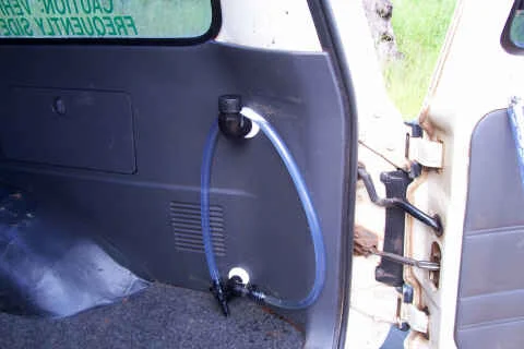

heres a shot of the 25 litre water bladder behind the R/H rear trim

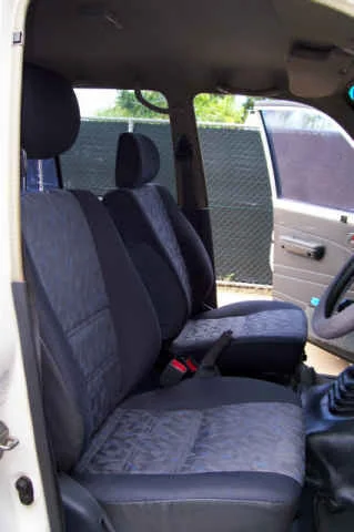

buckets
Added some bucket seats from a GXL . Unreal difference from the old 1/3 2/3 seats

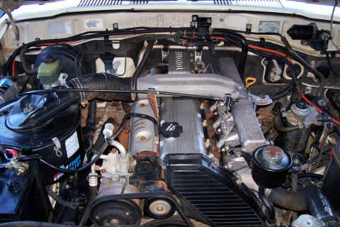

Heres a pic of the mighty naturally aspirated 1HZ diesel

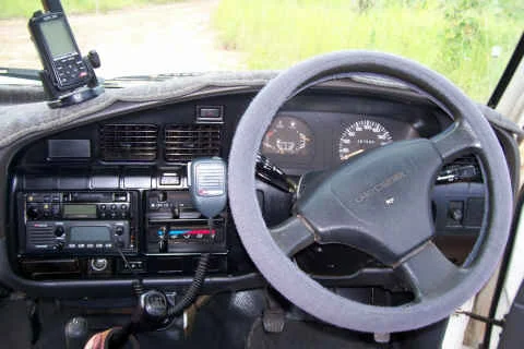

This is a pic of an AUS spec dash , you will notice a 40 channel GME UHF radio unreal 2 way ,can pick up talk at least 25klm away on duplex.My ARB switches arent there on this photo but are now , rear locker only.
Aux battery gauge and GPS are are there.
Ver ynice steering wheel cover fron Independent motor mart

Great truck you got there! I would like to know more details on the water system setup you have. Any info would be appreciated.

On a base model cruiser there is nothing behind that trim.Its a moulded bladder that screws to the top of the steel area.

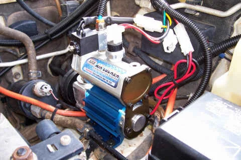

New compressor
This is the new ARB air locker compressor just released in Aus specifically to run air lockers.You blokes may not have seen it yet.Jealous?

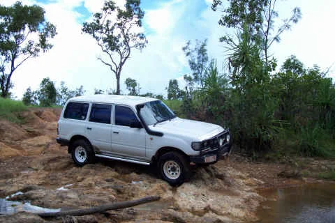

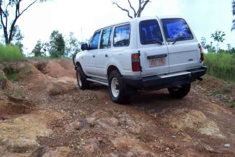

Heres some WHEELING pics

I like that shelf - is that for sitting or just for stubbies?

mainly stubbies and my wife making my lunch when Im not in the bad books.

I used to think i like those barn doors. but now sleeping in the back of my rig and using the upper tail gate to shelter me from rain getting things in and out of the truck and also the US doors are great for putting a tarp over the end which adds a good 3 feet of leg room when sleeping makes me appreciate the US doors more.
Still nice truck. How is that diesel without a turbo? Enough grunt?

A little more info please or pics!

did you make this yourself? details please. How do you clean it out etc.

Looks like the ARB Flexi Tank.
http://www.arb.com.au/flexi_tank_water_tanks.htm

Yes the water tank is an ARB flexi tank , I clean it by adding a tiny bit of bi carb of soda and flushing through.
No comments on the new compressor yet?Is it availible overseas ?

Nice Air Compressor. I have factory lockers and use CO2 for tires, so I don't know anything about them.

ARB sells that compressor here, wish I would have gotten that instead of the fully size ARB compressor which I only use for my lockers.

1hz is a bit sluggish without turbo but cruises on 100 klm easy

Do you happen to have pictures of the water bladder behind the panel? I'm wondering how you secured it and how it looks back there.

Norcal , unfortunately no I dont have any photos of bladder and its a p.i.t.a to remove trim.Its secured with 3 bolts along the top in existing threaded holes.
Its made of food grade heavy duty vinyl shaped the same as the area behind the trim.
I had trouble with it poping the trim off when it was full and expanded so added some timber reinforcing behind the trim.
You will have to remove any speakers that maybe behind there to make it fit

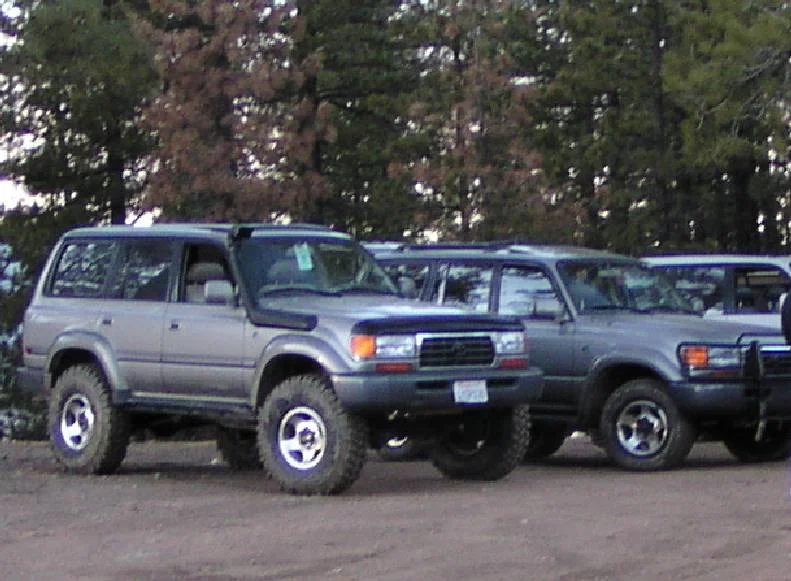

Nice rig.
What kind of snorkel is that? It doesnt go down the fender as far a safari.

Curious what the sticker says on your rear side window in the 3rd picture?
All I can see is:
"Caution Veh
Frequently Side"
Nice idea about the water resevoir too. Reminds me of my 1st Gen 4runner, where they had the rear washer sprayer resevoir back there. Funny how 80's don't have it that way, so your don't have to pipe so much washer fluid to the back and use that diverter that people have problems with.

snorkel
Quote:
Originally Posted by apcoleman
Nice rig.
Its from an Aussie company called Gear to Goannaware.
A goanna is a large lizard that lives in the top half of Aus
www.4wdsystems.com.au

sticker
[quote=gbell210]Curious what the sticker says on your rear side window in the 3rd picture?
All I can see is:
"Caution Veh
Frequently Side"
It says ''Caution vehicle frequently sideways''
My wife liked it.
