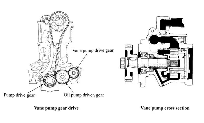

Why change it? Power steering fluid is usually an ignored fluid, but over time and especially if overheated it can break down, oxidize, change viscosity, consume its additives, be contaminated with solids such as grit from the environment and wear metals from the pump and box, having no filtration these contaminants circulate endlessly causing more wear.
It is a good idea to occasionally change out the fluid to get rid of old fluid and the contaminants it carries. Although color is not the best indicator of fluid condition it is the easiest to check, if your fluid is looks considerably darker than new you should consider changing it to be safe. It is also a good thing to baseline this fluid after purchasing a 100K+ mile used 80 series as it has likely never been done before.
The classic method of changing PSF is to disconnect the return line, start the engine and turn the wheels lock to lock wile someone attempts to keep the reservoir full. The pump pushes the old fluid out the return line, wile this does work it is messy and almost impossible to keep up with the pump, an uncontrolled hectic and possibly pump damaging process,
I prefer a more leisurely controlled method

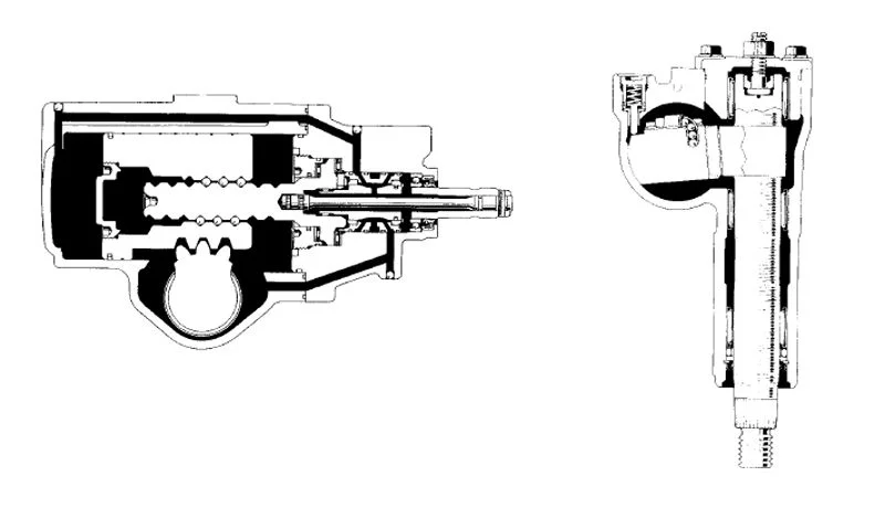

As the wheel turns a large piston in the steering box will draw fluid from the reservoir through the pump, into the box, out to the cooler and out the return line to your drain pan, valves in the box keeps the fluid going in the same direction no matter witch way the piston is moving.
Keep the reservoir from emptying if air gets in it breaks the prime and it will take a bit to get going again, this will also form foam witch may lengthen the process.
