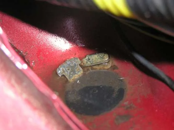

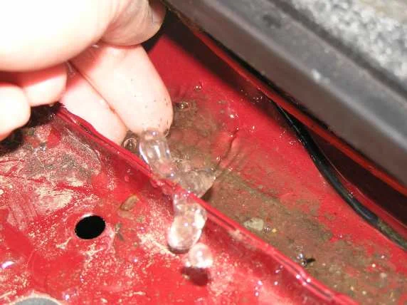

here are some pics. As I put water directly down the sunroof drain it fills up through the plug into the channel shown.

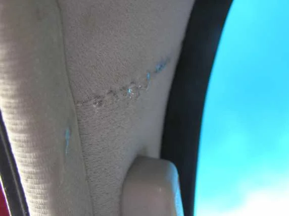

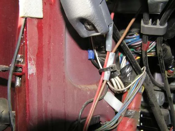

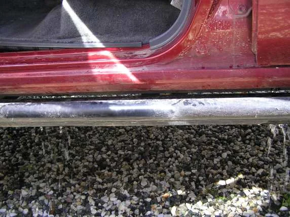

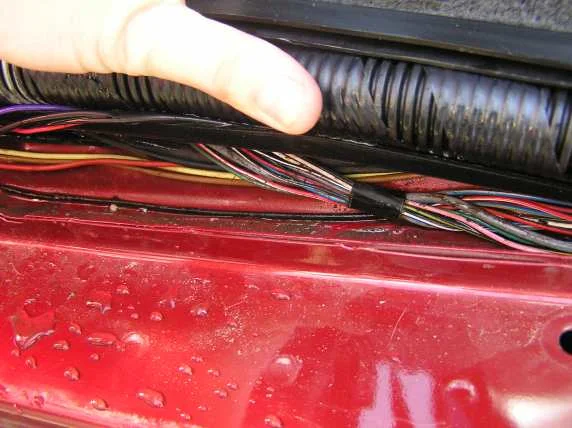

Then it starts leaking at the upper A piller and from the door molding. The last pic is the water draining out from the panel. Shouldn't it drain from 1 location if all is working properly?

It sounds like you may have two problems. One being plugged slit drains in the rocker and the other being an issue with the drain tube it's self. It could be that the rocker is filling up and causing the tube to back up. At this point I would recommend pulling the black plastic plug that is in the bottom of the rocker, about 4 inches aft of the fender-to-rocker seam. Excercise caution when popping that plug out as you are apt to get a face full of water when it comes out...
After you get that plug out, monitor the upper area to see if you still have water issues up there. If not, it was backing up the drain. If so, the headliner will probably have to come down to investigate further.

Teresa, when you pulled the black plastic plugs did water come out?
If I understand your last post correctly you removed the plugs and then had a rain fall that would have been enough to make things wet again but you were dry. Is that correct?
If so, then it was probably the slit drains backed up and the rocker(s) were filling up and flooding the floor and possibly backing water up the sun roof drains and overflowing the sunroof pan.
I would leave the front rocker plugs out for the time being.

Yesterday, I had a couple minutes to dink with mine, but learned nothing new.
I fished a bunch of weed-eater line through the sunroof drain tubes until it stopped. Came back out dry.
I removed the black circular plugs on the rocker panels...bone dry.
I tried fishing the weed-eater line into the slits, but the line was too thick. I need a small paper clip...I'll try that later.
Floors are wet...nasty...yucky...blah!

Zip ties work the best for cleaning the slit drains. Flat to fit and plastic so they do not scratch the paint to expose bare metal in an area where you least want it.

For those of you still having drainage issues:
* When working properly, the sunroof drains will flow a lot of water. The tube running down the A-pillar is ~1/2" in diameter.
* First you have to make sure the water can drain down the tube. Those that park under trees might have leaves clogging the drain tube. The above suggestions for unclogging should work.
* Behind the DS kick panel, the sunroof drain tube can become kinked. You need to remove the panel and check. Especially Sully, who said the wire was hard to feed all the way down to the rocker.
* Clean the rocker panel slits as described by C-Dan; using a plastic wire tie and removing the plugs if needed.
* While you have the DS kick panel removed, carefully inspect for prior water intrusion and corrosion. Hugh had a fire caused by a sunroof draining problem. There are a lot of wires, connectors, and ECU's in this area.

Describe what you found when you removed the DS kick panel.

I was the one that did the investigation and that is what the above pictures are from. Initially when I pulled the kick panel, the gutter drain where the electrical wires sit was just wet. After that I put a hose at the point of the sunroof drain and as you can see in one of the pics it substantially filled with water. Tried to get a pic of me moving the water with my fingers. We've left the front RP plugs out for now. Drivers side has always been worse than pass side. Its been dry here for 3+ days, today I pulled the DS panel and still wet. Of course not soaked but wet. The dissapointing discovery today was the rear quarter panel. I do think the problem there is fixed with silicon, but after getting into the area where the jack is, there is a large amount of water in that area. Is there any way to let it exit without a wet vac?

Make certain the drain inside the DS kick panel is not kinked, bent, or compressed. If it is, the water will back up and come down the A-piller as you saw. I hate to sound like a broken record but you also need to be sure you get that area dried out and correct any corrosion if found.
As for the rear quarter, there are some more rubber plugs in the rocker that you can pull to help drain the rear area where the jack is. You might need to silicone seal the sliding windows. I haven't seen that problem on mine but there have been a number of posts describing how to fix the cargo area leaks.
