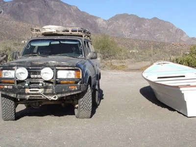

Early pic of the 80 and some complementary poooser shots...

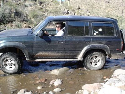

another pic...

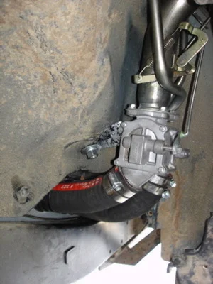

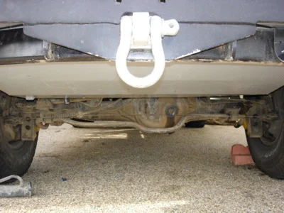

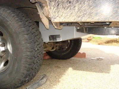

And...Pics of the Auxilary tank

AUXILARY TANK
I bought the tank in March of 2005. I got it from Beast II. (thanks again!!!)
Beast II got the tank as a kit from Slee, just never installed it. So, I was very fortunate to have EVERYTHING except for a fuel transfer pump, fuel filter, and fuel supply hoses (filler to tank). So, I had the tank, dual filler neck, OEM switch, George S. control box, and misc. mounting hardware. From what I understand, they have gotten REALLY difficult to source. The tanks come from Oz. So getting them here is challenging. And when distributors get them, they are usually spoken for before arrival.
The tank sat in my garage until October, when I started reading the directions, and researching online for install tips. I finally got around to installing the tank in November. I had planned about 3 full days, and it took me probably closer to 5 or 6. Mainly because I kept reading and re-reading directions, and making sure everything was correct.
The tank essentially just pumps fuel into the main tank whenever you desire, by engaging the OEM sub-tank switch. I currently cannot monitor fuel in my aux. tank. However, that is only b/c I haven’t wired it up. There are write ups floating around here on how to do it, but basically you have a toggle switch, and by toggling in either direction, you can see how much gas in each tank.
Currently my tank doesn’t work b/c I didn’t mount the transfer pump up high enough. I had it on the cross member above the rear control arm. However, I had a Carter pump, and the instructions stated it needed to be mounted straight up and down. So…while flying down some dirt road in Baja, my rear end bottomed out, and the control arm came up and hit the transfer pump. I have another pump, generic, I am just working on mounting location.
Hope that helps for now. I plan to do a write in the next couple weeks.

I had the pleasure of trail riding with Robb and his rig in Baja - Over 2500 miles of mixed pavement and the hardest washboard two track - His 80 rocks!
I am in full envy of the aux fuel tank.
Nice write & photos up Robb
