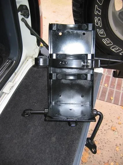

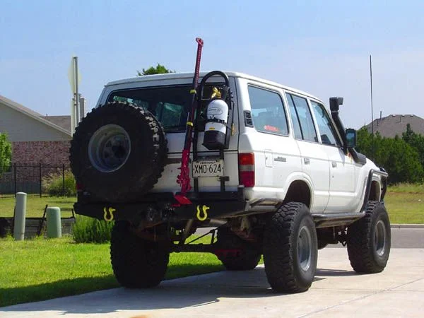

I don't run a roof rack all the time, so I mounted mine on the rear bumper's ladder. Bought a couple of clamp mounts of the type used to mount accessories to roll cages, and drilled four new holes on the mount. Works well, it's hard to see in the picture but there's still enough space to use the ladder. I have a neoprene cover with a velcro cinch that covers the valve, works great so far.

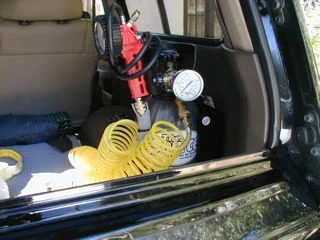

Seems like the perfect place, out of the cargo area which is usually taken up and off theroof rack. The ladder is usually only used for loading the rack, so seems like the perfect spot and you can still get around it. Great rig.

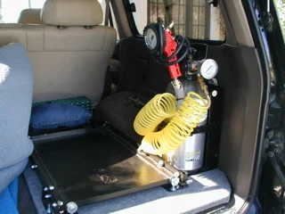

here is mine on top of rack....

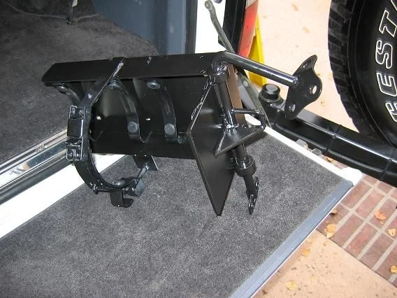

Here is the thread showing my design:

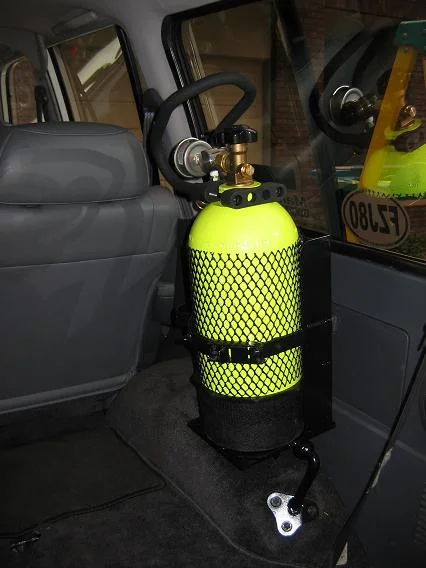

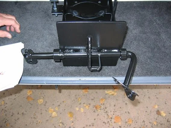

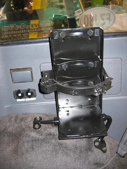

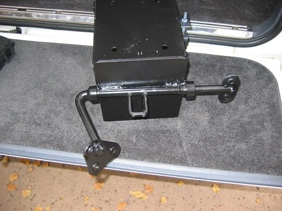

It shows both Beo's platform and what I did. My pics include the bracket by itself and with the CO2 tank installed.
If you'd like something separate for your FAQ, let me know and I'll write something up to post.

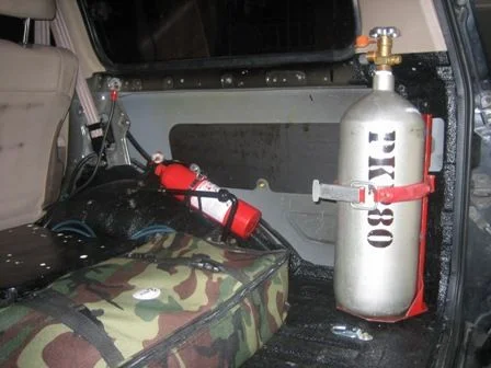

Here u guys go

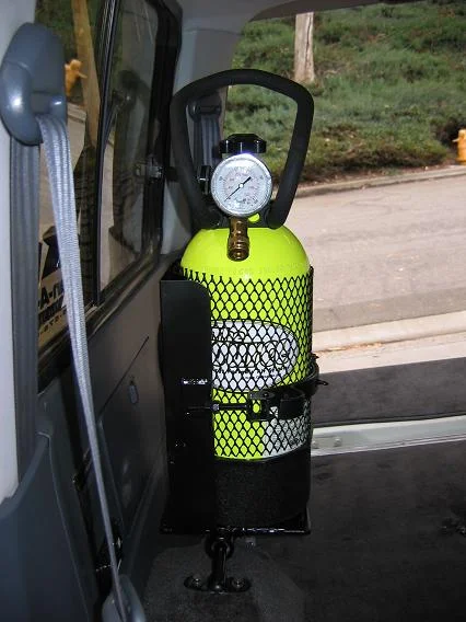

Here's mine- tucked next the the fridge slide

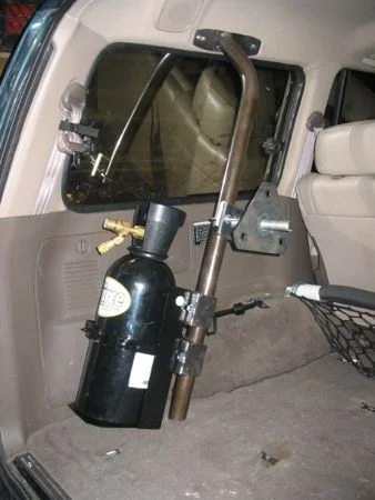

Stripper Pole Mount

Hey, that guy's running the same CO2 mount that I am..

Here's my solution to a CO2 mount. Credit for the idea goes to Chris Geiger and Beowolf with a little innovation I'll credit to the welder I had do the work.
The CO2 bracket that most of us have is a fairly standard fire extinguisher bracket.
I used a 7"(w)x8"(d)x1/4"(h) piece of steel that's welded between the two circular knobs found on the 3rd row seat bracket. The knobs sit 7" apart, thus the 7" width. The bottom of the plate is futher supported with a triangular piece that's welded in on the bottom of the plate and to the seat bracket. I chose to have the CO2 tank bracket welded to the steel plate as opposed to just bolting it on. Bolts would add some versitility to the bracket as an option. The entire welding job and piece of steel ran me all of $20. I cleaned up the piece with some acetone I have. You could use paint thinner or other solvent to remove residue left by the welds. Your paint will adhere better if you spend just a couple of minutes cleaning the bracket before painting. I did rattle can primer before rattle canning the gloss black to match the OEM bracket and CO2 tank bracket. Total paint cost $10 for a total project cost of a whooping $30!. It's extremely sturdy.
Here are some pics of the bracket:

One more pic of the bracket showing the triangular support piece and one of it installed in position without the CO2 tank. Yes - those are 12V outlets to the left of the tank bracket - one switched and one unswitched.

Here are a few of the bracket with the CO2 tank from The Source installed. I've subsequently rotated the tank so the regulator faces the rear of the truck and with the supplied air hose, I can reach all four tires thru the rear without taking the tank out. You could also route the air hose out the passenger doors or rear sliding windows.
I've been very happ with it. No rattles, nothing. It's solid.
