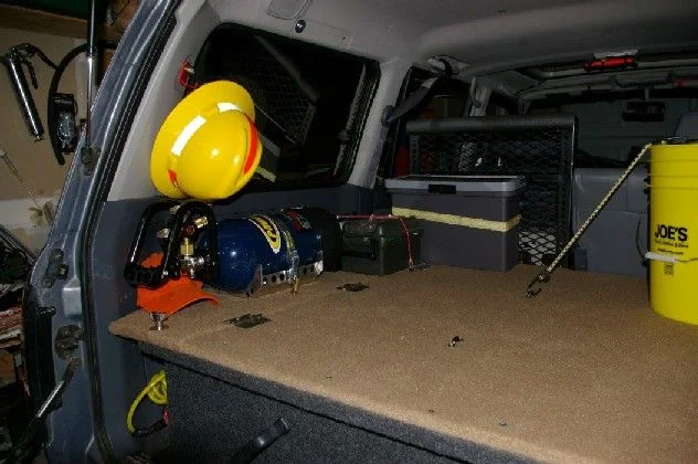

Here's mine...
I'll take some other close-ups of the bracket itself when I get home.

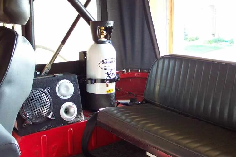

These are great guys thanks. I am going to install theone Brentbba showed up above. I just bought the seat bracket from a wrecked rig part out. I will have to order the CO2 bracket/holder and then have my friend weld up the same setup.
hmmmm, I have a 10lb Outback air setup in the 40 I move back and forth. Keep using that or get a new one with a 15lb tank?? Brents looks like a 10lb, so the 15lb tank would probably be too tall. Leaning towards using my existing air setup and using the new bracket in the Lexus for swapping.
I know the pic below is an FJ40, but its the system I would be swapping between that and the bracket Brent and B came up with.

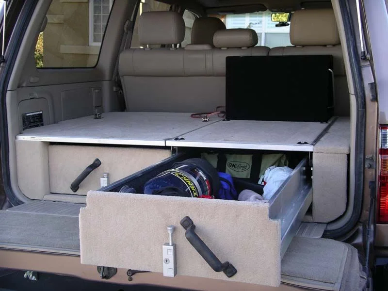

Drawer mount...

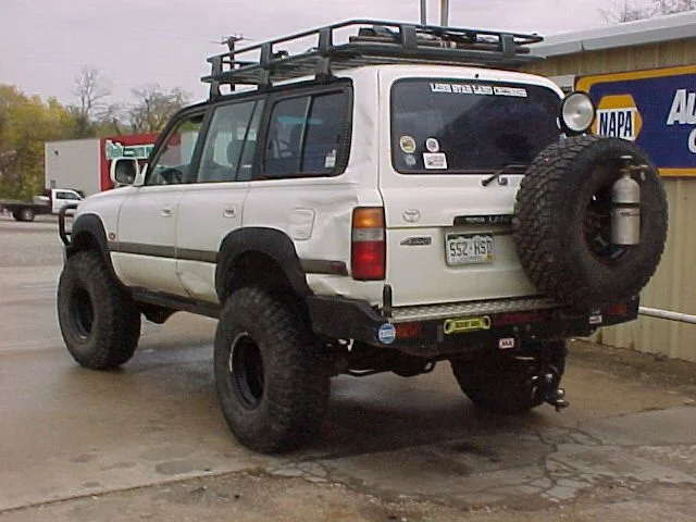

I copied exactly the setup above that Brentbba posted that he gave credit to Chris Geiger and Beowolf . I even used these posts as the instructions to the guy who made it for me.
The ultimate tank had the tank bracket. I bought an extra seat bracket for $15 and that way I can swap them in about 10 minutes if i need a people hauler. My friend welded it together for $20 including materials.
I really like this set-up

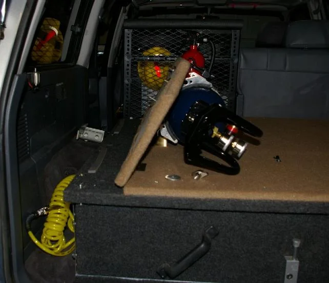

Here is mine
Very similar and it uses the stock 3rd row seat brackets with some mods. This is for the big daddy 20lber!
The pics are in various stages of completion of the bracket!
