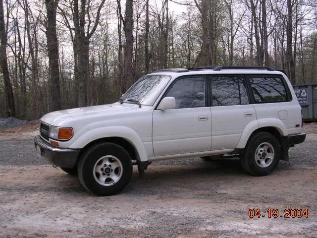

My 80 is a 1994 which my parents bought in 1997 off of a 3 year/30k mile lease. They had previous bought a 92 which was totalled but really saved my brothers life and they also bought a 1985 fj60 brand new from the dealer, which we still have and is almost at 300k miles.
Nevertheless, the 94 became my moms DD, grocery getter, and general family trip vehicle.
It served its purpose greatly and lasted her about 6 years or so, unfortunately never seeing much dirt and only having the factory lockers engaged a few times. She drove it regularly until about 200k miles when the Headgasket blew a few hours away from home.
FWIW, this may serve as a testament to the amazing 1FZ, but she drove it 3 hours home on a blown headgasket, and thankfully didnt do any damage.
After this, the search was on for something else for her and the 80 was quickly replaced. How it really happened, i dont know, but at some point the 80 became mine. I guess they figured the truck was worth more as a backup vehicle then the 5-6k we might be able to get if we sold it.
Here she is, stock.

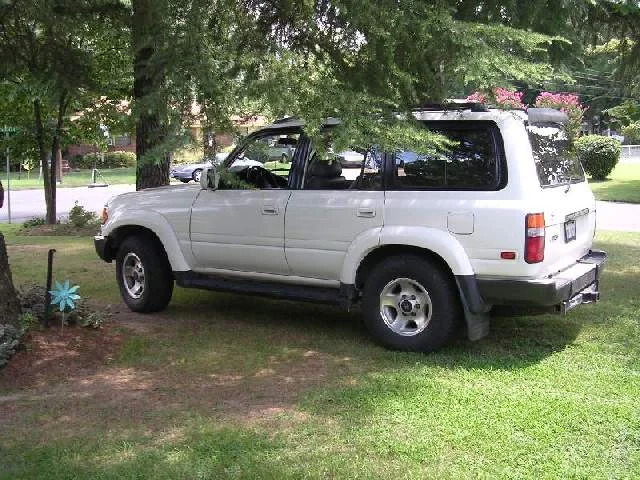

After much begging, I finally was allowed to lift the truck via a OME 2.5 Heavy load lift and get 285 BF Goodrich At's.

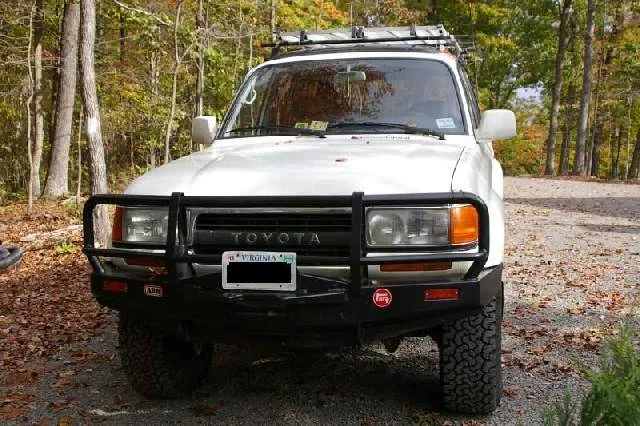

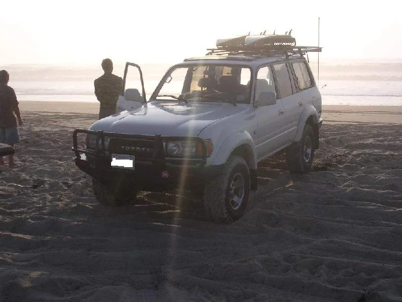

So after CMCC and driving the 80 for a little over a year, i was tired of the stock front bumper. I was on my 3rd front bumper, as a deer and previous fender bender had eaten up two.
After working a little more, and saving some $$$, i ordered an ARB winch bumper.

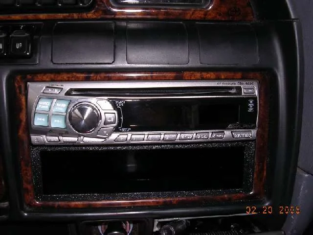

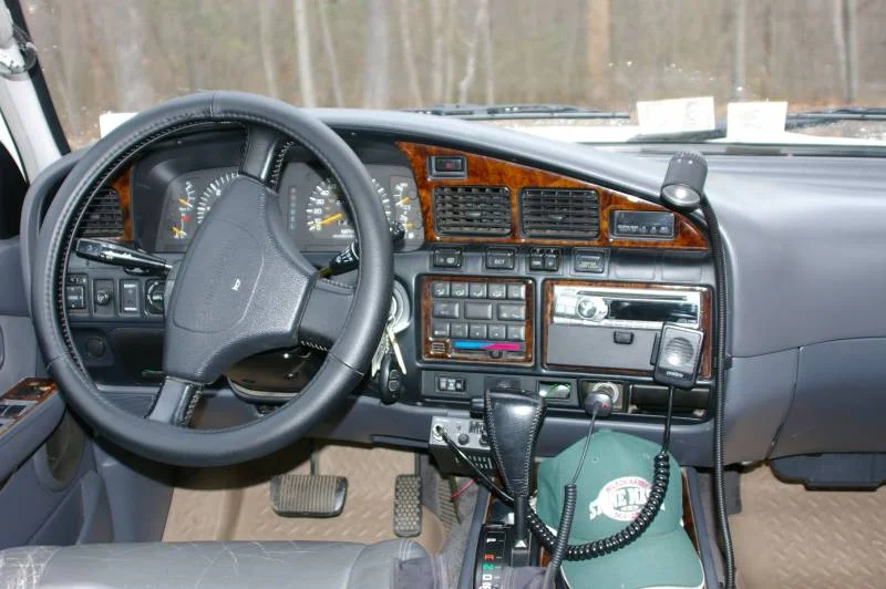

After the ARB, i wanted to address the rest of the stereo as the speakers were going on 11 years years and with the alpine head unit, they needed to be replaced.
I picked up a pair of 5 1/4 Eclipse 3 way front speakers as well as the 4 inch 2 way rear speakers.
The installation went great on these, and it made a huge improvement. To finish off the stereo, i added a 10 inch Pioneer subwoofer, powered by a 600 watt kenwood amp.
Eventually, i want to add a 4 channel amp for the speakers, but for now, it works perfect.

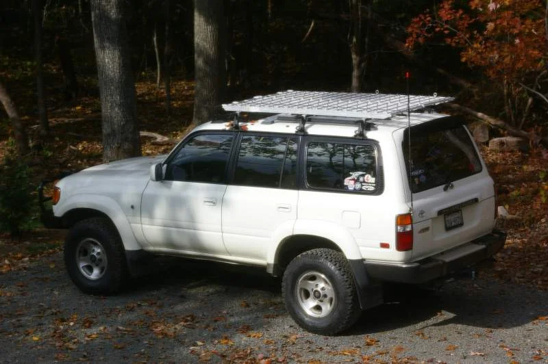

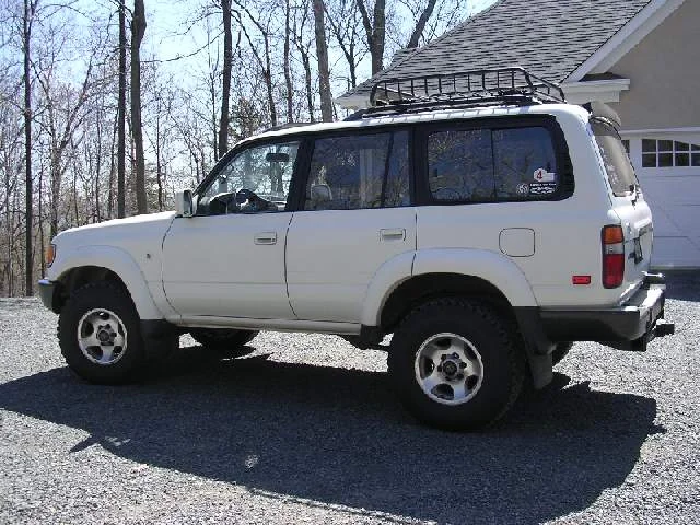

I sold the yakima and wanted to go with something with a slightly lower profile, plus i love WILDYOATS j-moose roof rack idea.
I searched around on ebay for awhile and was able to find a perfect ramp and some yakima crossbars. The ramp is attached via 6 u-bolts and has a few 1/2 ton(i think) eye bolts.

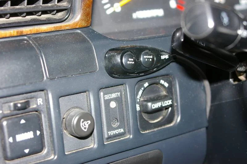

After the roof rack, I added a pair of IPF, JO1's with dual driving/fog bulbs.

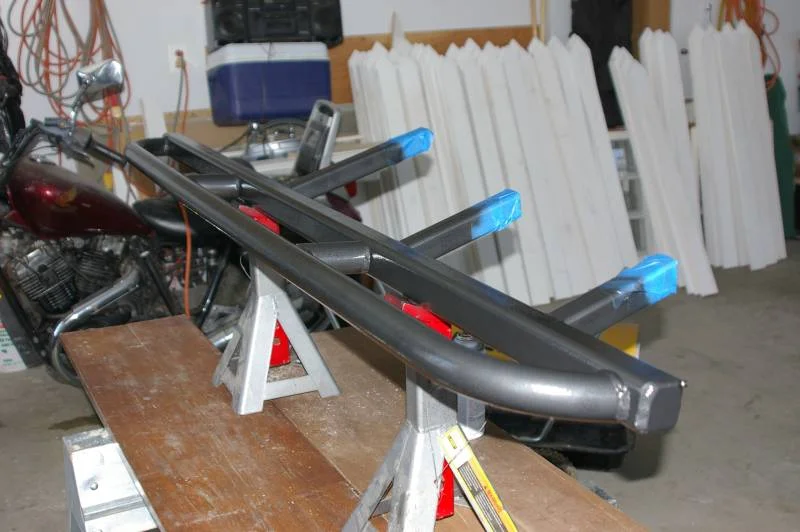

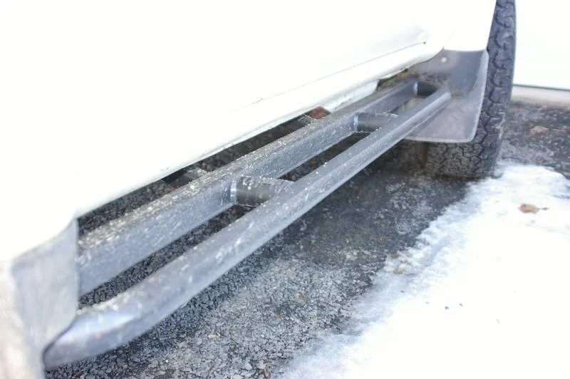

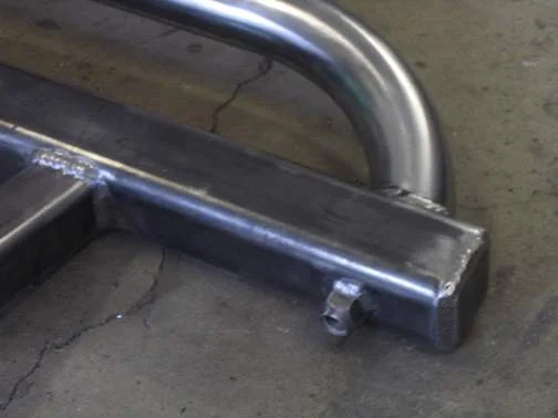

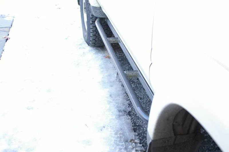

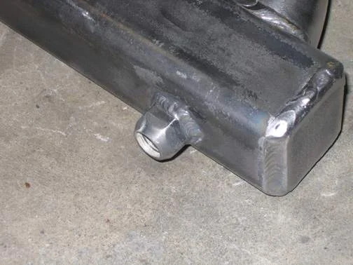

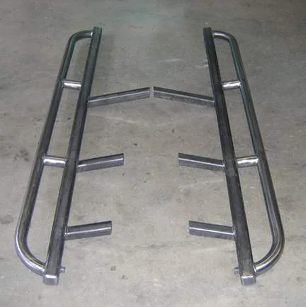

After a short wheeling trip to GWNF and having a really close call with the rockers, sliders became the next thing on the list.
I, however couldnt bring myself to spend upwards of 1000 dollars for a pair of sliders. Plus, i couldnt really afford it. I know that both slee's and hanna's are of great quality, but financially, i couldnt swing it.
I started looking for an alternative way of getting some sliders for the 80. I wasnt picky about how they looked or worked, i just wanted protection.
I had previously looked around at Richard Stubbs (stubbswelding.com) web page.
I'm sure a decent amount of people know him for his 4Runner and taco sliders. Because richard was located out west and i am on the east coast, i didnt think anything would come about of talking to him, but i did anyway. I dropped Stubbs an email and told him my whole situation. The same day, richard himself called me cell and talked to me for about 15 minutes. He was very optimistic about fabbing up his first pair of 80 sliders, though we would have to work together alot over email to make the whole thing work.
After alot of measuring and re-measuring, the plans for the sliders were finished and in about a week, they were done. My sliders are the same as richard's "deluxe" model and though the main bar is smaller and the actual mounts might be smaller then the other options, richard used .188 wall tubing and assured me they would suite the 80 fine. Richard also tapped the sliders for air and sent them off. They arrived at me door, raw. This is how the cost was kept fairly low. The sliders all finished and shipped were still much cheaper then any other options.
__________________
Brandon L. Downs
'97 LX
Pictures
BusinessBenefitsGroup
Group Benefits
Individual Life, Health, Disability
Business Insurance
Retirement Planning
Cruiserhead05 is offline   Reply With Quote
Old 01-08-06, 01:51 PM   #11 (permalink)
Forum Lifer
Cruiserhead05's Avatar
Join Date: Jun 2003
Location: Northern VA
Posts: 2,963

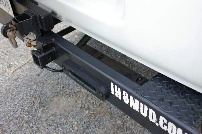

You'll quickly notice that the sliders only have three mounting bars. This NOT how the final product was intended to be. Once the sliders were welded on the frame, i took the final measurements for the fourth, front bar which has to work around the CATS.
Richard is currently in the process of fabbing up the final bracket around the cats and when i get it in the mail, it will get welded on.
I cannot say enough about my experience with Richard Stubbs. Again, i have absolutely nothing against slee, hanna, and IPOR. But richard stubbs is an excellent person to work with and was willing to do anything i asked. I would happily suggest his services to anyone out there.
The next few pics are them in the garage getting a few coats of Rustoleum textured paint. As well as pics of them mounted on the truck.
Here is a link with more detail on the finished product.
http://forum.ih8mud.com/80-series-tech/79278-stubbs-80-series-sliders.html

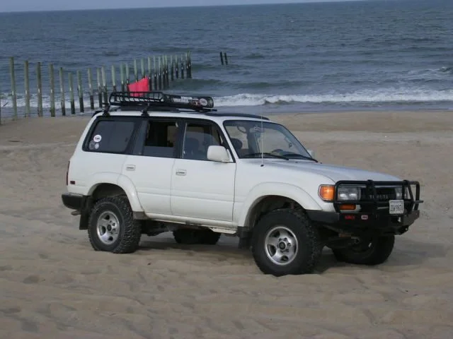

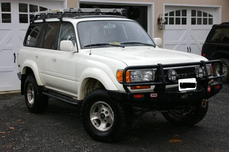

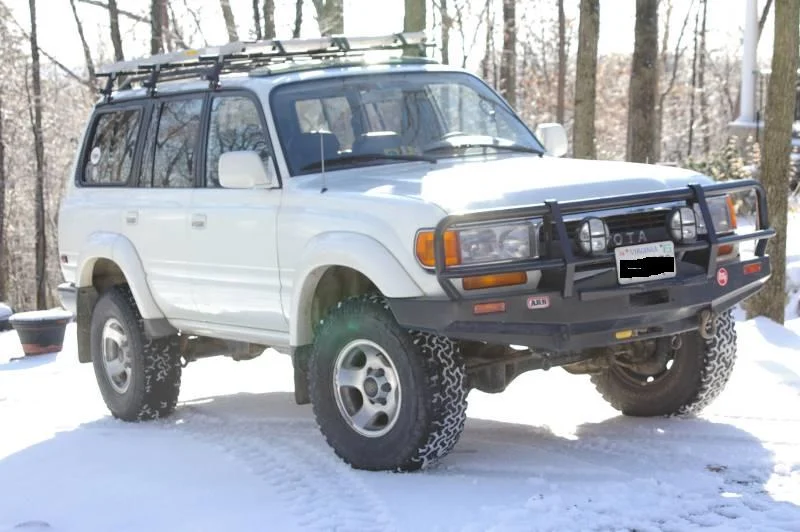

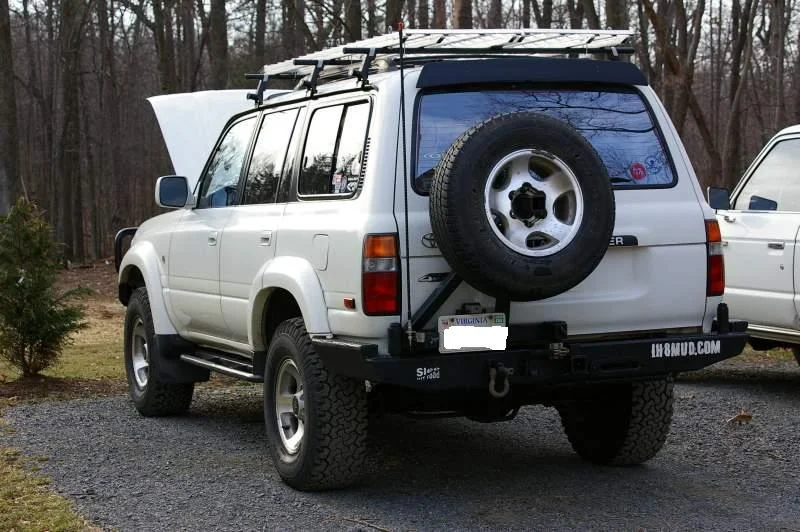

This is pretty much how the truck looks now. With roof rack, ARB, and sliders. As well as a previously posted river crossing.

Sweet rig Brandon and good write up. Love the sliders. You are gonna love having them. Now we can both go back and try the "Ledge" again.

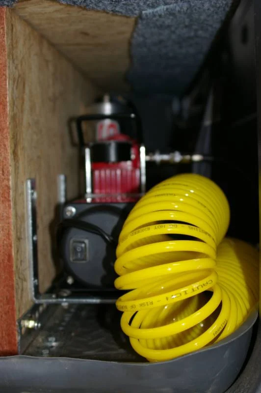

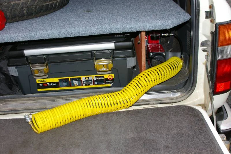

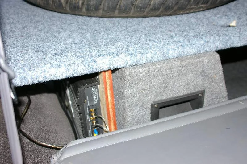

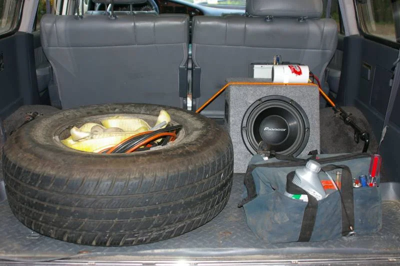

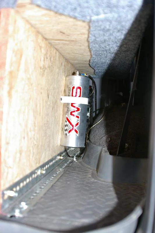

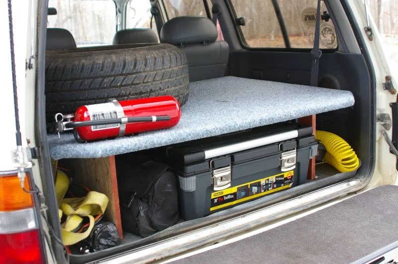

Afte the sliders were done i decided i would try to do some type of rear storage solution.
I shameless took Maddbaggins idea and built something very similar.
My rear shelf uses 3/4 inch plywood and the same home depot garage door opener tracks.
At first, i just painted the top of the deck with grey primer but quickly decided the addition of some carpot would be nice.
I went back to home depot and right when i went to purchase some standard grade grey auto carpet, they informed me i had to buy a 20 foot minimum.
Needless to say, i left. I drove around town to several places looking for some carpet to just do the job. At my final stop, in the very back of a small mom and pop hardware store, i hit the jackpot.
They had a huge role of heavy grade grey carpet. I have seen the outback drawer system that slees sells and felt the quality of the carpet. The stuff is awesome and looks to be very durable. The role of carpet i came across at the hardware store is almost identical. So i walked out with a huge piece and used it on the top of my deck.
With the rear deck installed, it served as a great mounting place for the Kenwood amp, upgraded 1 farad capacitor, and the small 12 volt air compressor i got on the group buy.
When building the deck i also made sure that the top was the same height as the subbox so everything would fit tight and not move around.

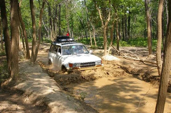

Very nice write up. The cruiser is looking great...amazing what a little lift and bumper will do for an 80. I assume that your little sis will come no where near it now?!
That river crossing is crazy!!! Now you need a snorkle

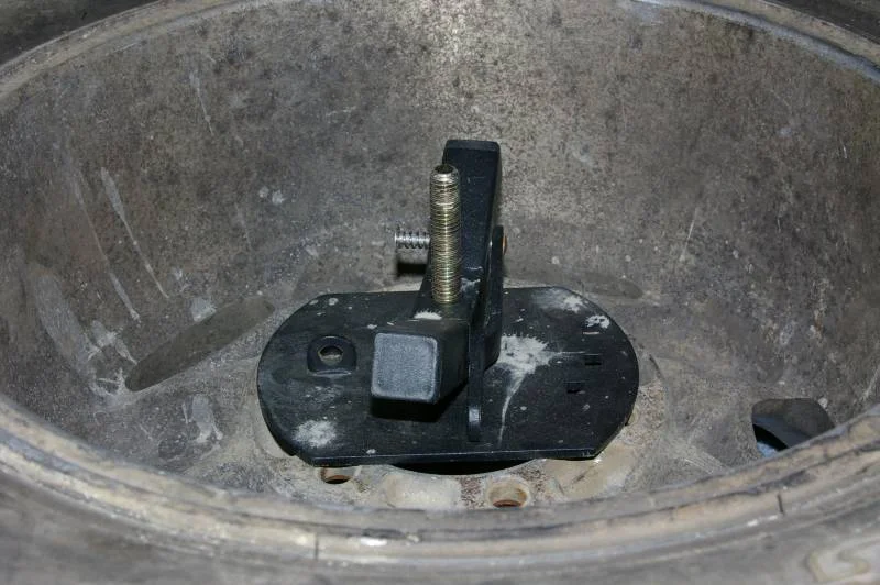

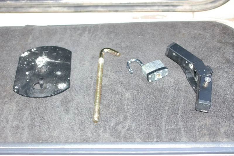

To mount the tire on top, i of the deck, i used a yakima spare tire mount, typically used on their roof racks.

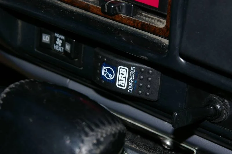

After mounting and hard wiring the compressor to the battery, i decided it would be easy enough and pretty sweet to have a power switch on the dash. So thanks to tony, i wired in an ARB compressor switch which now control the rear air compressor.
I also hated the somewhat short air hose that came with the comp, so i spliced in a 50 ft. coil air hose with an air chuck that can hold itself on the valve stem, so i can walk away from it if needed.

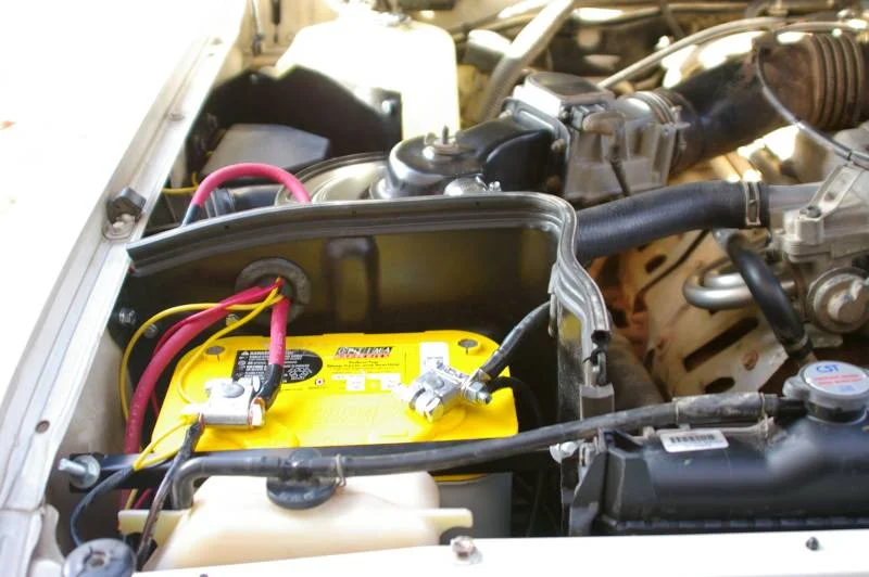

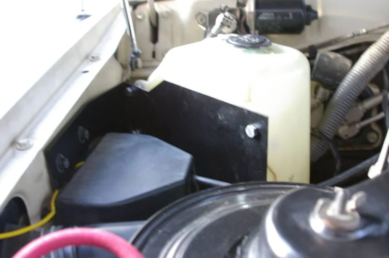

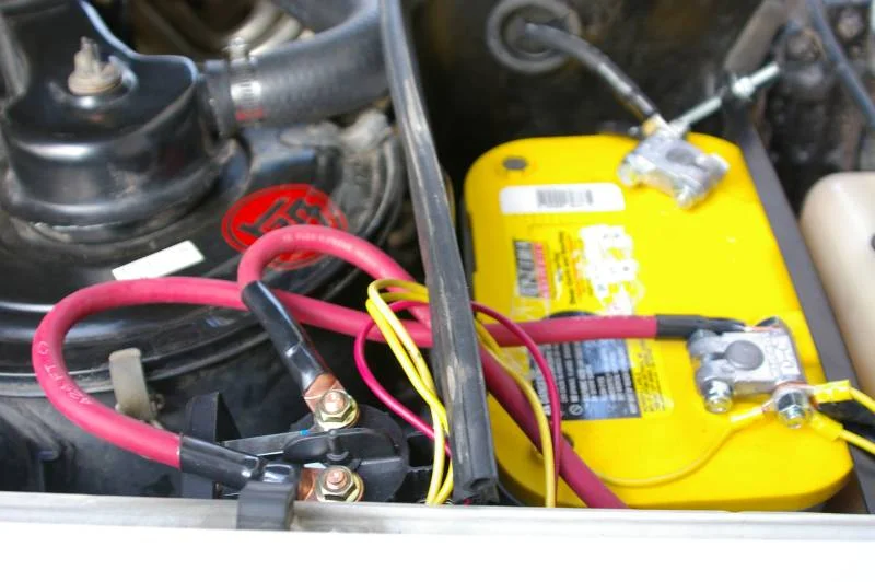

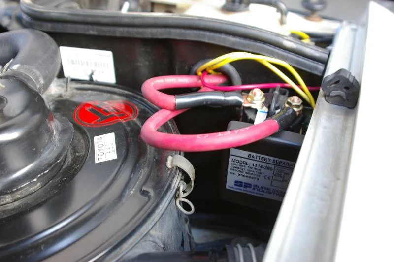

Alright, i realize ROTW's last for a week but i'm almost done, maybe i should have written it slower. Oh well.
As some may be beginning to realize, with the IPF's, 600w amp, alpine, eclipses, cb, maplight, and the recent air compressor.....my battery was started to feel things.
Next, i figured it would be a smart to invest in a dual battery setup. I am by no means an electrical wiz and while setting the entire dual batteries up seemed hard, i was gonna try and gather of the items and go for it. Right before i placed my orders for the seperator, switch, etc...I dropped an email to Lance, at Iron Pig Off Road.
Come to find out, lance is the only supplier i could find that would sell a complete dual battery system. So, i managed to work a deal where this would be part of my christmas present(i still had to pay half) and had lance get everything together. His kit included a plug and play dual batter wiring harness. Everything was pre-cut and terminated with brass lugs, as well as covered with heat shrink.
The initial plan was to have this at my door by christmas and spend a day installing it since its a very easy and clean setup. Turns out the Sure Power seperator didnt come in on time. Lance, to make it up to me said he would install the entire thing for free. I thought this was an extremely nice offer and as much as i wanted to install the whole thing, i drove the truck to IPOR and watched/helped him do it. The entire setup went in fairly quickly and was very clean. I hope to add a second fuse box to the washer bottle bracket as you'll notice is serves as an excellent mounting spot.

You'll also notice the dual battery system doesnt involve the typical 4 way marine switch and thats b/c the Sure power separator uses its own ECU. I'm still not 100% sure i could explain how the ecu works but it actually picks up the power signal from the cruiser control. Once lance and i had the entire setup in, he showed me with a voltmeter how after you cut the truck off, the solenoid separates the batteries once they reach 12.8 volts.
For more info, i'd definately drop IPOR an email as they are pretty quick to get back to you, maybe lance will even jump in here to explain the system further.
Overall, I'm thrilled so far with the system and i havent had a single problem with it. I am however still running a three year old diehard gold from autozone, but its works perfect and will probably stay there til it dies completely.

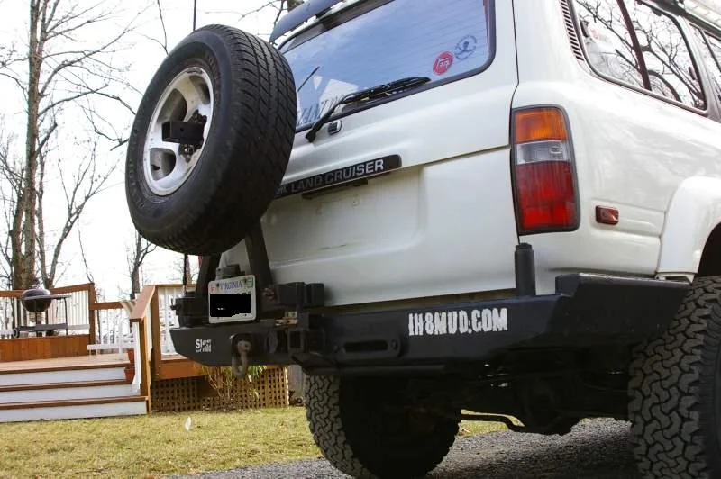

Lastly,
With a HUGE thanks to JUNK.....
I got his dual pivot rear bumper with integrated rear winch mount and tire carrier.
