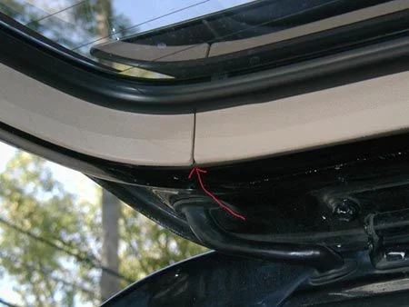

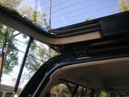

Rear hatch leak? Pics
I had the rear hatch open for a bit and some water drained out of the crack shown here- from inbetween the gap in the plastic trim.
The rig was sitting for several weeks and thru some rain so it obviously had a chance to collect. Is this a clogged drain or the dreaded rear window seal leak?
The rubber around the glass looks good, no cracks or seperation from the metal...
Is it possibly coming thru the spoiler screw holes?
ideas for troubleshooting welcome! Thanks

I'm voting rear glass seal. Mine was leaking without any obvious signs. Just like with the front one, it needs to be sealed with urethane all around from the glass and metal side and when the urethane ages, leaks start.

My recommendation is to look up the 3M site and see if there is a sealant in a caulk gun style. You may be able to run a bead around and under the rubber seal on the top and sides to fix this.

Washed the car today to relax a bit and spotted the leak. It is easy to see now.
as I wipe the car down, the water continues to dribble out of of one spot on DS bottom edge. I pushed on the rubber trim and it did 'squeeze' a few more dribbles of water out of the same spot.
I lightly pulled up on the black trim and could see the urethane under there. I think it might be possible to run a bead under there w/ a small enough tip and squish it down-I think a tube o' thane w/ pointed tip would be the ticket... Thanks for the idea, at least it's worth a shot.
Good pre-emptive strike I think. I dont notice any signs of rust or damage- hopefully the inside metal is solid (no bubbles or weakness pushing on metal), I think this is a very minor leak and I caught it early. knock on wood
oh, checked the spoiler bolts and no leaks there.
