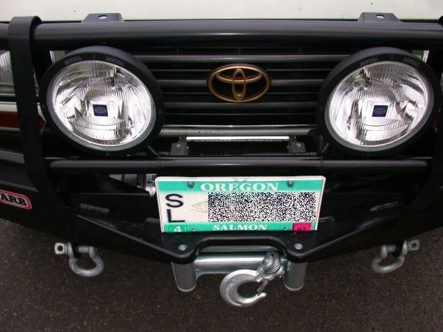

Here's a few shots:
In cool "city light" mode:

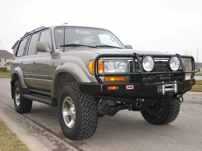

Attached is a pics of my Hella's in the ARB Bull Bar. I had to add one washer between the bottom of the light and the top of the bull bar tab. It is a tight fit, but it works great!

I will have to take some pictures tonight and get them posted for you. The light housing touches the top bar and I am unable to place my covers on the lights due to how tight of a fit it is.

in case no one mentioned.............yes Hella 4000s(full size) fit a ARB bar and yes you can fully adjust them, yes I think I needed to use a washer to bring the mount up a wee bit.....it wasn't rocket science

I just mounted my Hella 4000's on my bullbar and it was fairly straightforward. I redrilled holes forward of the existing holes, used 3 washers to get the light up a bit higher and it clears everything. The lamp does make contact with the top bar, but since the housing slides on its mount as opposed to pivoting, it is fully adjustable. With the 3 washers I can also put the covers on.

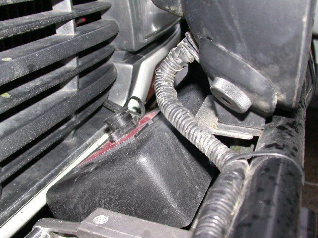

Here are some more pics for reference. As others have said, they will fit on the ARB bar but you DO have to drill holes closer to the front of the bar (closer to the weld on the tab) and raise the lights by inserting material (washers or whatever) so that the bottom of the light will clear the bottom bar.
I used flat bar stock on mine rather than washers so that the full base of the light would have something to rest on. They are VERY sturdy. They do hit the top bar but are still fully aimable due to the swivel bucket mounting system on the lights. They are extremely heavy-duty and rediculously bright. They are worth the extra work in my opinion.
Hope that helps.
