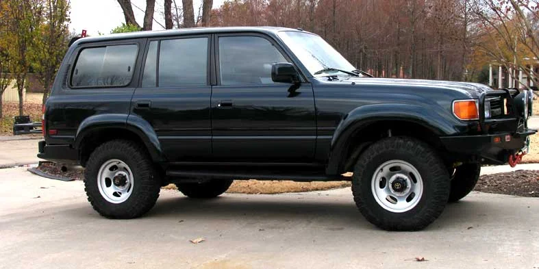

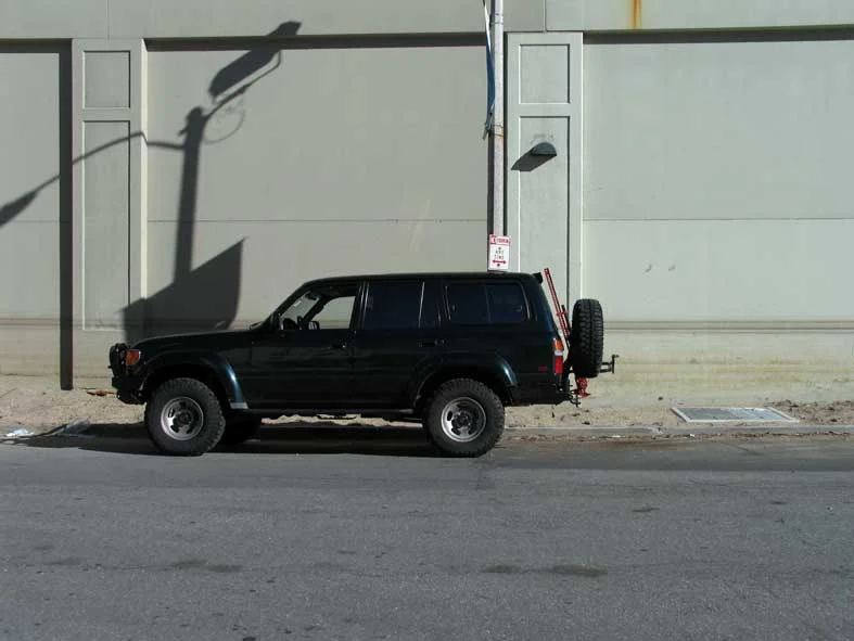

I purchased this vehicle in March 2005 from Meyer’s Auto in Harrisonburg, VA and brought it back to Mississippi. My desire was to make it an expedition type vehicle, wanting to eventually take an extended trip to Mexico and able to do some moderate off road use. It currently is a DD and has managed to take a couple of interesting trips.
The truck was a stock 1994 with factory lockers and about 120K on it when purchased. In the time since then, I have made a good number of modifications. The vehicle has been armored with an ARB front bumper, 4X4 Labs modular rear bumper (first one made), Slee step Sliders, Slee transfer case and AC dryer skid plates.

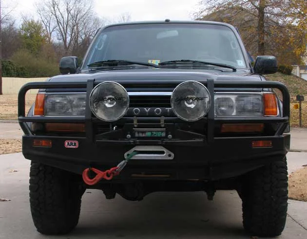

The vehicle has OEM CDL and hand throttle from Slee. Stainless extended brake lines, ceramic brake pads and DBA rotors have been added. I use Mobil1 5W-40 oil and mostly synthetic fluids. I have changed all of the usual hoses including the PHH, belts and typical things have been replaced. The starter has been CDan’d. The problem with the windshield wiper diverter has been corrected and the antenna has been replaced.
The wheels shown in these pictures are Toyota steel ones with Interco TrXus 285/75/16 tires. These tires have been pretty impressive, getting OK wear and surprisingly quite on the road. I have a set of wheels with the standard Michelin 275’s.

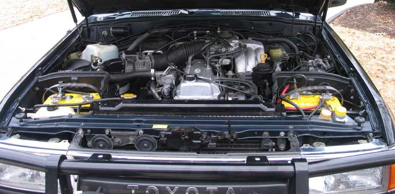

The dual battery system consists Optima yellow tops and a TJM IBS Dual system. I have a second fuse box located the passenger side seat. The system has multiple 12-volt outlets in the rear of the center console and on both sides in the rear. The rear outlets are useful for the Engle freezer.
The lighting system has been upgraded with the Slee wiring harness and the use of HIR bulbs for both high and low beams. The Lightforce Blitz 240’s use the Slee accessory harness and switch. The interior lights were replaced by George’s LED’s.

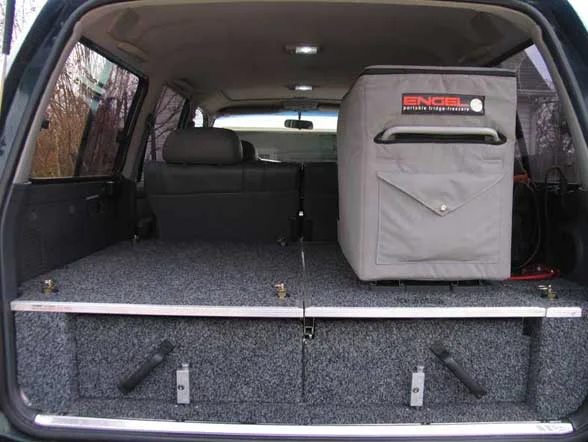

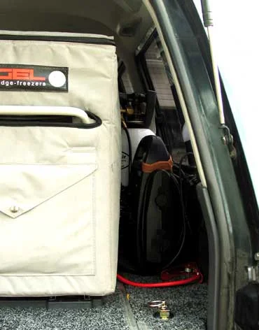

I purchased a Safari drawer system from Slee’s and have been very happy with it. It allows safe positioning of various items inside and attachment points for items on top. The sliding top on the right side is a convenient way to allow access to the Engles freezer, which is secured by a bracket from Slee. It also is the attachment point for the CO2 system.

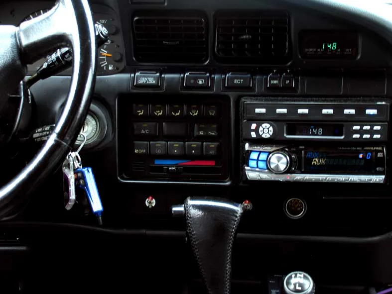

The factory radio has been replaced with an Alpine head unit and Eclipse speakers. The Alpine has a hardwired attachment for an iPod, is Sirius enabled and is also attached to a Mac Mini. Above the Eclipse unit is a retractable VGA touch screen unit that is for the Mac Mini. The Mac is powered through a Carnetix CNX-P1900 DC-DC Power regulator. The Mac is blue tooth enabled and is capable of picking up WiFi signals while in the vehicle. It Mac Mini can play and record DVD’s and is a fairly capable small computer. The Mac can be used instead of an iPod using iTunes. It is able to be used with a GPS, although I usually use a Garmin 2720 Street Pilot.
One modification that I found useful was replacing the original alarm system with a Viper system. It is easy to figure out if it is armed or disarmed.
The folks at Soundwaves in Memphis have been great to deal with and they took the headaches out of the installation of the stereo, alarm and Mac. They are about as good as it comes.

VERY NICE RIG!!! Very well done and thought out mods!!!
That is one very slick dual battery gauge thing, never seen that before!!
Also, i see you have the Alpine 9851 head unit. Same one i have, arent the iPod controls super cool!! 60gb of music all without touching a CD!
I want those wheels! Are they non US market or are they available here?

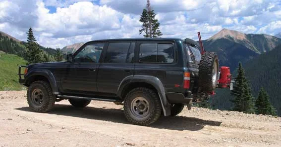

My Land Cruiser has been reliable and has taken me to Colorado mountain passes and to the back of Charity Hospital in New Orleans (note water mark).
I want to thank Dan, Christo, Luke Porter, Steve-O and the various mud personalities for helping to put this vehicle in order.

The dual battery system is from TJM and was bought from 4x4Connection. It was an easy install and so far has done well.
http://www.tjm.com.au/master_framese...batteries.html
The wheels are official Toyota steel and can be gotten from CDan for just a few gold dog bowls!
The iPod capabilities are great with the Alpine unit.

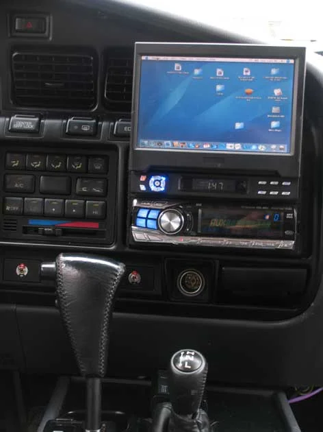

So are you able to control the mac through the eclipse touch screen? That is very cool, do you also hava keyboard/mouse?

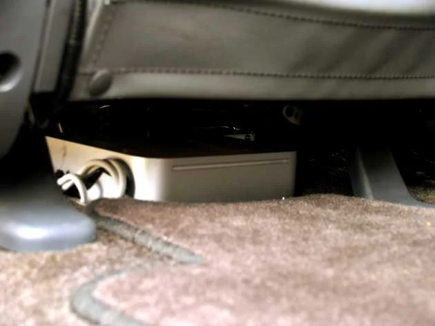

I am able to control it through the touchscreen, but you really need to have a mouse and a keyboard. I thought that a Bluetooth keypad/mouse was the way to go. I went through a good number of batteries (they always go out at the wrong time) and will be going to USB for both. There is a USB/Firewire hub that apparently designed for the Mac Mini by Belkin and that will be added to keep some spare ports available.
The touchscreen was off Ebay and I can't remember the manufacturer.

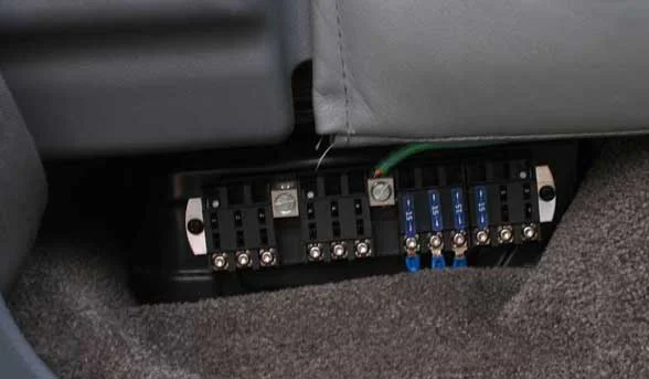

What brand of fuse block is that? Where did you get it? Did you install it on the passenger seat bracket?
This is the same one that Slee uses. I called them up, asked what they used and they sent me one. Very good people.

Very nice setup. Do you use a bluethooth mouse and keyboard with your on-board Mac Mini?
Have you tried MacGPS Pro?

RGSIII,
Just curious, why the dual yellow tops as opposed to the typical yellow/red top system?

Originally Posted by Cruiserhead05
RGSIII,
That was my original plan. I bought a yellow for the auxillary battery and was using a regular battery as primary. I fully intended to get a red, then somebody just gave me a deal on the second yellow. So far no problems.
__________________
