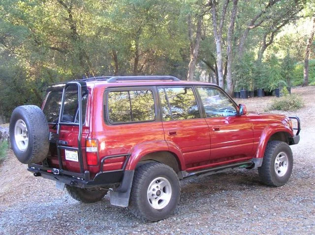

Here's my current homebuilt rear bumper. This is the second rear bumper that I have built for my LC80 as I am a novice weldor and learning as I go. I built both bumpers with a Lincoln AC/DC stick welder and used 3/16 inch steel except for the mounting points which are a bit beefier. The tire carrier is still in progress but will work on wither side and the spindles will be removable. Building these was a great learning experience and I already have some changes in mind for the third rendition.
Cheers

------96-FZJ80 the snowchasing, gear hauling, mountain machine--------

I've been pm'ed for a few side shots so here you go. Sorry no pics of the build I kept forgetting.

Very nice SnowCruiser, the removable spindles are a great idea.

snowcruiser thats a good looking bumper. got any pics from below showing how you hooked it to the frame?

No pics from the underside but it is pretty straight forward. I used 1/2 inch angle iron coming straight off of the frame and through the face of the bumper for tow points. These bolt where the factory hitch bolted at the rear and then through the vertical sides of the frame as well but probably unecessarily. The wings are supported where the factory hitch bolted in the front by seperate very heavy duty brackets made out of angle iron and gusseted square tubing. I made these front brackets first and bolted them to the frame and then bolted a plate to these that I then welded the wings to and then tied it all together in the rear. This allowed the bumper to be slid on and held in place by itself before attaching any bolts. I can try to get some pics later this week.

Yes snowcruiser. That looks nice. More pics and details, please.

How did you cut all the pieces of steel? That really looks like a professional design.

Believe it or not I cut most of the steel with a 18 volt Sawzall as my Plasma cutter was out of commission during the build. Milwaukee "The Torch" blades are pretty good with metal so it was not as bad as it sounds but I went through a lot of these and a few grinding wheels as well. I was able to fix my plasma cutter towards the end of the build which helped with some of the arc cuts. Next time I will plasma the whole thing as it is probably 10x as fast.
