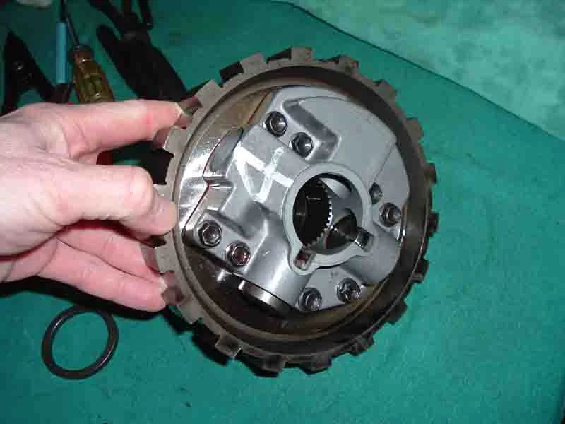

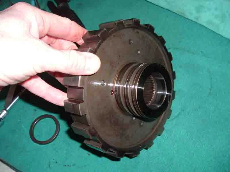

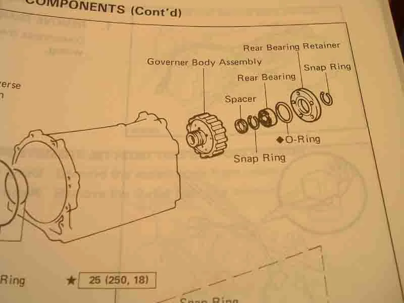

I will include some pictures below for your reference for you to understand where the governor is located on the transmission and a pic of the governor.
While changing the trans fuild is good, it's not going to tell you if the clutches have degraded. You need to drop the tranny pan on the next change and examine the bottom of the pan. You need to look for black material in the bottom of the pan. This will tell you one thing, that the clutches have degraded to the point where they MIGHT have to be changed. This is a complete tranny rebuild if this is the case.
BTW, keep a clean envirnoment while the pan is down, no wind to blow dust or sand up in the tranny.
Throttle cable: sounds like you have that covered.
Governor: below pic shows the location. To take the gov. off you need to take the transfer adaptor (transfer adaptor for the transfer case and the tranny) off the tranny. Here's the order: Tranny, transfer adaptor (which supports the weight of the tranny and transfer case ie center support bar) and the transfer case.
Valve body: This can be taken off directly from the tranny once the pan is out fo the way. It's your preference to have the dealer rebuilt the valve body but I would have a tranny shop do it.
