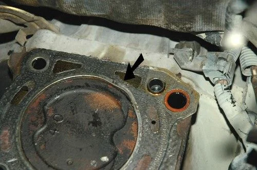

I shoud have waited a few weeks. My head gasket failed and blew out at the rear water jacket on cyl #6. Now that the head is off it's very easy to get to the PHH!

Looks like the typical deformity of the #6 sealing ring that I and others have seen. I have seen a marked improovement in how my engine runs since the gasket. Let us know how thing s work out.
Luckily I got to my gasket just as the ring was starting to seperate from the gasket, got to it just in time.

Can someone confirm that the bolts used on the PHH are 12 mm? If so, I am in luck, as I had a shop do some of the baselining work when I first purchased, and the unfocused lad who worked on it happened to leave a 12mm ratcheting box wrench sitting on the battery, as well as the idler pulley he replaced. It sounds like this is a handy tool when performing PHH replacement.
I figure the wrench was compensation for the worry I was left with after finding these symbols of absentmindedness by those I entrusted my new member of the family to.

Success!
Data Point: Upon visual external inspection the hose had no signs of leakage. But seeing as how I'm going on a 16 hour trip in the next couple of days I began to get that "nagging" feeling that I'd better change it now in the relative comfort of my garage. After all, why risk it? Reading posts on this forum that included horrid descriptions such as, "Bursting" and "Exploding" PHH's, certainly had an impact on my decision. The entire process took me about 4 hours from start to finish. This includes draining the rad, block, jacking up the vehicle, removeing the wheel, etc. I'm 5'9" and my forearms are average sized I guess, smaller and longer forearms would certainly be a plus for this task.
One more thing, I WAS in fact able to get a Dremel pencil extension in there with a cutoff wheel and cut through the first and part of the second clamps. This cut down on a lot of aggravation. One issue is that the wheels themselves are seemingly delicate and I broke more than a few just trying to get it into position.
I used standard Heavy Duty heater hose and used standard stainless steel hose clamps. I have no doubt that this will hold up for another 8 years without issue. No need for all that fancy smancy aero-space gear. In the event I have to replace it again - the worm gear hose clamps will be relatively easy to remove.
Bottom line - take your time and, you can do it. This IS NOT a hard task - just very Time Consuming. Whoever is reading this and thinking about undertaking this repair, just give yourself enough time and you'll be fine. Good Luck.
