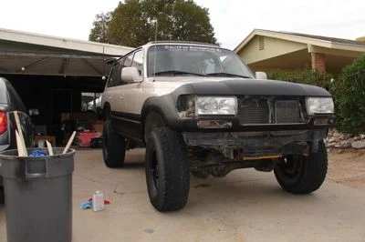

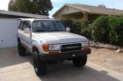

Durabak-ed my 80 this weekend
I had been wanting to do it and after seeing concrete's thread I went for it. I scratch the hell outta my rig and don't care to buff it. I've got a lot of small chips in the paint on the lower end also so...
I bought 2 gals of black textured. 1gal non-UV and 1gal UV resist
The first 2 layers are with the less expensive non-UV then a heavy final coat of the UV resistant.

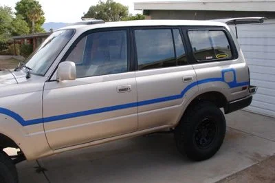

First I laid down electrical tape to get the contours and the basic outline. Then 2 layers of masking tape on top of the elec tape.
I removed the front grill and turn signals/marker lights, and the front and rear bumpers. Buffed the whole thing up with 80grit cloth, wiped it down with xylene and applied the goo.
GeoRoss came over to help, thanks a bunch Ross!! You get first dibs on my leftover Durabak. I have enough leftover to do about what I did again. I bought 2gals because I didn't want to come up short and have it 1/2 ass done.
some pics with more to follow

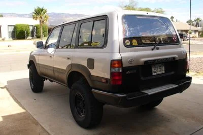

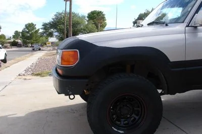

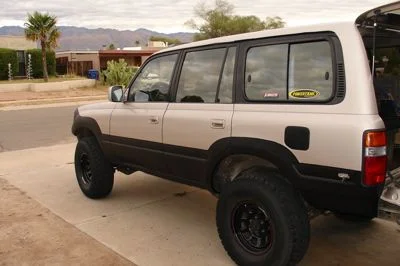

Couple of shots before I buttoned it all up

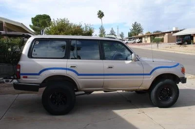

Looks great! How long did it take you from beginning to end for prep and everything? I am thinking about doing something similar to this sometime.

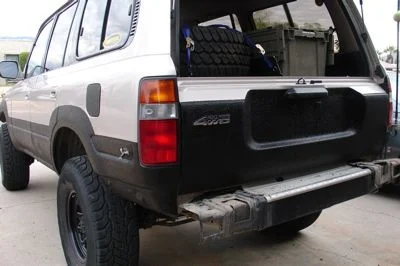

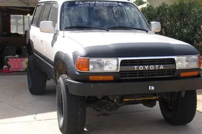

And the final results

I'd call it a 2-day project. I spent about 3 hours applying tape and making sure I had the contours right. Then a couple more hours removing stuff and some more tape. A good hour with Ross and I sanding it down. Took about 1/2 hour to apply each coat, but you have to wait at least an hour between coats. Then I peeled tape after dark, woke up this morning and did some touch up, finished peeling the last layer of tape and cleaned up the edges with a razor and a little xylene.

Interesting approach. I'm not sure i'm a fan of the rear door being covered, but the rest looks pretty darn good. What do you think about the product? I thought after 2 or 3 coats it was nice and thick, just like linex.

I like the stuff, pretty easy to work with and clean off mistakes. It is thinner than I imagined and the first coat showed a lot of the paint thru. Even after the second coat I could still see some paint in places, but the third coat did it.
At first I hadn't thought of doing the tailgate, but Ross mentioned it and I thought for a couple of minutes and realized it would complete the circle around the rig. I already went around the front, so going around the back just fit. It looks awesome, I'm very happy with the product and how it turned out. Now we just have to see how long it will last, I'm wheeling tomorrow-first test.

why 'd you do the hood?

Posts: 1,270
Looks great!! I was planning on meeting you all tomarrow but the wife is too close to giving birth and will not let me out of her site...have fun.
