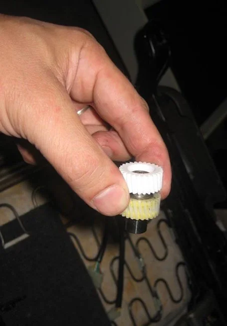

Quote:
Originally Posted by PScottBx View Post
Thread revival...
Nakman.. you have a new gear on the way.
Courtesy of Theriot
Bx
back at ya, buddy...
the gears are looking good.. http://forum.ih8mud.com/80-series-te...ue-pt-2-a.html

I just got my plugs in the mail. At first I thought the material was styrofoam or something but it is really sturdy. Look great. I will let you know how it goes.

Well no luck unfortunately. The plugs fit perfectly but both seats are hosed. The DS tried to move one side and then just started spinning. The PS only moves one side back and forth still...but am going to take a closer look at it his afternoon.
On the DS I think I may have messed it up by manually screwing the seats back when it first messed up. I heard a little bit of a crackle.
If anyone knows of the parts I need let me know. Or I can ask CDan and see if he has any ideas. I may take the PS power seat stuff appart and see what looks broken.

Yarborg check out the "gear swap" thread, it'll show you how to take it all apart. If your damage is limited to the gears then we may have a solution for that.. hopefully that's all there is.
