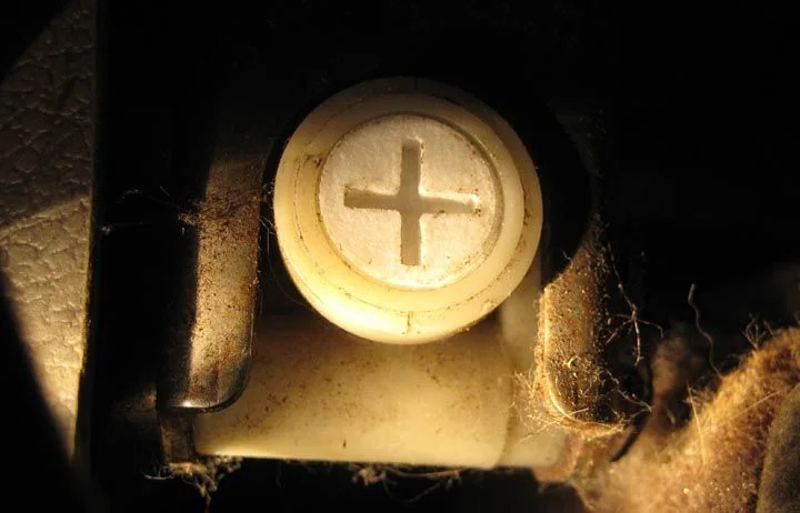

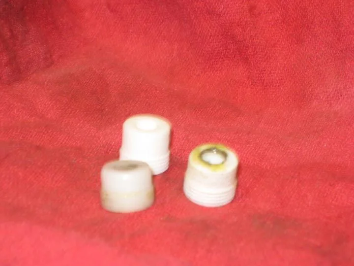

Haines that is cool, thanks for posting pics of that. hopefully most of you only need this little cap.. but good to know nonetheless. And nothing wrong with calling Irbis, those guys are great!
Ok the first prototype is done, and seems to work. However there are a few tweaks that could be done to the design though to make it even better, so I want to do one more test before I try to sell these.. shouldn't take long though. noting major just needed the small hole opened up a little and a quick trip to the belt sander to get a little shorter... the next file should nail it.
Here are your pictures, sorry for the poor focus in the second pic ..

The one on the left is the stock one.. on the right is the new modified one that was installed in the pic above, and the one behind them is another new one.

If you are lucky, all you will need are the plugs. However, after I installed them, my seats moved forward/backward a little ways, then would mostly move only on one side. as if they were "Off track".
What actually happened was that one one side was actually working now. The opposite side (side with the motor) was still not working fully. Sometimes it would work momentarily, but upon closer examination, it wasn't moving.
I'd ordered a new housing long time ago, and had it on hand. It would be an easy fix for the driver's side.
But the passenger's side needed both the HOUSING as well as the other side. Bad part is that the other side is sold as ONE UNIT AFAICT, and is around $300.00
At any rate, I disassembled both sides and made a discovery: The internal plastic gear on the motor-side is the exact same as the one inside the HOUSING. Therefore, you should be able to order just the housing and use the internal gear for the other side, provided your motor is in good working order.
I plan to purchase another HOUSING for around $68. A total cost of around $150 to fix both sides provided you just need the housing (i.e., at least one side works on each seat).
It would be great if we could source the gear alone...
