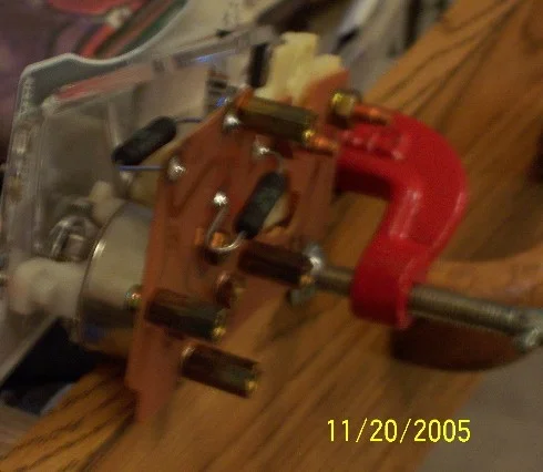

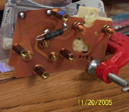

so comming up on 3 weeks now, no body has tried this yet?
Some interesting results. even in GA fall weather the temp in my 80 does have some spikes, biggest was with the AC on sitting in a fast food drive through on a hot day (low 90's) . about 205F, in traffic with lights temps often come off of the middle and raise up to about 200. heavy accleration on to on ramps makes for a small spike.
also does anyboady who has hosting be willing to host a large animated .gif of the gauge sweep? could be about 10MB

I'll be trying this mod this weekend. I got the parts in last Tuesday but I had to go to Surf N Turf so I wasn't able to try this out this past weekend. I'm really excited about being able to modify the guage so it works. When I went to Colorado and back about a month ago I constantly had the AC on so that I could tell if the truck was over heating. I'll be glad when I don't have to do this.
Oh yeah forgot to mention I could host the image.

I've been driving around with mine modified for quite a while. Nice and stable. I've only seen small variations so far.
This is probably the "BEST BANG FOR BUCK" mod to date. I can't imagine why anyone would put this off.

have parts in hand- just trying to find an extra 3 hours...
is that a good guess as to time for a moderate to good mechanic and solderer?

I could do the whole job in an hour, but I've had it out before. 3 hours is plenty enough time even if you have 2 left hands.

I've got the 93 gauge back now from the combined efforts of Canada and US postal services and need to get it sent back to Raven. I would say if you are not patient you could just try the 95-97 mod. The gauge looks almost identical and we know the stock resister is the same rating as 95-97 and the diode looks the same.
that said, I would like to be sure so I am very appreciative that RT is willing to test it for me

Darwood good deal, it is comforting to have solid anwser of what your temperatures are. on a trip to florida in september I swapped in one of the early beta gauge mods just to have soemthing for that trip. that mod wass 100% functional just to sensetive, it had big movements for small changes in temperature.
let everybody know how it goes, I think some may not want to be the first to try it.

The 3 hour estimate is well padded. but take your time not a race. tinkering in the garrage having a few sep #6's is good for you.
-B- and Darwood thanks. I will be contacting you guys, I already have a "before" .gif. I have the after mod stills but they are awaiting conversion into the "after" animated gif.
Hey Semlin let me know when you want to ship it, I'll be ready. I suspect that the mod will be the same but there is only one way to confirm.

Well, I joined the club today. Your directions were excellent RT.
I could get the desoldering braid thing to work very well. It just wasn't heating up enough through the braid and absorbing the old solder. I didn't have a drill bit the size of the Zener Diode leads so I used a bobby pin to stick in the holes and widen them up a touch. Everything seemed to go very well, an it looks like my gauge is operational.
Thank again for all you've done on this mod!

Nice work R2, looks good
I like the clamp up method. Looks more secure and supports more of the board, just don’t clamp to tight. I used the disordering bulb, I was not much for it but it worked, I thought the braid might work better but aparently not. Maybe your soldering iron was not large enough to heat that much mass?
Thanks

Definitely. I clamped it enough to get a good bit, but that's it.
Probably not.. maybe pour technique too . I got a 40 watt soldering iron... $8 Radio Shack special. It was heating up the braid enough to burn my fingers a couple of inches down the braid, but for what ever reason, was not melting the solder and drawing it through the braid. There really didn't seem to be a whole lot of extra solder on that factory connection anyways. So I heated up the solder enough to pull the old leads through, then reused what was there and added a bit for good measure. I'm no solder expert, but it seemed to be a good connection once it was all said and done.
