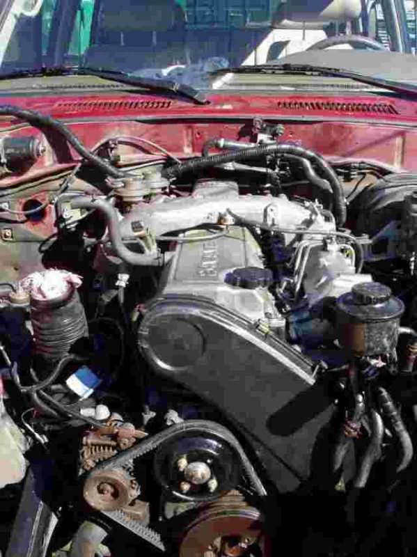

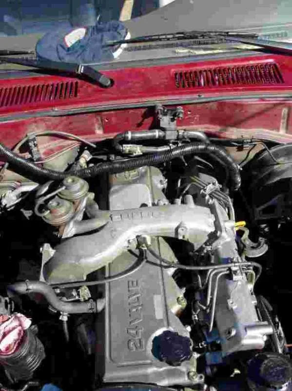

More
More
cruiseruser is offline   Reply With Quote

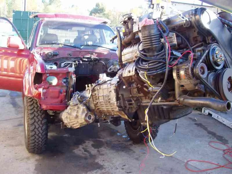

Some more.
Some more

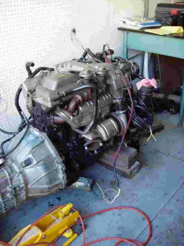

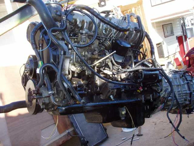

More
More
