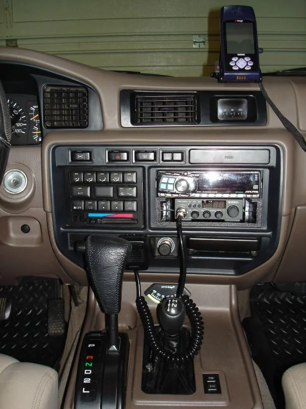

Some Exterior Shots, Sorry You Cannot See The Purple Mountains Majesty In Back!

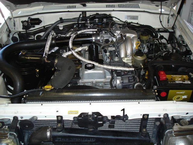

Some Engine Snapshots...

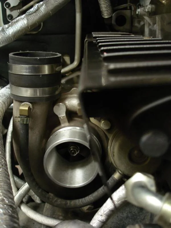

Some Turbo Shots ...

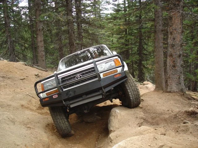

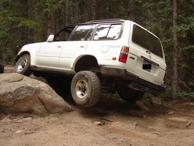

Some wheelin shots ...
__________________
97 FZJ80, Locked & Loaded, Safari Turbo, Safari Intercooler, Ceramic Coated Custom Exhaust, Ron Davis Racing Radiator, OME HD 2.5" Suspension, DBA Slotted Rotors, New Toyota Calipers All Around, Toyota Pads, 33" Revos, ARB Front Bumper, Center Diff Switch, Slee Stuff: Roof Rack, Step Sliders, Skid Plates, SS Brake Lines, DC Drive Shaft. HG PM'd, 9.5psi and climbing, My Rocky Mountain Mojo Mobile!
turbocruiser is offline   Reply With Quote

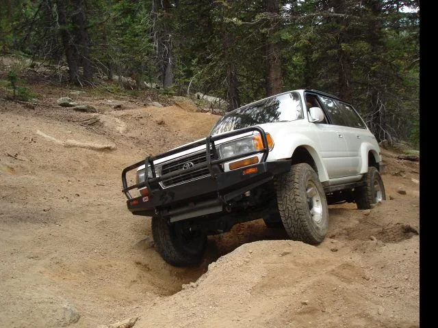

Some more mild wheelin shots ...

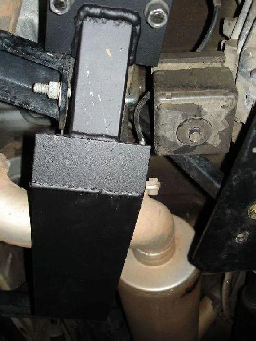

Quote:
Originally Posted by cc93cruiser
Hey turbo'.. can we see pics of the Self Made Super Strong Exhaust Skid Plate later on when you got some time??
Sure, ...
