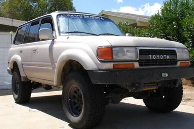

I think my ROTW starts tomorrow but I will be to busy to do this then. So, without further ado:
My rig
94 LC with 125k on the clock
I bought the rig last June with just under 114k on the clock and she was immaculate inside and out. The inside is still really clean but I have scratched and dented the outside pretty well. I do wash her quarterly whether she needs it or not. She had spent a good part of her first 10 years being towed behind a big RV and not wheeled much.
When I got it, it had a cheapie roof rack that eventually lost a battle with a tree. No more roof rack for me. It had a fugly front bumper and it was on 285 MT's. other than that it was totally stock.
Now that I started making a list I realize I have done a lot of little things so here it goes
Maintainence:
engine oil- Mobil 1 15w-50 with Toyota big filter
diffs and transfer case- Mobil 1 75w-90
tranny- Mobil 1, dropped the pan and cleaned the screen
air filter- Toyota
plugs, plug wires, dizzy cap and rotor- Toyota
PCV valve
PHH replaced (after it blew )
radiator flush, new t-stat and hoses
birfield repack at 121k
front caliper rebuild, complete brake system flush
Mods and Accessories:
2.5 OME heavy lift from Slee
xfer case skid plate from Slee
extended SS brake lines from Slee
custom front bumper http://forum.ih8mud.com/80-series-tech/46827-az-no-bull-bar-bumper.html
extended diff breathers
Optima red top
Hawk HPS front brake pads
285/75 r16 Yokohama Geolander AT's on black steel rims
homemade front sway bar spacers http://forum.ih8mud.com/80-series-tech/44699-homemade-front-swaybar-spacers.html

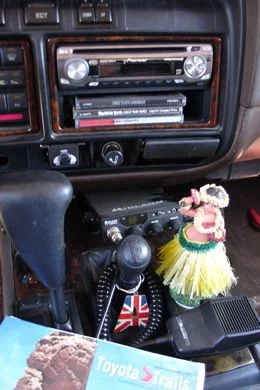

Midland CB with Firestix antenna
Center diff lock switch with pin 7 mod
2.5lb extinguisher
Co2 tank

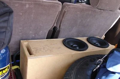

Pioneer sat ready CD player with Planet Audio door speakers, Planet Audio tweets in dash, 2 Crossfire 8" subs in custom box, 700w 5 channel Planet Audio amp/crossover with bass remote
Hi-lift
Sold the 3rd row
Future plans basically in this order:
Custom drawer system to enclose my sub-box and cleanup the back end
Custom rear bumper with swing out tire carrier
Custom sliders
remove fender flares and Rhino the sides
Sat radio
dual battery set up
fridge
new front seats, maybe Carbeau(sp?)
Warn winch w/multimount for my front and rear receiver
ARB lockers
snorkel
I love this rig and I enjoy working on it just as much as I do wheeling it. Look for me smashing my rocker panel in the Land Cruiser documentary

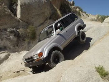

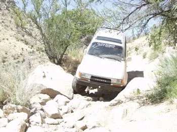

Here are some pics of Toto

CB and stereo pics

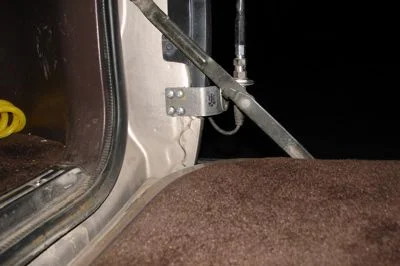

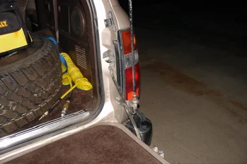

NIce rig, could you post a photo of the antenia mount, I think we did the same thing

One thing I will say is that pictures do not do your front bumper justice. It is a really nice one. Hint hint

some more pics of the CB antenna mount. I ran the coax under the carpet to the rear passenger quarter panel then out thru a small notch I cut at the bottom of the taillight.

Thanks, we are very simular in the way we mounted the antenia

Love the color

Cool color! I wash mine about once a year since the color hides dirt really well.
What kind of steel rims are your using?

1) Nice front bumper, I really like how tight in fits!
2) How do you like the Yokohama's? I have been thinking about getting a set of those or Toyo AT's.
Can you relate the to another tire in terms of wear, road noise, etc? Such as a BFG AT?
