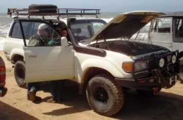

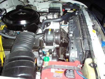

Okay, here's the deal. These are a few pics I've had kicking around. I'll post more on Thursday. It's a crazy week at the office.
92 V8J80
Engine Stuff:
350 tbi Chevy mated to A440F with Advanced Adapters Plate
Late 60's Chevy Corvette RamHorns exhaust manifolds
Fat HEI ignition
dual electric fans on aftermarket metal top radiator
(this will be replaced with a Ron Davis Dual Pass / Dual Fan unit shortly)
High Performance starter
cross over exhaust tied into a Magnaflow muffler
Summit Racing Mechanical Oil Pressure and Water Temp Gauges
Raised breathers for T-Case, Diffs, Tranny, etc.

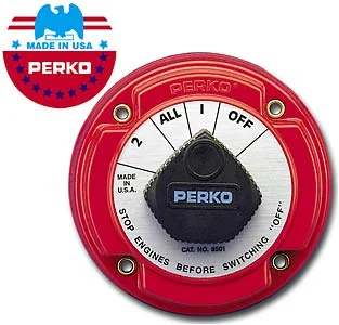

Dual Orbital Batteries with Perko Marine selector switch
Safari Snorkle
ARB Air Lockers Front and Rear
Suspension
Ome 850 / 863 with OME N73/74 shocks
OME steering stabilizer
1" Mr. Tuffy spacers up front
Wheels
American Racing black 15 x 8
Pizza Cutter mud terrains siped 33 x 9.5
Protection and Stuff
ARB with Warn 8k (traded a free nail gun for the winch )
Full Length Kaymar Tradesman Rack
Hella 500's
Recovery Stuff
50 ft. 3/8" grade 60 chain
40 ft. 3/8" grade 70 chain
60" HiLift
Rescue 42
Husqvarna Rancher 55 chainsaw with 18" bar and commercial chain
4 screw down shackles
6 Ag shackles
3- 30' snatch straps
1 Warn Snatch Block
A bunch of SAE and Metric tools
Military Issue folding shovel
18" Flares (12)
First Aid kit
Fire Extinguisher
40 Channel Cobra CB with 4' Firestick antenna
Cool Stuff
It's paid off
Limo Tint
Lived in interior
Stock Mud proof floors (they wash right out)
Chicks dig it and guys want one
I don't rock crawl, so I haven't bothered to make sliders yet. I am more into overland expedition stuff. Going slow sucks. I have a Lincoln Pro Mig 135, and plenty of steel lying around, but I haven't built sliders and a new swing-away rear bumper yet. I have 2 new 4x4 Labs spindles/pivots sitting in the box with the latches for when I get around to whipping something up.
I have put 15k on the engine since the swap and it's awesome. With the fuel costs though, even though I went from 10 mpg up to 14 mpg with the 350, I still want a diesel. The adapter and the mounts are the same for the 350 / 5.7 and the 6.2 and 6.5 engines. I'm looking around for a 6.5td so I can start brewing biodiesel. It should be an easy drop in to replace the 350.
California requires that the original diesel fuel tank and lines have to go in too, so I will likely up the fuel capacity from the stock 25gallons up to 40-50 gallons. Biodiesel costs .40 a gallon to make and I have a supply availability of 200 gallons per week. Sweet! 200 gallons for $80 will be cool. It beats $3.00 x 200 = $600!
Anyway, this thing kicks butt. I wash it with my powerwasher at least twice a year out of consideration for my neighbors unless it's super muddy, then it gets a bonus wash. White paint rules. It is a work truck pure and simple. I have to drive offroad everyday and typically in 10" dust and mud dependent on the season. I've managed to keep it out of water deeper than the door handles and it's never had any major issues. I've used it to work in Construction, Agriculture, Archaeology, and Safety. I still do most of these things simultaneously. The dual ARB lockers are worth having. I've never gotten stuck too deep where I've had to winch out, I've always driven out. Of course that sometimes takes a half hour or so....

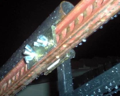

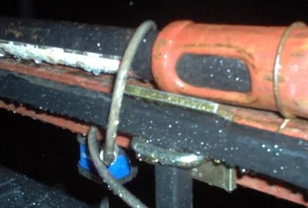

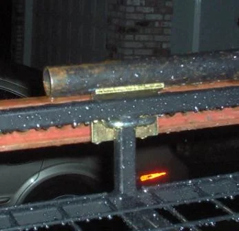

Another Cookie shot and my $7.00 bulletproof, custom conduit brace, HiLift / Kaymar mount.

Very nice rig, I love the space in the engine compartment it seems so spacious and easy to work on. If you have a pic of the dual fans I would love to see one.

Looks real nice. I like white trucks. Damn that's a sweet looking engine bay. So you got any good action pics?

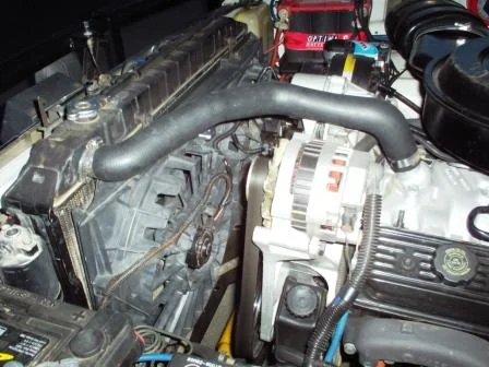

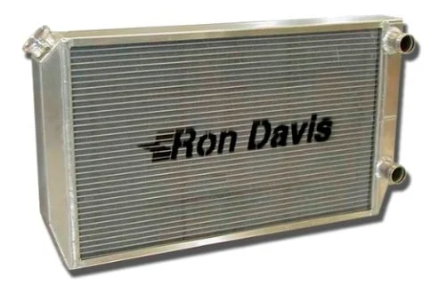

Ask and ye shall receive...
This setup will soon be replaced with the $700 Ron Davis beauty.
Dual pass with dual electric fans. Super cool for sure.

You not the only one Nice 350 by the way, are those Nology plug wires? How big .mm? Can you tell any different more power or just the same?

Nice. That 350 looks good in the bay.

WOW. The 350 looks great. Very clean install. Did you do the engine swap? If so, what did you think of the AA kit? Could you get some pics of the exhaut routing?

Very cool Shark. How much room do you have between the rad and the water pump/fan pulley? Could you have used an engine fan and shrowd?

Nice rig! What are your using for the dual battery isolation?

Quote:
The 350 is shorter than the I-6, and the mechanical fan is gone, so I have 4-5 inches dependent on where you measure. I could have used a mechanical fan, but having plenty of electricity available allows me to drop the mechanical fan to pick up some horsepower.
Perko Dual Battery Switch
Features include: heavy-duty copper sweep contacts, positive click-stop on all positions and built-in skirt to protect connections. Works on all 6-, 12-, 24- and 36-volt systems. Rated at 250 amps continuous, 360 amps momentary.
http://www.cabelas.com/cabelas/en/te...equestid=63857
