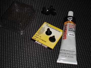

Removed roof rack and patched holes with black nylon auto fasteners and black silicone sealer.

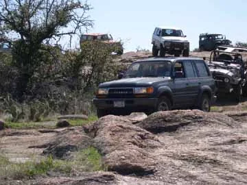

Ok one picture to show that STOCK trucks CAN wheel!

That picture is at Roundup this year on the Aggie Highway...
That was BEFORE I trimmed the flaps and did the side blinkers. I will post close ups of those this afternoon...got to get to work!

And the "roof rack feet" fix...nice and low profile.

where did you get the supplies for your roof rack fix and do you have part numbers?? Thanks

I got these at autozone...they can be aquired from any auto parts store...
The plugs aka auto fasheners are Body-Tite! #45680 Chrysler/Ford/GM and the silicone is DAP Gaskets 100% Black Silicone.
During removal of the roof rack I also removed the nutserts. Most popped out through the hole in the roof skin with very little effort.

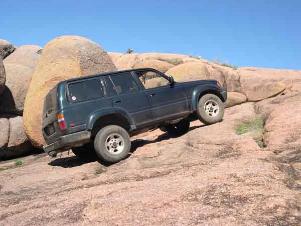

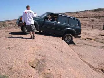

Couple more action shots...

I like the roof rack fix...may I steal your idea?
How did you remove your nutserts...just yank 'em out with channel-locks, or something???
