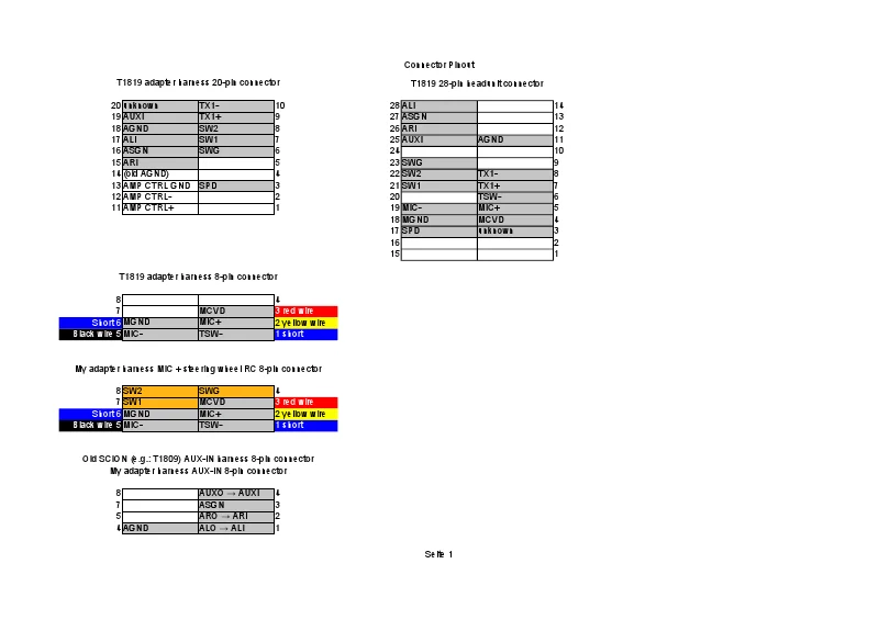

nope not a plug and play, you need the conversion adapters. I actually just cut off one of the connectors going to the amp located on the passanger side and used that along with the connector from the sub wiring.

I used the adapters from this thread http://forum.ih8mud.com/80-series-te...up-thread.html

The prius usb jack I used has an aux plug in it, with an 8pin harness connector hanging off of it (5 pins used). I'd like something that will go from that to the 20pin harness connector that aux runs through...
I need to find that 20pin harness connector... probably need to go to a parts yard and cut one out of a late model camry/yaris/scion with steering wheel controls. I don't mind cutting off the 8pin at the aux jack and hardwiring that, but I want to use the factory 20pin connector so it can unplug

I would like to get the steering wheel controls as well... Yea I lucked out mine came with all the wiring.

The mic I ordered from the dealership, PT546-74120-MC, works great, it was a direct plug-in.
The mic portion is designed for surface mount, it has a sticky backing, and the kit comes with some zip ties and sticking bits... I think it is designed to be surface mounted to the dome light, installed above the headliner.
I was much more lazy than this, I just stuck it to the steering wheel cowling above the key cylinder and routed the cable behind the dash that way.

If I was starting over, I would cut into the adapter harness, which is PT546-00120-US, and hardwire a USB socket, would've saved myself $80. Also the prius kit i ordered from them is now out of stock.
I'm betting that if you call up the guys at trdsparks they'll be able to get you that adapter for about $25 (i suggest them because so far they've given me the best prices of all the various dealers)

OK I figured out im missing the 28pin harness. Does anyone have the pinout on that so I can try and rig something? Thanks!

I ordered and just received this mic. I'm missing something because it is not a direct plug in to the T1819. Apparently there is an adapter between the plug and the radio I am missing. Any Ideas on a Part No?

The part you need is PT546-00120-CH. I am having the same problem but i wanna try and do it without out it but am having trouble sourcing the pinout or even pictures.

Email me and I will send it. I tried to post it but it wont load.
