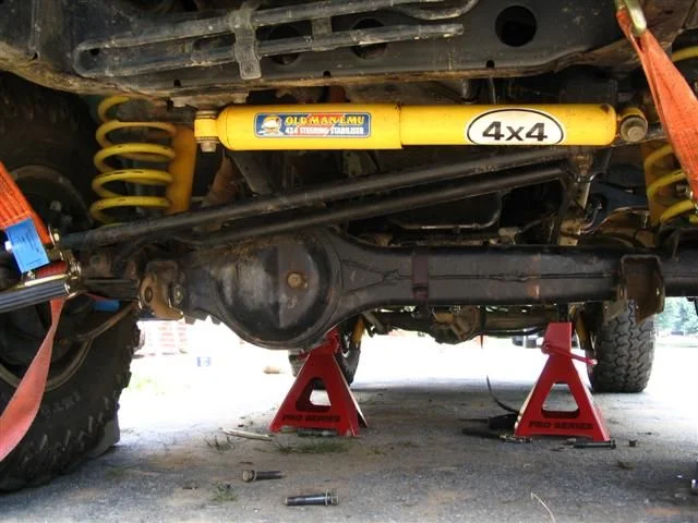

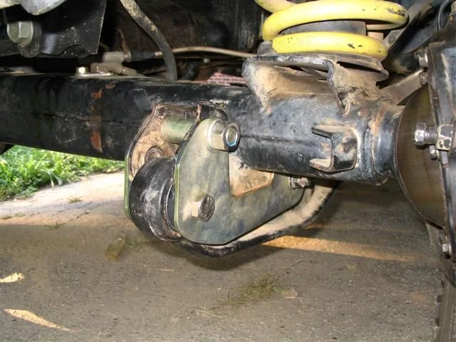

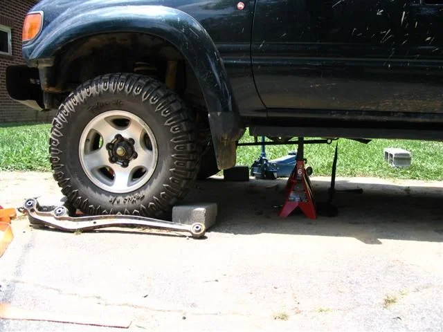

Couple of shots showing the castor plate install:

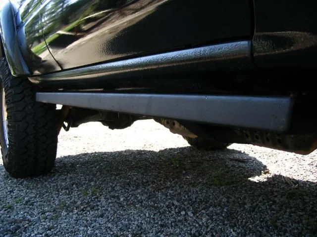

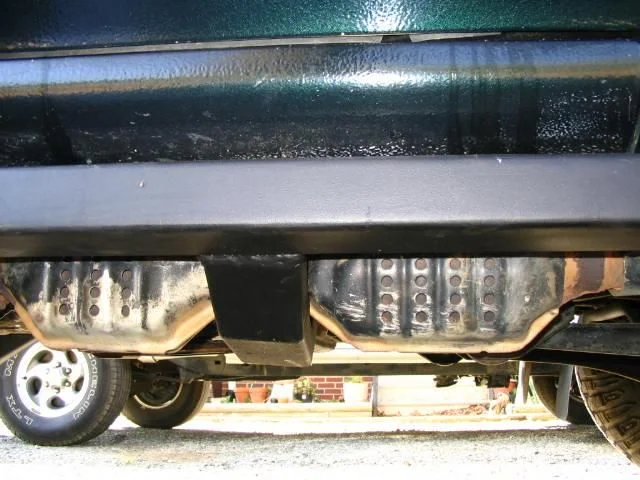

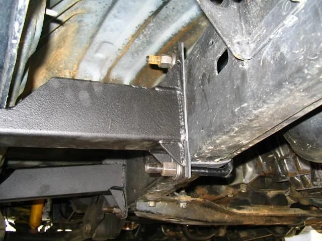

Couple of pics of the sliders. I plan on adding an outter hoop some time soon to the slider.

4x4... sticker

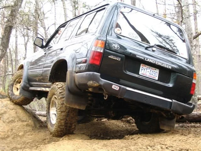

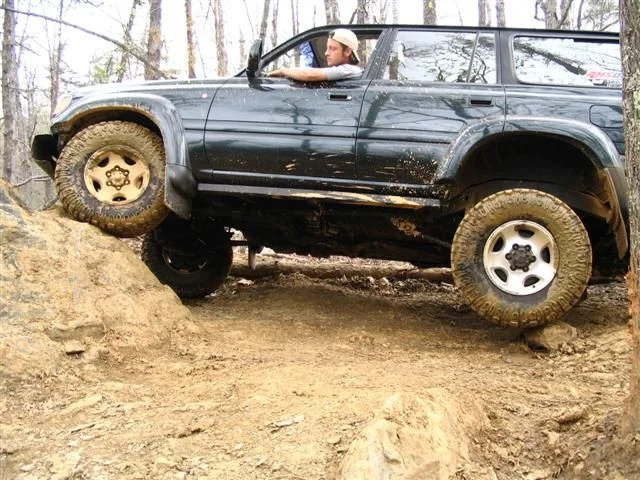

couple poser shots.

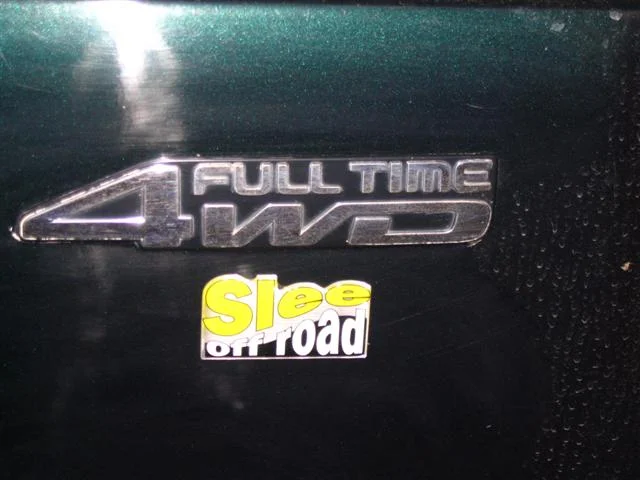

Quote:
Originally Posted by Junk
4x4... sticker
I almost totally forgot about that damn thing......first and last 4x4mistake.com i made.
Here, i balanced the bad out with good.

Nice rig. What made you decide to do the Castor plates with only a 2.5" lift?

Hey your medium OME lift springs are yellow, did you painted them or do they come from the manufacturer in yellow? I thought springs are painted black. Nice looking rig though.

Did you paint the spring yellow, or did they come that way?

Arn't everybody's OME springs yellow?????

Because the CC bushings (and they were installed properly ) brought my caster to zero degrees according to the dealer's alignment machine. She was wandering all over the road.

I painted the springs yellow to go with the OME theme. I guess i had a little extra time on my hands.

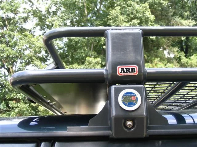

Quote:
Originally Posted by PKP80

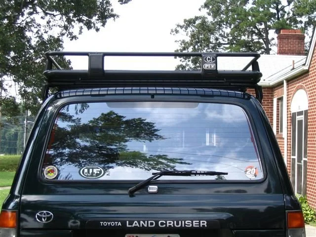

HOw about a few pics of the roof rack.
-Sam-
Ask and ye shall receive.

Any wind noise from that rack?

Quote:
Only with the sunroof open. Honestly, the rack basically makes the sunroof non-usable because the wind noise is so loud. That's why during the warm months, if i know i'm not going to be using it any time soon, i'll take it off so i can enjoy the sunroof.

Mine were plain old black. yellow would be cool though.

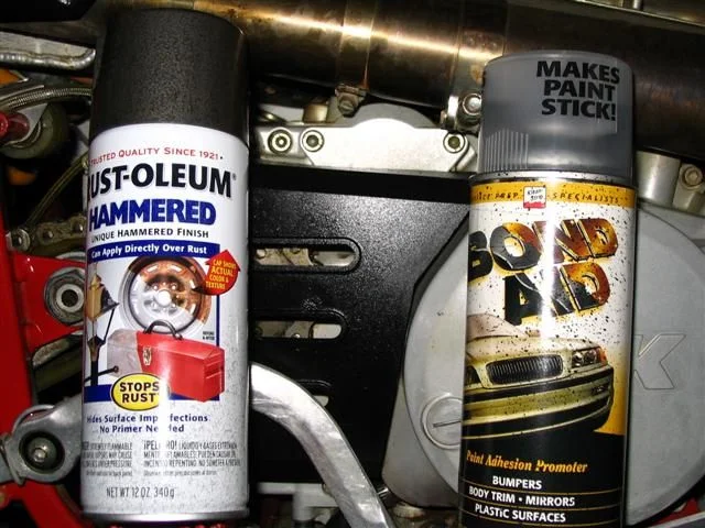

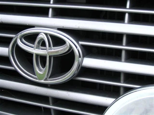

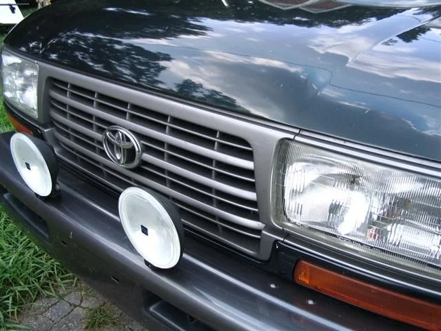

I almost forgot, i anti-blinged my front grill using hammer silver spray paint.

What are your castor measurements now after the Slee plates? I had the same situation with my OME bushings (brought castor to .1 and 0). I am thinking about going this route.

I haven't measured yet. I was wondering the same thing. The truck tracks much better now, and under braking tracks straight as opposed to wandering left to right before the plates. The steering is also much heavier feeling now. If i gave an estimate it would just be a guess.
Hey, what kind of lights are those on your front bumper. i have been looking for a shallow light to put up there.
Thanks

livelarg, they are hella's, can't remember the part # but they are the cheapy ones.

Arent they hella 500's

so you used hammer silver paint? Does the finish not rub off like the metalic paints?

Quote:
If you have a NTB near by they will for FREE measure your front end alignment.
I didn't know about NTB offering free alignments. I'll check into that.
For the grill i first used a 3m pad and ruffed it up a little, cleaned it, sprayed it with bond aid, and then the hammered paint pictured below.
I do believe the lights are Hella 500s.

That "hammered" paint is cool. I used it on the springs of my Jetta.
