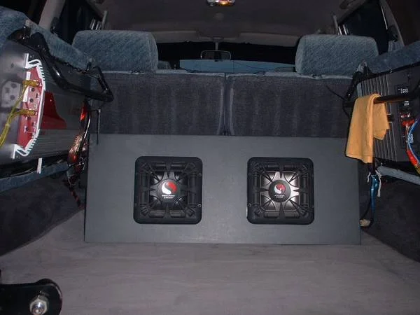

This is how one of the local 80 owner's mounted his subs. Not exactly stealth. But I'm pretty sure it has enough SPL to satisfy most people.
The amps were mounted on the underside of the troop carrier seats.

Yeah. Definitely not stealth. I'm sure it really cranks.
Everyone's got different needs for their cargo area. I still want to be able to chuck firewood/rocks/tools/muddy boots/snowy boots/coolers/toddlers in the back without worrying about poking a hole in my woofer or shorting my amp.
So I opted for stealth and zero cargo area loss. Even if it looks a wee bit ghetto.

Hayes nothing ghetto about your set up its called functional and I think its perfect.
When I go to put my nak 8" in thats how I'm doing it.
