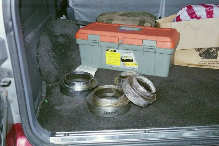

Old 07-26-05, 08:45 AM   #8
IH8MUD Lifer
Join Date: Jan 2005
Location: Philippines
Posts: 1,031
Finally !
Now I see where those things fit. The only type of ring spacer I'm familiar with are the attached.
Kalawang
__________________
LC80 Full time AWD
1HD-T 1990 model
4" Lift 33" Yoko Geo MT
Airtec Snorkel
Bullbar 9,000 Warn
PIAA CDL
Kalawang is offline   Reply With Quote
