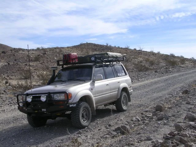

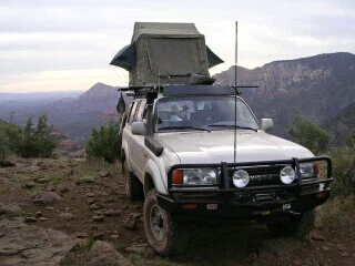

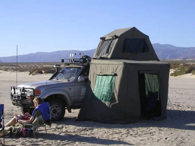

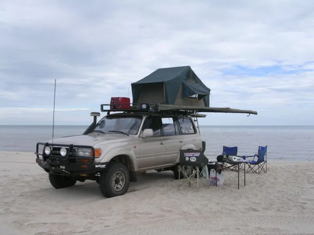

1992 FJ80, 3FE 200,000 miles, all OEM parts from CDan
Built for travel/expedition wheeling
OME 850 front/863 rear Heavy Suspension/OME N71e(front) N73(rear) Shocks
OME Steering Stabilizer
31x10.5R15 BFG Mud Terrain Tires on Stock Alloy Rims
2 Spare 31x10.5R15 BFG Mud Terrains on Stock Alloy Rims
ARB Bumper with Ramsey Rep 8K Winch
PIAA 120 XT Spotlights
Safari Snorkle with Centrifugal pre-cleaner
Factory Toyota Side Marker Lights

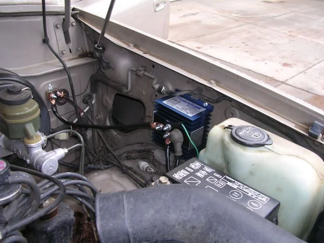

Optima Red Top Main Battery
Battery Isolator
Remote Located Optima Blue Top Marine Battery
Con-Fer Porthole Rack, 5'x8', modified to fit rooftop tent
Expedition Exchange twin NATO can holder (On roofrack)
Hannibal Rooftop Tent
Hannibal Awning with side enclosure
Engel 35 Refrigerator
Constant 12V outlet on center console
A-Pillar GPS mount for the trusty Magellan 4000XL
Rear Cargo Floor with tie down rails
Pioneer CD/MP3 player with XM Roady Receiver
Pioneer Speakers in Stock Locations, 10" Subwoofer in rear
George’s LEDs lighting
El Cheapo Radio Shack CB, Firestick antenna on ARB with quick release
Future mods...
1HD-T Turbo Diesel, A442 Trans and T-Case....Gotta get Greg & Sheldon to return the ‘ol emails!!!

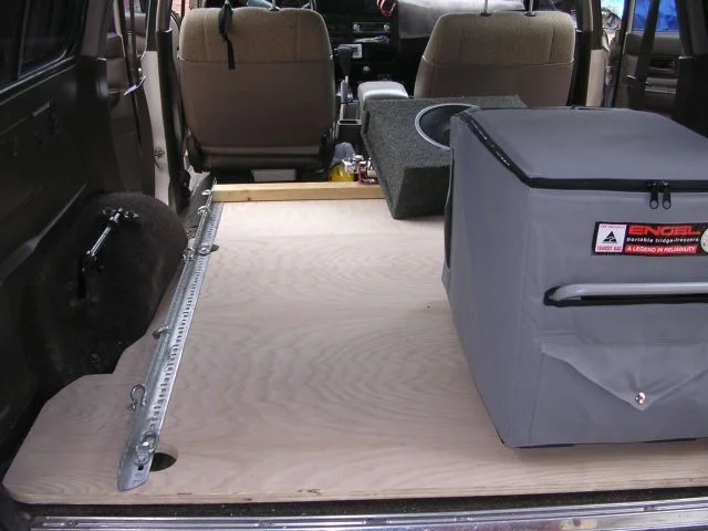

Rear Cargo Rails (With rear seats out)

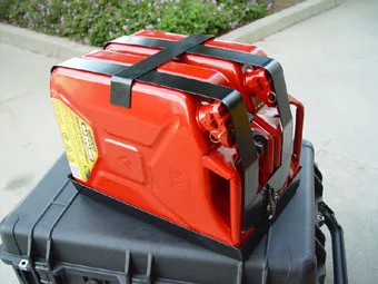

Dual NATO can carrier

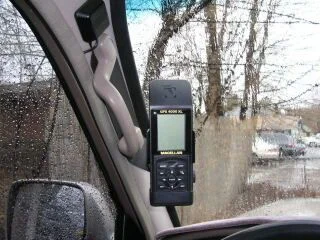

GPS Mount on A-Pillar

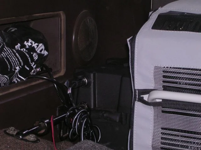

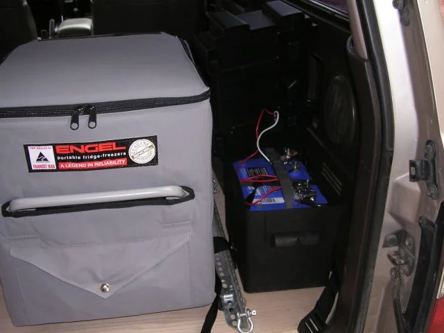

Rear Battery Box & Fridge

Very nicely equiped rig, I love the rear battery.

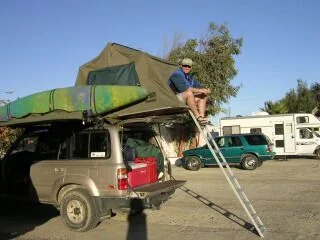

I love the tent...I was lucky that Junk happened to get a new trailer and his wife wanted more room in the garage, so I picked it up from him. Same with the awning.
Most of the wheeling I do really doesn't require tires larger than 31", and the 3FE is already a slowpoke without adding extra tire to turn, so I've stuck with 31s.
Because of the 3FE and power considerations, I've not added the extra weight of sliders or a rear bumper. One spare tire is in the stock location, and the other is on the roof rack when necessary.
Here's a ladder access pic....

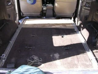

More details on your cargo tiedown rails?

The cargo rails are 6' sections of perforated galvanized angle from the 'ol Home Depot. I've bolted them down to the floor through a 3/4" plywood section to the factory tie down captured nuts and added small shackles which can move to where I need to strap stuff down.
For trips, my gear is contained in Rubbermaid Boxes, and strapped down using ratchet straps...no bouncing or clanging around in the back!

Nice! I like that it's infinitely adj for different tiedown positions.

Awesome rig, the GPS mount is real clean, nice.

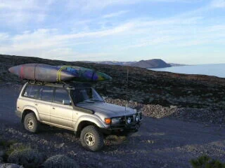

Nice setup.. and looking at the pic in post #12... there really is ocean front property in Arizona
Also looks like it came right out of the ocean from OZ. (Doesn't look like any tire tracks in the sand infront of the truck)
One questions though... is that the GPS antenna right above the drivers "o'shit" grip? If so you aren't getting the most out of the signal.. that should be facing straight up for the best quality signal. Most likely not a major problem since you don't really need such precision, but in times of low signal it would help more facing directly towards the sky.

The Pelican case is from stock photos at www.expeditionexchange.com , it's a Rover oriented website, but the dealings I've had with them have been top notch, and the dual can carrier is very well designed.
Overall, the Pelican cases are great! I've got one mounted on the back of my motorcycle for secure storage of the Sat phone and papers on trips.

I'll have to get a close up pic of how I've attached the awning....it's simple, yet complicated to explain....
San Felipe is nice, Mariscos Conchita has some great food, and cheap too!
This was taken on the way to Bahia San Luis Gonzaga south of Puertocitos, and on the beach at sunrise!
Viva Mexico!

Finally a rig with the 3FE powa . Very very nice rig, How do you setup the remote battery? Can you do dual batteries in a 3FE without the remote location?

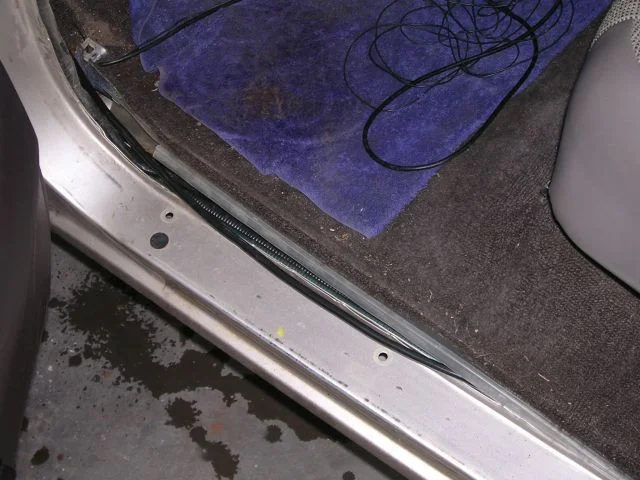

There are several of my previous Baja trips in the Trails/Events/Expeditions section here on mud, as well as a short write up on my most recent (June '05) motorcycle trip. In the Outfitting section we had a thread going on equipment lists, and I've put both my Cruiser lists and motorcycle lists up there.
I couldn't really find a good place under the hood to put the second battery. I even looked at the new Optimas for hondas, which are about 1/2 the size of a regular one, but the Amp/Hours are less, so I went with the remote location in the rear.
My isolator is located on the USDS left engine bay, and I've run 4 guage battery cable down the rocker panel and over to the battery in the USPS rear cargo area. The battery is grounded to the body in the rear.
