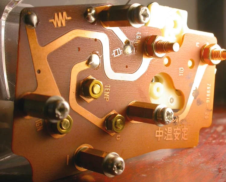

Great work. Your results seem to be correct and it looks like there may be a major difference between 93/94 and 95-97 gauge flatspots. Landtank had the AC cut out on his 97 (226 degrees) with the gauge still looking normal. AC Cutting Out-- Long (post #6)
If I read you right then the gauge on a 95-97 is steady at 170 to 230 when it first moves and 260 when it first hits red?
Dan's 1993 was steady at 140 to 215/8 degrees on his truck, and was only at 223/5 at 3/4 on the gauge dial. I don't think any mod to Dan's truck including the low t-stat would impact on his gauge response. Perhaps his Isspro gauge is calibrated low or is in a location where it sees lower temps but I doubt either could explain that kind of swing.
I also notice the "dead" range is different. Dan has a 75 degree range, while you are finding a 60 degree range, so this would also support a different gauge response unless I am forgetting ohms law or something.
If all this is right then maybe that's why later models tend to blow head gaskets more often since you are in big trouble if the gauge ever moves at all .
If the gauges are different then it may be a crapshoot whether the same mod will work for both gauges but it may just be a matter of a different diode and resister on two identical parts, in which case we might be in luck.

1. Yes the flat spot is caused by the Zener diode. we will be removing it and I think replacing it with a resistor, you could replace it with just a wire and have still have a linear gauge, I was originally thinking this would lead to too small of a range but running the #'s just a wire might be about right.
That would be too easy
2. R2 you got it , one addition, the forward volt drop is a thing of all diodes, in order to perform their electronic check valve function they take a tax of dropping a certain voltage, silicon and germanium diodes drop different amounts but I cant remember witch is witch. Maybe .7v is silicon?
3. I have briefly considered this but I think I want to see all changes/trends however small. It could be done though I am not sure it would be as tight as you are looking for, we already have a forward volt drop that cannot be gotten around and adds to the reverse volt drop, so even a very low value Zener Diode might have a considerable dead zone. I will try to figure that one out at least on paper
Quote:
Originally Posted by semlin
Raventai
Good to know, I was worried about the difference, but I am not going to call the results 100% accurate just yet because of the voltage.
Yep, also 145F° was just above the cold line,
Yep Dans readings of gauge vs gauge are still valid, only thing that is not comparable to stockers is what temperature he is running.
I am defining the dead band by watching the voltage across the windings, finding the dead band by watching the needle (waiting to actual movement instead of start of voltage change) may be enough explanation of the 15° difference in range but not the different temps the range happen at.
After we get the mod someone will need to open up a 93/94 and see what is there, the thermistor is the same, if the air core motor is the same then the mod will still work. As the rest will be replaced.

It is interesting you mention this, the gauge in my 96 LX “centers” dead middle of the gauge wile driving, the test gauge appears to be maybe half a needle width low when centered, may be parallax error as the needle is pretty high off the card. But no matter center is easy to find electrically, it is when there is no current in the inductor L1 shown in the schematics in post # 58, when there is no current passing through L1 there is no volt drop across it and the needle centers. This would be whatever position you see when normally driving after warm up but before overheat.
Quote:
-if so, that means with a 75 watt resister there is 30 degrees F of swing between standard position and the beginning of red?
-am i also correct that the gauge response is linear? If so, at what temperature does the gauge first move, because I assume that 170 minus that number gives 50% of the full "range" of swing (or did you alreayd test how hot it would go before you buried the needle?)
-does that amount of swing remain fixed no matter what resister you use?
Well first off after removing the diode there are two adjusts that can be made,
The 75 ohm resistor does not effect swing per say, this resistor affects the balance point or basically at what temperature the gauge “centers”.. The 75 ohm resistor and the thermistor create a variable voltage between them. These two resistors form the raw data of temperature. The rest of the circuit reads and displays this data. One thing to note, we will not lower the value of the 75 ohm resistor, only raise it. The lower the resistance of this pair the higher the current, already when reading higher temperatures the 75 ohm resistor gets quite hot, have no idea how much overhead there is for higher current in the circuit so only safe path is equal or lower current than stock. Fortunately going to a higher resistance move the center temperature lower, I don’t think anybody wants center higher than 212 so we are in luck.
Also may have found a way to tell if a truck has ever been overheated, more on that later.
The second adjustment is the resistor that replaces the diode, this adjusts how sensitive the needle is, lower resistance make for more needle swing per degree or a tighter range, higher resistance less swing per degree or a wider range.
So the gauge is completely adjustable within limits.
The variable voltage produced between the 75 ohm resistor and the thermistor is linear up to about 245°
Where it starts leveling off.
I guess eventually response would end but that point is above the boiling point of coolant so no worries. I do not know if the gauge will response will be linear or not as I was mainly watching the circuit electrically on the first cook, but for now it looks promising. It is harder to accurately measure needle movement than temperature and voltage. I think photography will help here, need to change up the test bed some.

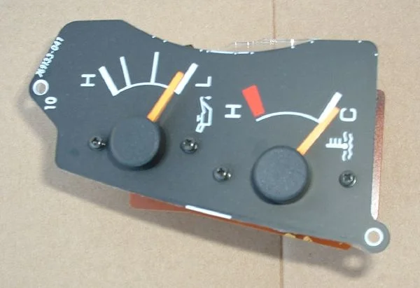

mine is definitely a tad below centre and that's the way I've always heard it described. It could be the combination of the angle I am looking at it when driving and the distortion caused by the raised needle from the gauge.
that raises the interesting question of whether what you see as the red line in the test is the same as it will appear in the dash. I think you may want to verify your observations from a simulated driver's eye view, although that would, if anything, mean you have so far understated the temperature at which you hit red!!
if you can vary the swing then I am ok with a 200 degree centre point. I was worried that would yield a 230 degree red line which is too high imho. If you can tweak it with enough precision to ensure 225 or so is the red line then 200 is fine.
We talked about making an overlay for the gauge card with a couple more increments. it looks like it would be impossible to remove the needle so as to accurately scan the gauge so we will need to figure out what the radius is of the circle. with that info I can try to get started on putting together the overlay. If I know what the target swing and centre point will be then I can aim for a mark at say 217 degrees for a yellow line, and 200 for a white line.

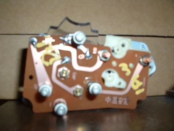

I am also going to start looking around for a 93-94 gauge.

ok raventai I have an official 93 factory temp gauge. unfortunately my digital camera is horrible at close ups. I think you can see enough to ask questions.
in the mean time I'll se about shipping it off to you...

using your 1997 gauge photo (attached) as a reference the back panel in virtually identical.. difference are
1. pn# at top is 769902-961 on mine, looks like 769916-920 on yours
2. third kanji script down, the box on the left looks like it has an H or M in the middle where you have two straight vertical lines. otherwise all the exact same script.
3.at the bottom where you have an "IGN" labelled bass nut, I have one of my 4 raised mounting points still labelled "ign". Where you have the post just below, I have nothing and the circuit board copper does not branch out.
4 the two upper mounting posts on mine have round brass bushings unlike the other two posts which have the same hexagonal style as yours.
