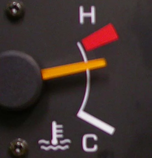

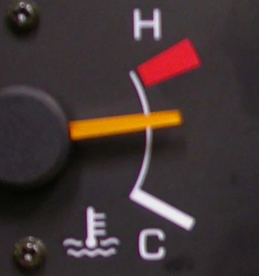

so raven, did you by any chance take photos of the 93 gauge?
with the 93 test gauge in my truck I am running a temp similar to these two. taking into account parralax it is probably closer to the lower one which i think you said is 198 on the 97 gauge. whatever it is it is noticably higher than the neutral line on my old gauge because the truck will initially warm up to a line that is already higher than my old centre line and then move up again to this one after about 10 minutes.
the other interesting thing is that the gauge is much slower to respond from cold. my heater now blows hot well before the gauge crosses the bottom line. with the old gauge it would not do so until it was most of the way to the centre line.
truck just had a flush, new oem t-stat all new hoses and a new fan clutch because of the h/g job. I am wondering whether I need to add a new rad to my list to try to address this running temp.

Semlin the upper one is about 200, the lower about 194, warm but not hot,
I have a full series of pics of the 93 guage both before and after mod, about 427MB I would be glad to send them to you just need to figure out what kind of client you want to use to make the transfer, you do have broadband correct?
Like R2 said the cold line has changed, on the 93 stock the cold line was about 130, after mod it is about 155
