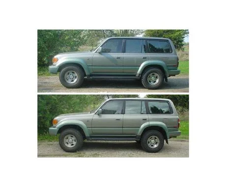

Pic of my rig in it's current state.

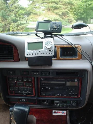

View of GPS, XM radio and CB set up.

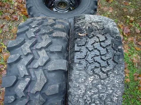

Pic of Super Swamper LTB tread versus BFG All-Terrain KO.

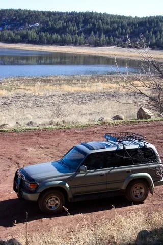

Pic of Yakima Loadwarrior without extension on truck.

Very nice rig, tell me more about the Yakima load bars. Did you replace your factory roof rack and add this setup. Been looking into something like this.

hey fochdog, cool ride.... can i see a picture of the cb in the ashtray area?

I was lucky enough (in my opinion) to get my truck without factory roof racks. This is good news for me since living in Michigan with a former Arizona truck I am fighting rust and corrosion all the time. From other posts it seems the factory roof rack mounts are a known area for rust to start. Plus, I leave my Yakima rack off most of the time unless I need it and I like the clean look of the truck with no rack.
I have the Yakima 1A Raingutter towers (Yakima #00101) which clamp directly to the rain gutters on the truck. This is a very strong attachment.
If you have the factory roof rack you can go with the Yakima Lowrider (Yakima #00118). I have a set for my wife's car and they work well also.

My second pic shows the CB in the lower right of the shot. I will try to get a better picture. The cool thing about the Radio Shack CB is that it seems shorter then the popular Cobra mini units. I did not have to adjust the antenna connector on the back of the unit to fit it flush with the front of the dash. Christo Slee details this on his web site, but is unnecessary with the Radio Shack model.
I almost went with the Cobra all-in-handset model, but the Radio Shack Mini was almost $100 cheaper when on sale.

just dont loose the hand mic for the radio shack one. I had mine stolen and cant find a new one for the life of me. any one have any ideas? its not the normal cb mic and radio shack doesnt sell just the mic.

nice rig. are the ATs slightly higher than the swampers? I have a photo somewhere of my ats completely packed with mud and grass after driving through a wet cow pasture. instantly teaches you the value of mud tires.

Both the BFG and Interco web sites put their tires at 32.8" OD. From my measurements this looks to be true.
I had enough experience in Michigan goop that I wanted more then an AT tire. I found mostly good reviews about the LTB and it is cheap compared to other Mudders ... less than $130 each.

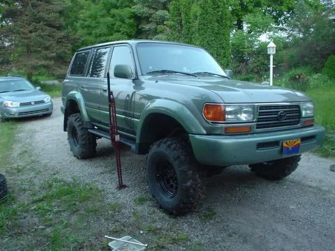

A cool shot of my rig during a tire swap. You're not gonna' do that with running boards!
