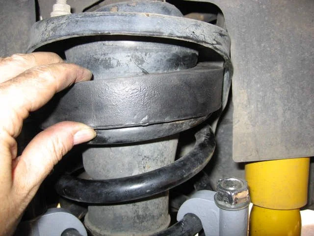

My rig was raking to the front with the weight of the winch and ARB. I originally was thinking of switching to Heavy springs. But discovered there was no need per the following thread in the FAQ:
http://forum.ih8mud.com/80-series-tech/44674-dont-swap-med-heavy-oem-springs.html
So I bought some 1” Mr Gasket Spacers from www.summitracing.com Part number MRG-1285.

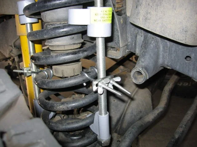

I also bought a Coil spring Compressor from Harbor Freight for $12.
Tools: 15/16 Socket (24mm works) Socket Wrench, Floor Jack

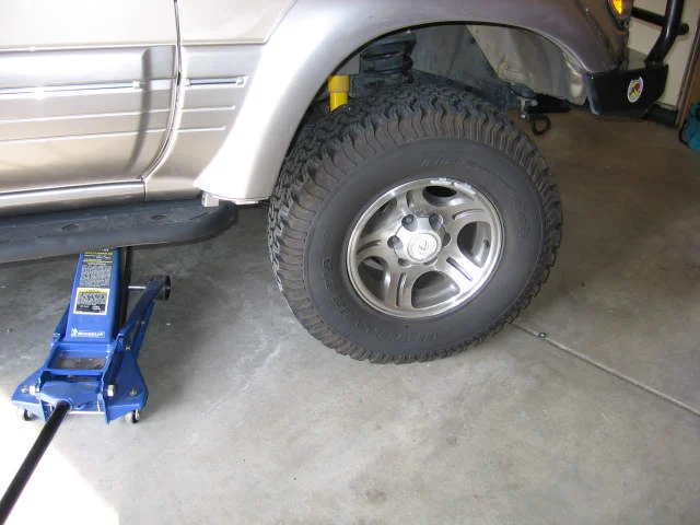

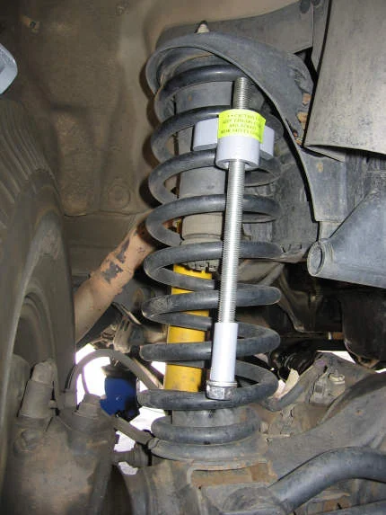

First, Place the Jack under the frame (not axle). I used the Sway bar mount. If you do the axle, you will compress the spring rather than expand it. Make sure you put a block behind the rear tire.
Jack up the vehicle just enough so you can get the Coil Spring Compressor on both sides. Learned it was easier to place the nut at the top after the first spring.

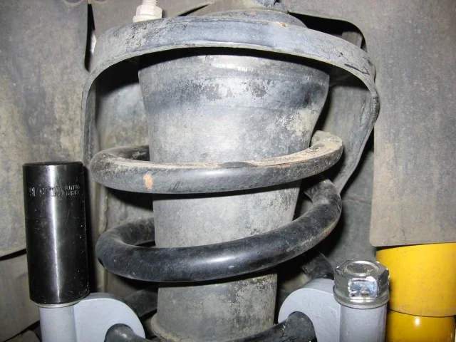

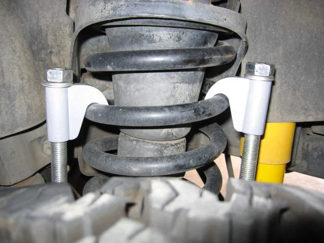

Crank the bolts alternating sides until you compress the spring a bit. Now Jack up the vehicle more and the spring should pop out of the top. Then use the nuts to compress the spring more until you have about a 2 inch gap Use the jack a bit more if it helps.

Work the spacer in back and forth until it is all the way around and seated properly. Make sure you check around the back side for proper seating.
Let off on the Jack a bit to get it pushed in and check the seating.
Let the Jack down most of the way. If you let it down all the way, the coils will compress to the point you can’t get the compressors off.
Take off the compressors and do the other side.

I have spacers on my rear and the springs had to be removed to fit them.
Are these a complete circle or do they have a break in them?
Hey Ken
How much lift did you gain for these spacers?? I just installed a set and they "Squished" considerably when all of the weight was put back on them. Did you notice this?
Nice Write Up BTW
Are these spacers a soft compond as the ones I have are made of hard neoprene I think

These are soft material with a break in the middle as you can see from the photo where I was feeding it in.
The Front is still lower than the rear and I did not get one inch of lift, the Rear is still higher than the front. I'll take a pic later.

Sometimes those spring compressors fail. I'd feel better unbolting the shock and dropping the axle than depending on the spring comrpressors to keep posssion of my fingers.
Rich is offline   Reply With Quote
Thats why i did and it worked pretty good. You need big TALL jackstand though, and also have to remove the tires, undo the shocks, swaybars and be VERY careful of the front brake line at the T

Yep, most of the same steps as required to install the springs to begin with. The compressors do make for a short cut.

Cool Thread This is the same way I did my lift and the spring compressors is the best invesment for the 20 30$ you save so much time .. good to see I was knot alone in this coily situaion.. let see some pic when your done

If you notice in Post #3, there is a sfaety bracket that helps keep the compressor in place. It's not foolproof, put your Jack stand could fail while your head is under there to.
