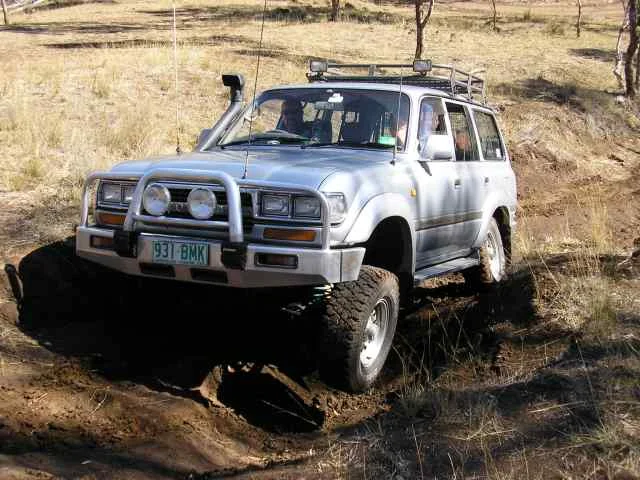

G'day all and welcome to the start of another great Cruiser week
Well this is my rig hope you enjoy it as much as I do
1991 HZJ 80 deisel 4.2 litre (1HZ)
5 speed manual transmission
334 000 km
TJM alloy bullbar with 175 narva lights 1 spread 1 spot beam
Dual batteries isolated when ignition is off and charge together when running
Glind shower
ERPS Electronic Rust Prevention System. as the name says it is an electronic systen that prevents rust by sending a current through the body panels
Check it out at www.erps.com.au
UHF and AM Uniden cbs
Pioneer cd player
Garmin GPS
Cargo barrier
Big red compreesor
40 litre Engel fridge
ARB airlocker {rear}
Air tank fitted behind bullbar runs locker and for airing up tyres
Alloy roofrack
16x7 Performance alloys
265/75/16 Cooper Discoverer STs
3 inch lift
Well that's all I can think of at the moment

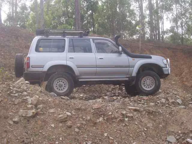

Nice ride,
You didnt mention the Snorkle in you description.
How about some more pics of the interior?
Kent

AND A SAFARI SNORKLE

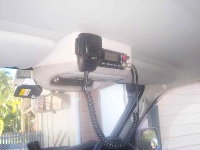

How did you mount your CB above the rear-view mirror? Is that a custom box?

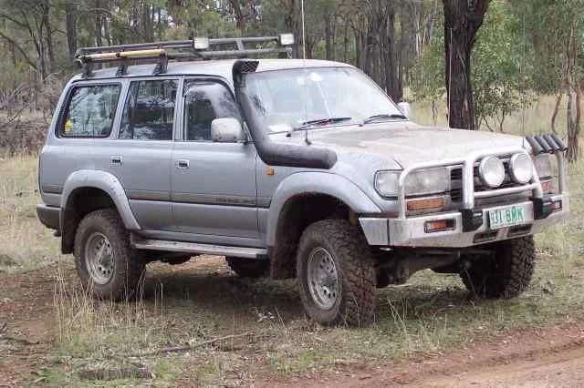

What is the purpose of the four cylinders located on the bumper on the passenger side?

I'll bet it's for holding rods during surf fishing.

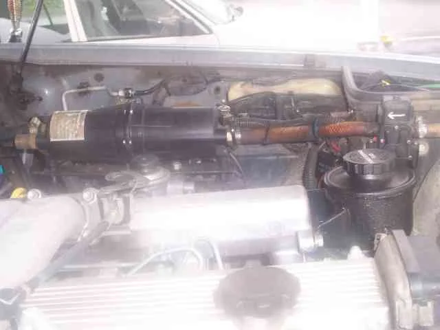

Aussie,
Tell us about your Glind Shower.
Grouseman

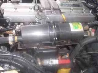

Just went out into the cold wintery rain and got a couple of pics or the Glind

The CB mount is a made by Marks 4wd Adaptors it is metal and fibreglass covered in velour www.marks4wd.com

The tubes are rod holders although rocket launchers would be handy for peak hour traffic

Thats cool.. I can't see yours but at the marks4wd site that upper console has a factory sub fuel tank guage up there. Does your have that or is it just a compass and altimeter?
Also, would that console work for 80's with a sunroof?

it looks like the glinds shower uses a heat exchanger but where do you store the h20?
i believe you need the factory altimeter option to use the marks cb extension. I also believe it works fine with a sunroof.
I have the subtank fuel gauge and the altimeter. I first fitted the CB indash below the stereo but got sick of the cord getting tangled around the gear lever.
It would have been nice to fit a full length console that goes back as far as the interior light but too many dollars for one of them
Water is stored in a 60litre tank under the camper trailer that usually gets towed on trips but I have plans to fit a tank under the back of the cruiser where the spare was. For that reason I had 15mm spacers fitted when the lift was done to accomadate the extra weight when the tank goes in.

[QUOTE=Aussie cruiser]The CB mount is a made by Marks 4wd Adaptors it is metal and fibreglass covered in velour www.marks4wd.com
Does the Sub tank guage work, come with the unit? It shows an altimiter also on Marks site, does it come with both the sub tank guage and the altimiter?
To hook up the sub tank guage, how is it done, one wire or ???
Did your cruiser come with the overhead unit or did you have to fab it in , if you had to adjust stuff to install it correctly what did you have to do?
How differant is the rear view mirror area on your truck compared to a US 80. Can this be utilized on my US rig?
I guess thats all, I really like your shower, its on the list for down the road.
Nice Rig
Steven

Quote:
Originally Posted by loquito
1 Does the Sub tank guage work, come with the unit? It shows an altimiter also on Marks site, does it come with both the sub tank guage and the altimiter?
2 To hook up the sub tank guage, how is it done, one wire or ???
3 Did your cruiser come with the overhead unit or did you have to fab it in , if you had to adjust stuff to install it correctly what did you have to do?
4 How differant is the rear view mirror area on your truck compared to a US 80. Can this be utilized on my US rig?
1 Yes the subtank gauge does work .All GXL cruisers have the sub as standard trim here. The gauge and altimeter are both factory items.
2 Going by the wiring diagram in the manual it has 2 wires
3 The console came all ready to install with the cut out for the radio. Was just a matter of fitting the radio to the bracket (pre-drilled mount either side of the radio) The original console is removed, the new one fits to the existing screw holes in the roof and the original console is the screew to the new one using the original monting screws. The hard bit is running the wires across to the A pillar. You have to send it across between the rooflining and the roof. The mirror has a spacer between it and the mount to lower the mirror so it is not blocked at all
4 From what I've seen on here with the US cruisers the console you have for the sun roof contols is the same so if you have one there should't be a problem
hope this helps

Thanks for the responce. Thats a cool set up,especially the sub tank part.
Steven

Okay please excuse my ignorance but I wish to clerify.
When you order this from Marks, does it only include the velour radio box? Or do you get the radio box as well as the plastic housing holding the light/altimiter/fuel guage?
Your responce about {The gauge and altimeter are both factory items.}
make me ask if it incudes everything. Right now I just have the light and controls for the moon roof( Like all US) When I order from Mark will I get all the parts to look like yours?
Do I need to already have the plastic housing that holds the light/altimiter/fuel guage?
Thanks for your patience
Steven

The Marks gizmo is a "spacer" only. You need the OEM over-head console to complete it. Your current overhead is much smaller and will not work.
I do very much like the idea but I wonder about all the heat that comes thru the roof on a hot summer afternoon. Two-way radios do not generally like that very much and with that set-up there is zero airflow around the radio chassis.

Thanks Dan
that was exactly what I was asking. Well at least I had a day to tell myself how nice the fuel guage would look up there
You have a real nice cruiser Aussie cruiser.
steven
