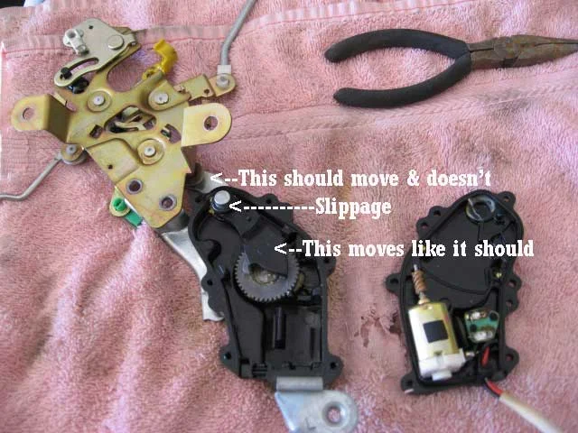

So I ripped mine apart real quick and pulled out the mess of a contraption inside the hatch with the tiny motor (that's supposed to lock and unlock...the...well..."the lock". )
Turns out that little motor inside goes clockwise and counterclockwise as it should with the touch of the remote, but the "arm junction" that it's supposed to turn one way or the other looks stripped. By "stripped" I mean, there's no threads, just a rough metal shaft that the plastic piece attaches to/around, but it's too loose and hard to tell but it might be cracked. I'm sure all the lube inside it doesn't help it stay snug either... I don't know if this would be a "superglue" or "epoxy" operation, but I'd rather not drop $150 on a new setup...
I'll post pics in the morning.
Video will follow shortly too.

Well, the black plastic piece that goes around the metal stud appears to be not cracked, but created that way. I tried superglueing it closed and it was way too tight to be able to go back on, so I popped it back how it was before.
I then used some indoor/outdoor caulking on that shaft (trying to "sticky it up") before putting the plastic piece back on, and got it all back together (I figure that piece can't be totally "fixed" and has to have some play in it.).
It appeared it was working like new again. WOOHOO!!! But wait! After just 5 or 6 times locking and unlocking it wasn't getting enough grip to work any longer...hmmm....Plan B: "Something else." ??

Nope, no more luck yet, but I haven't put much effort into it to be honest.
I just can't find a good solution other than drilling a hole through both the plastic and metal stud and securing it - with the hardest part getting it in the absolute correct position before drilling....
I've also been trying locate a used one but the only ones I can find are more money that it's worth vs. the minor inconvenience.
