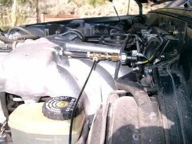

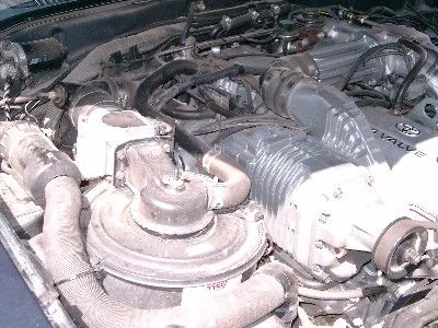

TRD supercharger w/methanol injection

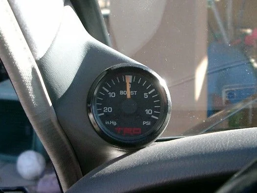

Pillar mount boost gauge

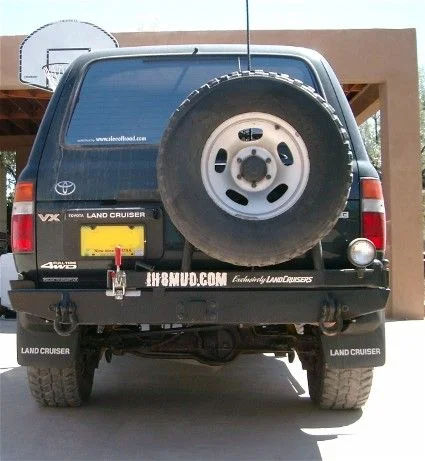

Slee rear bumper/tyre carrier
Personal design receiver hitch incorporated in Slee bumper

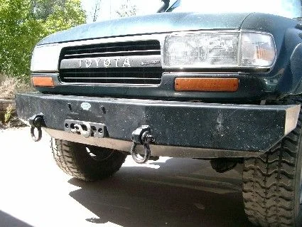

One-off Stout Equipment front bumper with hidden Warn winch (one of one built)

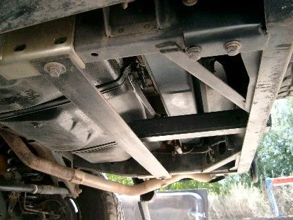

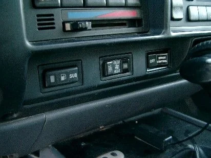

OEM OZ sub fuel tank with switchable fuel level feeds

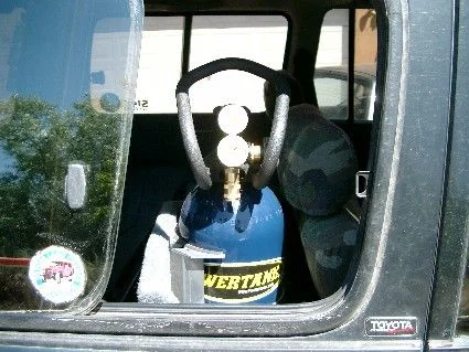

Onboard Co2 for tyre inflation and air tools

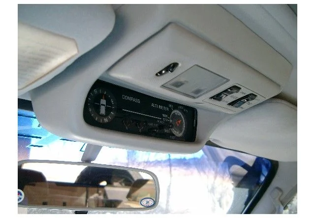

JDM overhead console with altimeter and compass

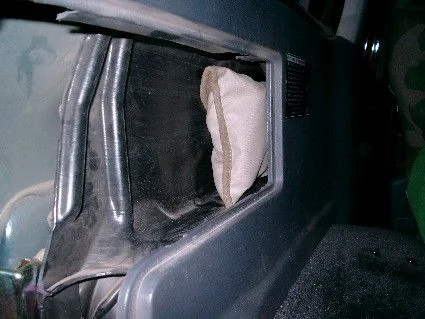

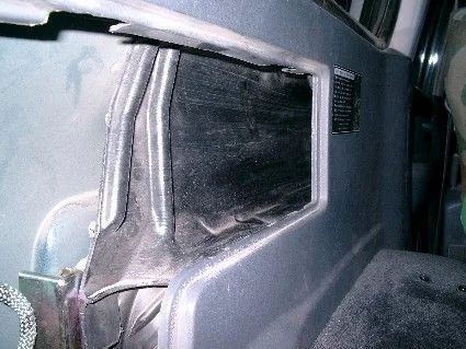

JDM tool case in LH quarter panel pocket

In-cabin winch controls in addition to the remote handle.

Damn, I like Dan JDM overhead console with altimeter and compass c'mon post'em up the pic will ya...

Lovely. Where can I get a JDM upper console w/the compass and all? What's the fuel switch you have next to the rear heater swith?

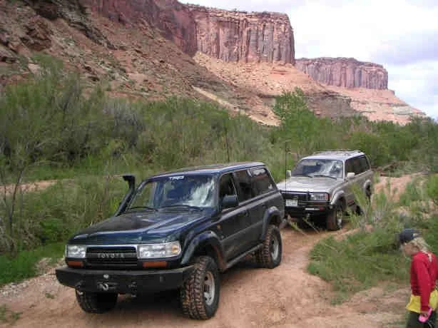

Here is another one Dan. Moab in Background mini-cruiser Dan in foreground

You don't want an upper console, they are too much money and are really more of a decoration than anything else.
The switch activates the fuel transfer system that pumps fuel from the sub into the main.

Nice rig Dan. Looks like we had the same idea for the Co2. Passenger side, used the 3rd row mountig bracket holes to mount a bracket for my Co2. Can reach all 4 tires from there.

Looks great. Figures you'd have a darn TRD boost guage I am a bit concerned though - that engine bay looks rather dirty compared to the way I figured you kept it clean enough to eat off of - maybe it's clean enough for B to eat off of and just not you
FWIW, that latch would get you a ticket in my town for obscuring the plate. <- this I know from personal experience.

Quote:
Pics please.

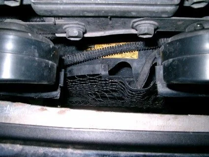

Quote:
Originally Posted by alaskacruiser
Hey CDan- can you tell us more about the "JDM aux electric cooling fan"?
It is difficult to photograph without removing the grille but it is used on vehicles with dual A/C and a cool box and it mounts to existing points on the condensor and center lock brace. I have it set up to come on manually with a switch on the instrument panel. That way I can bring it on line when ever I want. I like to be able to run it when the vehicle is being worked hard on low-speed trails.

Quote:
and I can see you intend to keep chickens out of there, too... what's with the chicken wire?

Quote:
Originally Posted by Beowulf
Pics please.
-B-
I stumbled onto this thing several years ago in my first issue microfiche. After that issue the reference was deleted. It also appears in my JDM fiche. Basicly it is a moulded plastic sleeve that occupies the space inside the LH quarter above the wheelhouse. The tool kit slides nicely inside it although I think it may not have been intended for that use.

Quote:
The wire mesh is part of the shroud. If anyone has seen the cooling fan used on 90-95 4Runners it is similar in appearance although it is a different size. The connector on the motor is the same one as used on the 90-95 4Runner and I obtained one of the same from a wrecked vehicle so that I would not have to butcher the wiring.

The middle photo in post #1 shows a lot of the hitch detail and the adjustable end of the panhard rod as well as the subtank and exhaust. There was an old thread floating around that had some drawer detail but that was a few forum changes back and the images are likely gone. I will load a couple new ones. The spares box contents vary but the full time occupants include:
