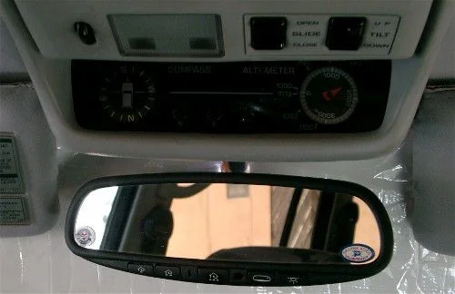

Dan, what can I say. most excellent. If Tyler sets the bar for civilized clean lean aesthetics, you set it for civilized clean and lean mods. Everything in its place and a place for everything. We need junk's rig next week for contrast
now I do have a couple of questions:
do you have a JDM bungy cord to hold your bottle jack in place as mine would never hold without the tool kit in there to tension it?
for those in a country that doesn't merit scions, what is a scion rear way mirror with 3 chanel homelink???

The jack band in my vehicle has two holes in it. The inner hole holds the jack securely in the cradle. As yours is also a 93 I would imagine it to have the same band.
The Scion mirror is an accessory. It incorporates a Homelink in it. The Homelink is a permanent mount, trainable remote transmitter. This one can store up to 3 codes for Garage door openers, electric gate openers, outdoor security lights, ETC. The three buttons on the left control the three channels. The one with the mirror icon shuts off the auto-dimming feature and the one on the right controls the LED map lights that shine out the bottom. I prefer that one to the original in the roof as it does not blind you whilst driving. Unlike the original mirror this one attaches to the windshield on a metal "button" that is glued to the glass. I used a Chrysler-style button. The overhead console covers up the otherwise ugly spot where the original mirror mounted.

Just noticed another small thing while looking at your overhead compass and altimeter (BTW which I like since my old 88 4runner had that with a clinometer) Your sun visors are different. They don't have the little "wings" pointed toward the rearview mirror. At least in the picture it doesn't look like they are there, also because they would get in the way of the overhead console. Are these JDM sun visors too?
Also, on the rearview mirror is it battery powered or is there a wire you hid well that taps into power?
