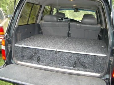

Get a drawer system from Slee.
Remove the third row seats entirely.
Remove second row when needed.
Get the extension board and wah lah queen sized sleeping area.

You don't need to remove the back seats to make a bed. Make a platform that's the right height and the extension can fit over the folded down back seats. The space below the platform can be fit with drawers for your tools and odds and ends. The platform is supported by light angle bars welded to a rectangle shape and bolted to the floor. The platform itself is made of half inch plywood covered with a rug type material and held to the rectangular support with velcro.
I have the bed described, but without the drawers. I didn't have a great deal of use for it as a bed and it served primarily to hide my small things beneath it. I've since removed it but keep it ready for times wherein I might need one on a trip. I'm 5'8" and able to lie full length on it.
BTW, by back seats, I meant the middle seats as I don't have the third row seats. I see that others have similar constructions. It's possible as a DIY.

boooyoww.....exactly the way to go. Drawer systems, extention boards ect....... too much, just take the middle row out and yer' done.
