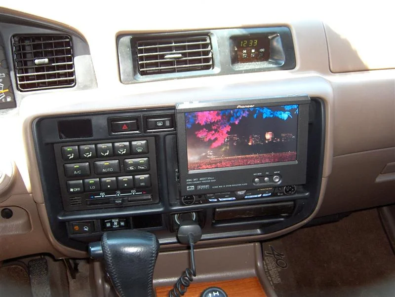

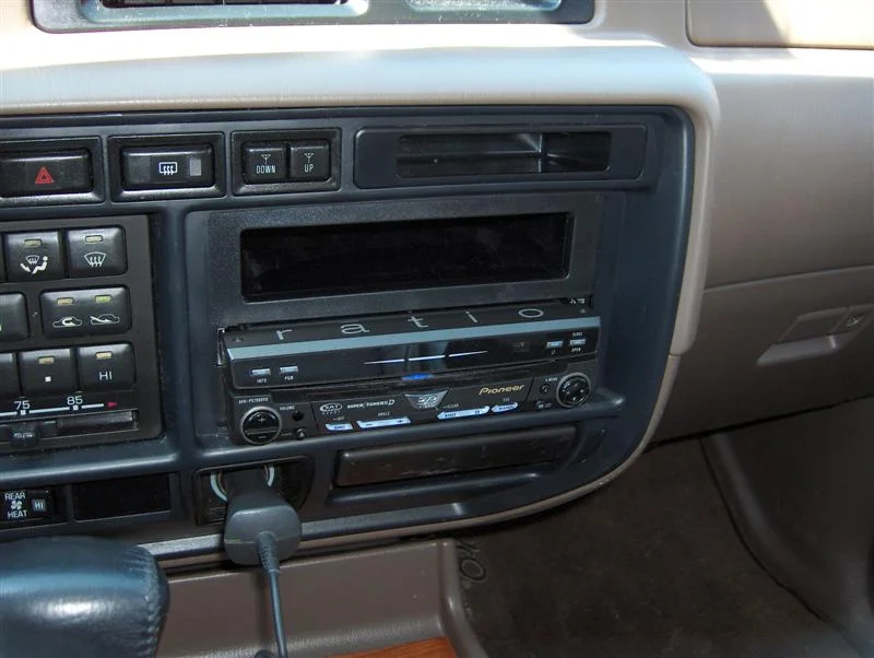

install pics
I got my deck installed a few weeks ago and figured I could post some pics. I went with this model...
http://www.pioneerelectronics.com/pn...089338,00.html
...because I got a great deal on it and will do everything I need.
It has a great picture and can be view pretty easily from either front seat with the contrast and brightness turned up.

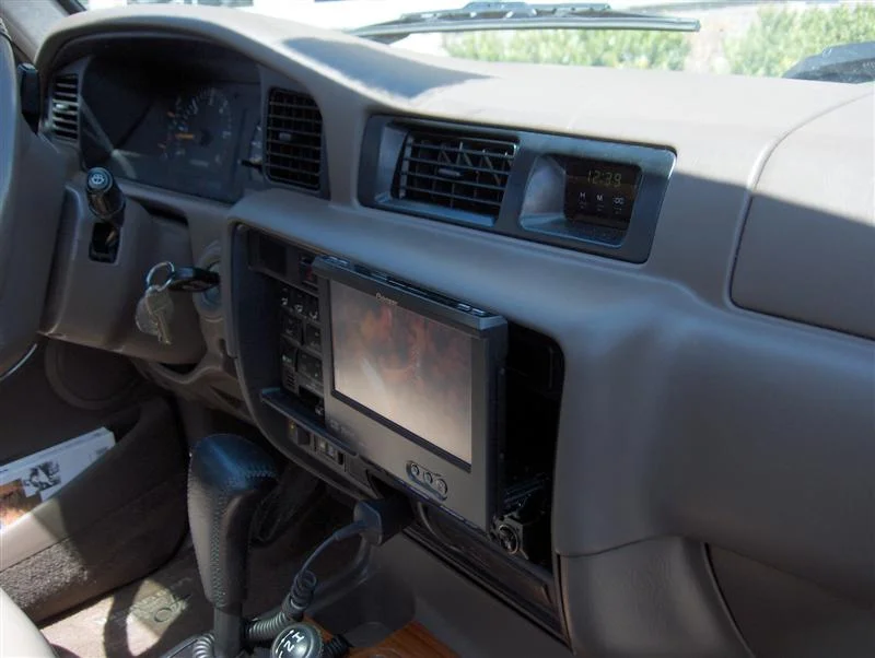

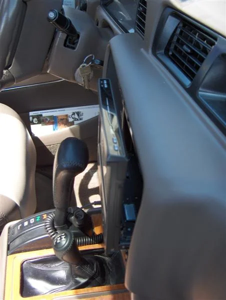

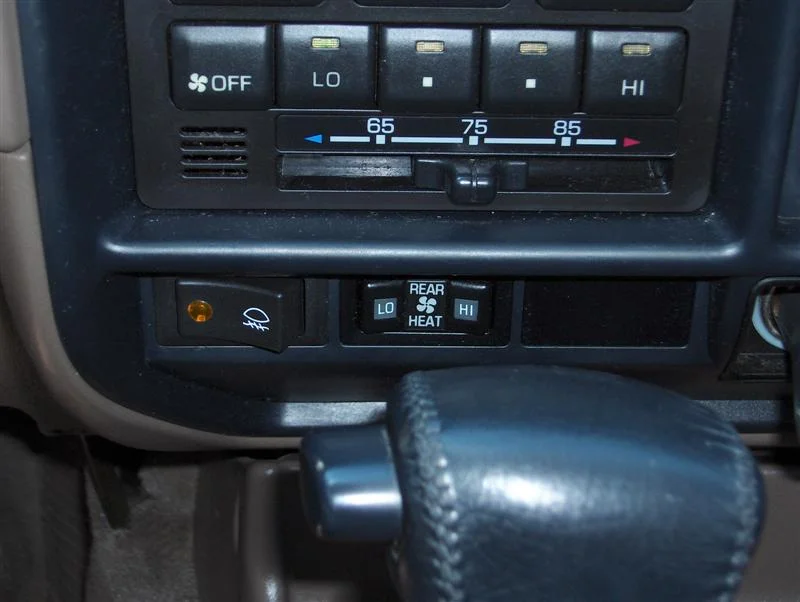

bypass swith
I had to rig up a bypass switch so I could play a dvd while driving. I used a foglight switch for a 2000 4Runner. The screen can adjust to one position beyond vertical without hitting the upper dash lip of the dash.

here's mine.
