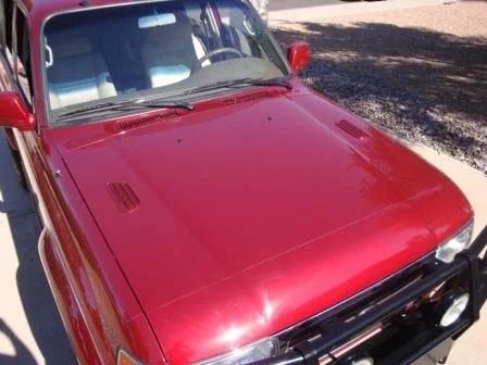

First is TreerootCo's louvers. This looks like it is fresh from the factory

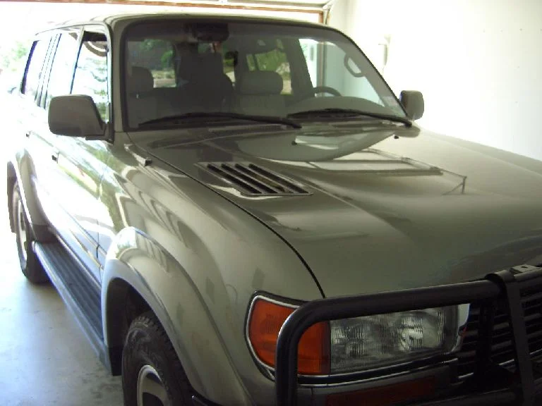

CorvetteFan did a great writeup on using Pontiac GTP Louvers.
This was based on Summitcruisers install documented in this thread

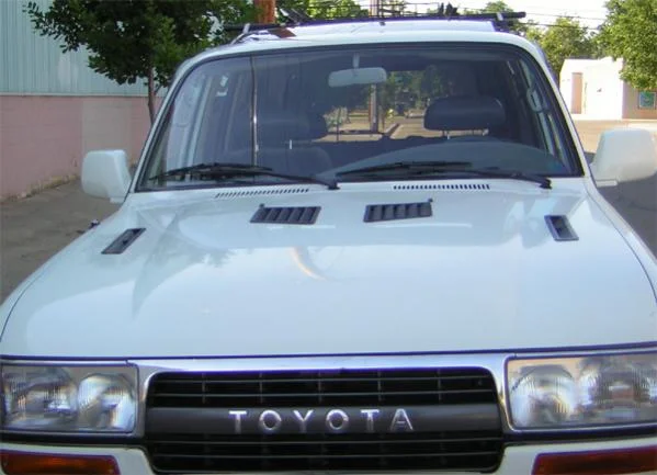

Citadel installed Chevy Lumina Z34 vents in this write-up

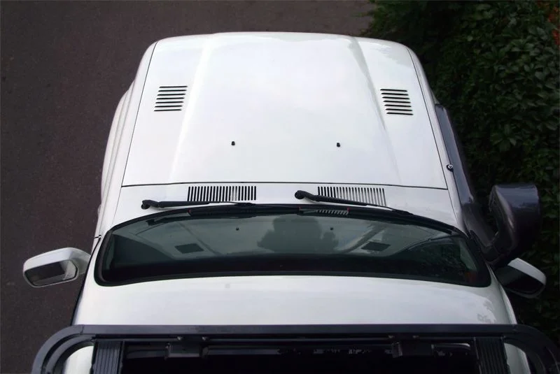

voorland80 installed a set of 4 vents in this write-up

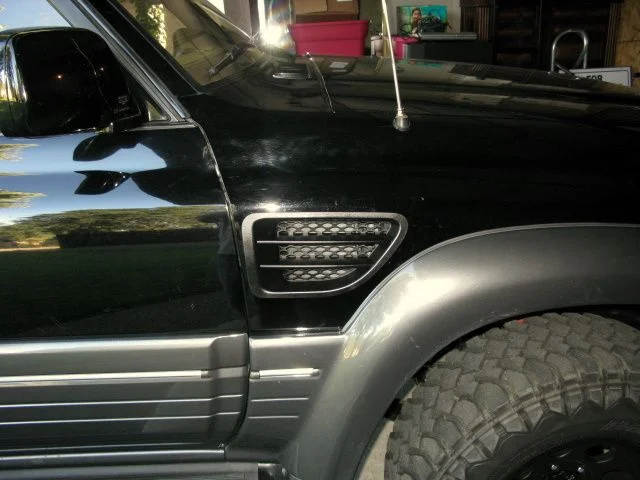

eibach1 installed side vents form a landrover in this thread
murf installed 100 series side vents in this thread. These did not require any mdification to the hood supports

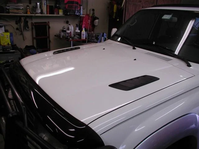

Here's my how-to thread on installing two Z34 vents:
http://forum.ih8mud.com/80-series-te...t-my-hood.html

My thread on installing FJ55 series vents.
http://forum.ih8mud.com/80-series-te...ml#post5755916
